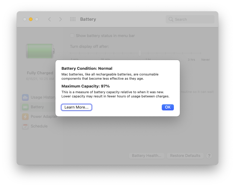

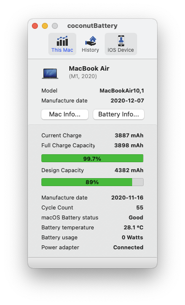

Bought my M1 Air back in December and according to coconutBattery, I'm already down to 89%, and I can indeed tell a difference in runtime when the system is disconnected from the wall. What's odd is there seems to be a discrepancy from what coconutBattery reports and what Apple shows in the Battery preferences pane, which shows 97%:

Bottom line...this doesn't seem like a normal level of depletion for a 6 month old computer. Is this something I should be taking up with Apple?
The discrepancy between CoconutBattery and macOS is weird. Would be good if more M1 folks can post their results from CB and macOS.
I doubt anything will come of it since they will say it's showing everything is normal, especially with what macOS is reporting. If I did contact them, I would probably take it in to the Genius Bar in person but I would also be prepared for some frustration so it doesn't throw me off (i.e. it may just end up being a waste of time).

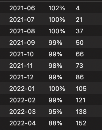

That's CoconutBattery.

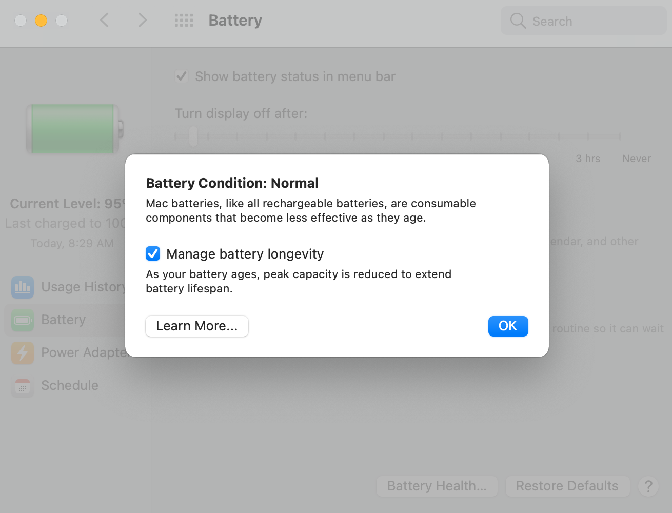

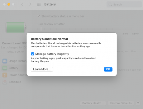

Apple's battery check reports 98%. Macbook Air M1, 8/8/1TB.
I was very pleased until February, WHEN SUDDENLY… I am more inclined to believe CoconutBattery over Apple's "Everything's Always Fine" report and this is… rapid.
(As for my other devices, my iPhone 12 keeps the battery at 101% which I am very pleased with, and the iPad 7th gen is very slowly deteriorating, right now at 95%. It's the abrupt drop 99-95-88% that concerns me regarding the Macbook Air.)
