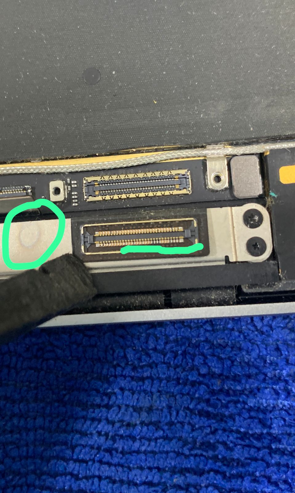

I own a MacBook Air m2 I had display flickering issue when I restart the Mac for few seconds so I took it to Apple authorised service Store they say they is liquid damaged but I’m sure I haven't spilled any liquid on it 100 percent they say that the display connector pins are shorted due to liquid damage only 3 pins and corroded them (but I see no corrosion in the picture)so they are suggesting me to replace the entire screen for 600 dollars which is like half the price of the laptop I have attached the pic of the damage in the end of the mail I kindly request you to review the damage and suggest me some solution solution
State of the MacBook perfectly fine but only flickers while I restart
I would like your response as soon as possible since I will be visiting the Apple Store within 38 hours I kindly request you to do the needful.
Since it’s an 10 core you model I suspect that it should be power over load as it take more power than the regular version but the circular does the high lighted green circle in the image indicate power over overload or overheat or liquid damage? I’m so sorry for frequently messaging since I’m so nervous and couldn’t think any thing properly.so sorry for the inconvenience caused .

I did the diagnostics it said it had some issue with the display so I took it to Apple authorised stores near by its a 10 core gpu model and I have ran heavy tasks in it it have reached temperatures of 100 degrees and above could that be the problem?

That doesn't look liquid damaged to me. That just looks like the copper layer on the PCB spans multiple pins which is a common technique if you want to shove more current up a power rail or something. The circle on the left could be anything. Copper corrosion is almost always a green-ish colour and anything aluminium would start growing oxides. That is obviously not the case here.
I would take it back, go full Karen and scream at someone loudly in the store until they realise it's going to cost them more sales than it's worth not fixing your stuff for.
From what I can see it's probably just a marginal board or screen that passed through the QA check. That does happen and they should be replacing it immediately and taking it back and doing a full engineering analysis on it and updating their QA procedures to make sure no crappy machines get through with the same issue. They don't give any of their technicians any engineering training really so they have no idea what failure modelling is. To ship stuff back to the customer and tell them it's their fault hides any IFR scenarios. Of course that's how they end up with things like the butterfly keyboard disaster - terrible quality management from retail back to engineering. Looks like they're still learning.
