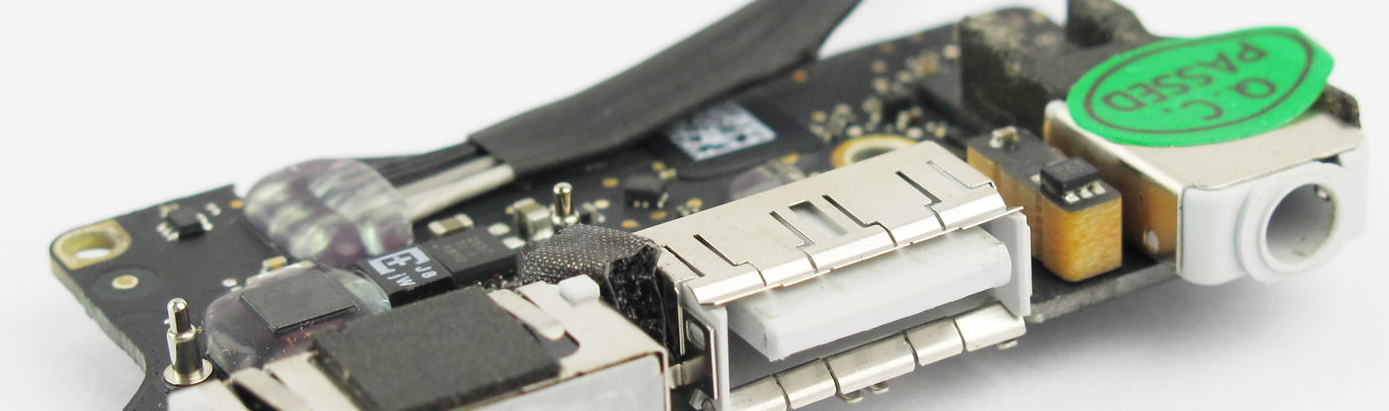

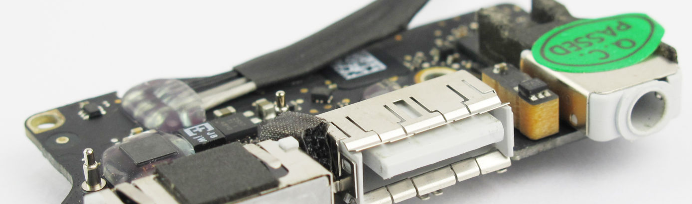

If the toothpick method doesn't fix it, you may need to replace the Magsafe board which is a pain. It's fortunate that the headphone jack is located on a separate circuit board rather than being soldered directly to the main logic board.
The replacement board can be purchased from Amazon or eBay and is not too expensive.
Before replacing the board, you may want to take it the Apple store to see if they can help.
