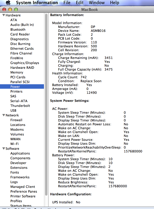

You might want to check this, if you haven't already. It'll tell you what state your battery is in.
This is the info received from the battery status, not being familiar with this DATA is it confirming positive or negative ?

I would prefer to go with GGJstudios recommendation by purchasing the original Apple battery for the macbook as opposed to replacing it and installing a third party battery. Just gives peace of mind in knowing you've got the real thing.

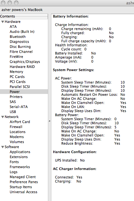

Is it still possible to purchase an internal battery for a 13-inch aluminum 2009 Macbook?
Assuming that is the new battery, it is not detected. Have you tried resetting SMC? Battery might be bad or then the battery connector in the machine is bad. I have owned Macbook and disassembled it but I cannot remember whether or not the battery connector was directly soldered to the motherboard or if it was replaceable, like it is in my Macbook Pro.
