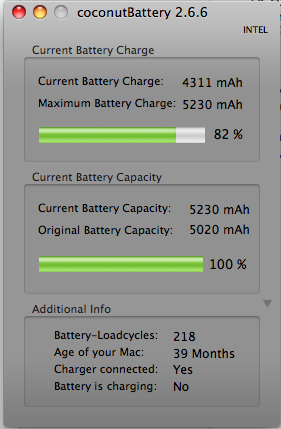

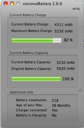

So I also noticed that battery seems to be losing charge even tho its plugged into the charger.. lol..
This is cocounuts report on the batt.
