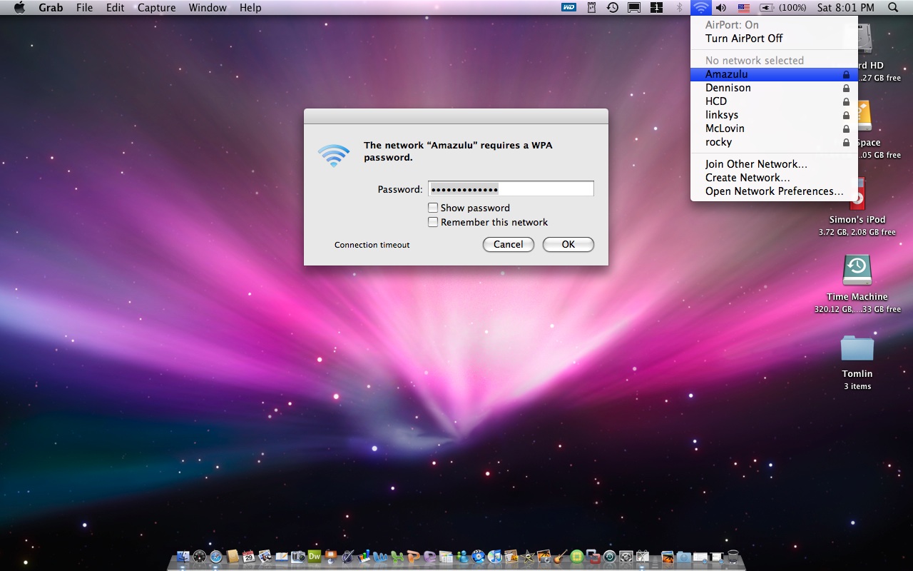

This seems to be a common problem among Macbook users. I have searched the web quite a bit and have found no real answer to this problem. Especially when I wake my Macbook from sleep, I get a connection timeout through my wireless network. Does anyone have a solution? Any help is appreciated.
Really? This is the first I have heard of this problem. Mine in connected to a network 24 hours a day, it is very rarely shutdown, it just goes to sleep, and I wake it when I need to use it. I have never encountered this problem.
Do you have other devices connecting to this wireless router?
I ask because I had this exact same problem with my MB and I have an interesting hypothesis on this, mine started after an 10.4.x update (I thought that 10.5 fixed it but found out otherwise) but I think I have finally solved it. I found that I'd be fine working until something else connected wirelessly to my router, so what I did was turned my Airport Express into an extension of my network and an individual access point that only my MB uses, it fixed the problem and my assumptions were proven correct (in my case) when I tried attaching something else wirelessly to the Airport Express and my MB immediately disconnected.
Is it ideal for everyone to set up a second wireless network? Not really but if you happen to have a AE or any other wireless router sitting around give it a shot and see if it works for you.
@Bobioden head on over to the official Apple support forum and you'll see how common this is.
yes i get it too.
In fact, sometimes I have to keep rebooting the Macbook, and after a while it'll finally connect.
Have you tried changing the channel, maybe something else is temporarily bumping you off that channel. Download iStumbler and see if you have a bunch of routers using your particular channel.
As I stated above I was having the exact same problem and it was with a D-Link.
Good Luck.
Big Problem
This seems to be a HUGE problem. I have been trying to get my wireless connection stable since I purchased the Airport Express. I finally took if out of the network loop and everything is fine. Set it up it up again and my ibook network connection drops out.
There are at least 12 forums I have visited and literally hundreds of posts and answers about this problem. Not one solution is definitive. It took my brother in law quite some time it was a DNS problem that was not allowing any connection whatsoever to the internet.
I love my Mac, it is the first one I've owned, and by this time next year there will be no more Mr Gates in my house. However I find it startling that there has been no Apple release at least acknowledging that there is a massive problem here.
Regards. Iain 🙁
Apple almost never openly acknowledges anything. They simply ignore bugs until enough people complain, and then release quiet fixes while continuing to pretend problems never existed. To the OP, try downloading the latest software updates if you haven't already. Sometimes they cause kernel panics. Sometimes they fix things.
I have done my due diligence, I believe I have all the latest updates. It is only on my home network that I am experiencing problems.
It is the only problem I have found with Apple. Oh well, I'll wait until my kernel stops panicking.
