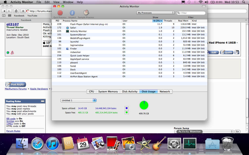

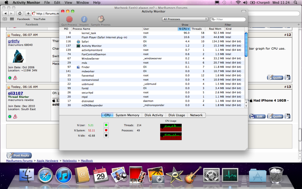

Screenshots of the usage:
When flash player is not being used:
When flash player is being used:
Thanks. The screen shot helps.
Change the pop-up Manu from "My Processes" to "All Processes", then select "CPU" tab (this will show different stats and a bar graph for CPU use.
Switching to All Processes could show other hidden system processes taking up resources.
Is "Fan Control Daemon" part of SMCFanControl? If so, have you tried lowering the minimum fans speed? (or, better yet IMO, uninstall it).
Select the System Memory tab and check fornboth Page Ins and Page Outs.
We could be following two different issues here: 1- What's causing Kernel task to work overtime, and 2- What's keeping the fan speed up.
