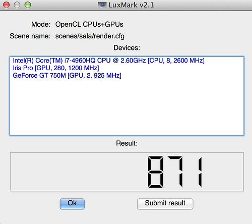

What you are seeing when playing game is an Intel Throttle state lowering the clock and voltage to cool the CPU down. This also happens when the dGPU is active because there is simply not enough power to supply both GPU and CPU under full load. When disabling turbo boost you are hurting performance greatly but also keeping the power consumption and heat from fluctuating causing more fluent frame rates. Turbo boost will kick in a lot when opening a program, loading a large webpage, extracting a file, installing a program, booting up and shutting down.. and so on. It will also stay full active even if the CPU is fully pegged on all 4 cores (if the cooling is sufficient)
This can be seen in a luxmark benchmark if you choose both GPUs, HD4000/650M and the CPU. You will get a very low scored compared to a PC with similar specs due to temp and power throttling.
In regards to heat difference with turbo boost, the cooling system may only be able to cool it properly under non turbo boost full load and the CPU is enabling turbo boost and deactivating it very rapidly causing higher temps. If performance is the same whether or not turbo boost is enabled is a major cooling system problem.
Here are a few examples.. This is with my G46VW, a 14 inch laptop with a GTX660m. It includes a 180 watt adapter and uses around 140 watts while both CPU and GPU are fully loaded.
This was taken with turbo boost disabled
This was taken with turbo boost enabled
A 2013 rMBP with a 3740QM and a 650M/HD4000 will get ~730. (my new rMBP) Those benchmarks were taken without even using any GPU and I'm only 200ish points off. That is disappointing to be honest but it's all due to thermal/power constraints. I never dipped below turbo boost even for 1 second and max temps are hovering around 83c. With just the CPU being fully loaded my wall adapter is saying I'm pulling 65 watts. If I was charging I'd go over 85watts easily. I even idle lower than a rMBP does at 9.8 watts so the laptop is super efficient.

If you didn't have heat/power throttling issues then a Mac should easily get to this score in Luxmark.. But I have yet to find a Macbook Pro (including mine) with similar specs get anywhere near this
