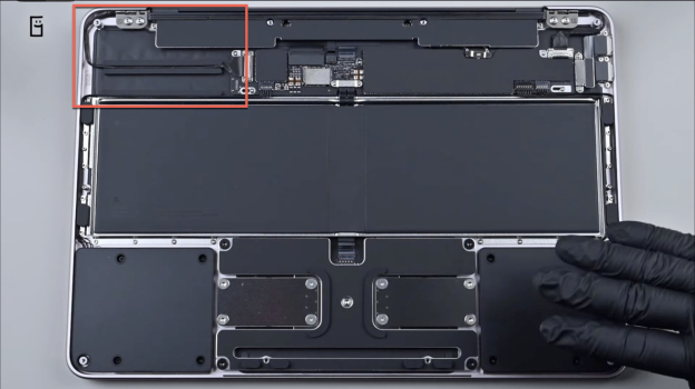

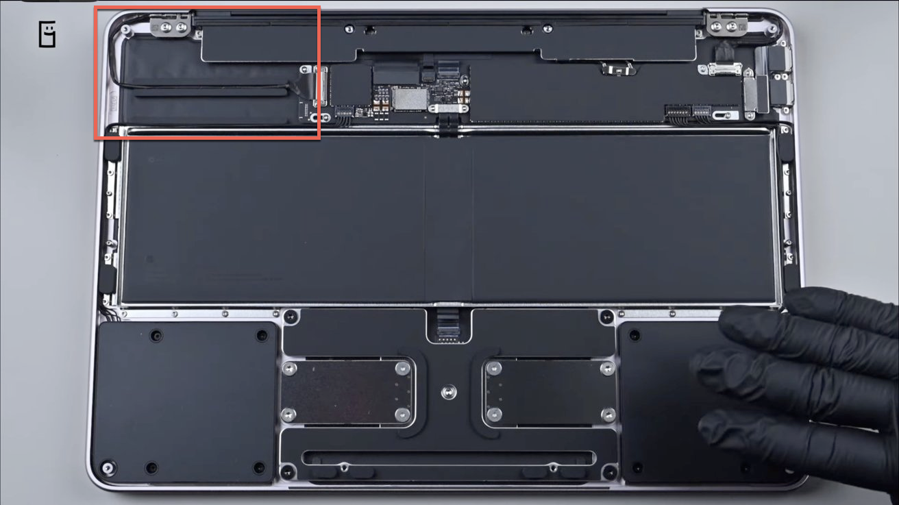

Apple deliberately didn't use a heat spreader on Neo (they use just a graphene pad). Even iPhone 16e uses a heat spreader.
One-third of the top area is left empty. There's lots of space in Neo for a heat spreader and heat sink but business reasons prevail.

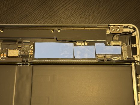

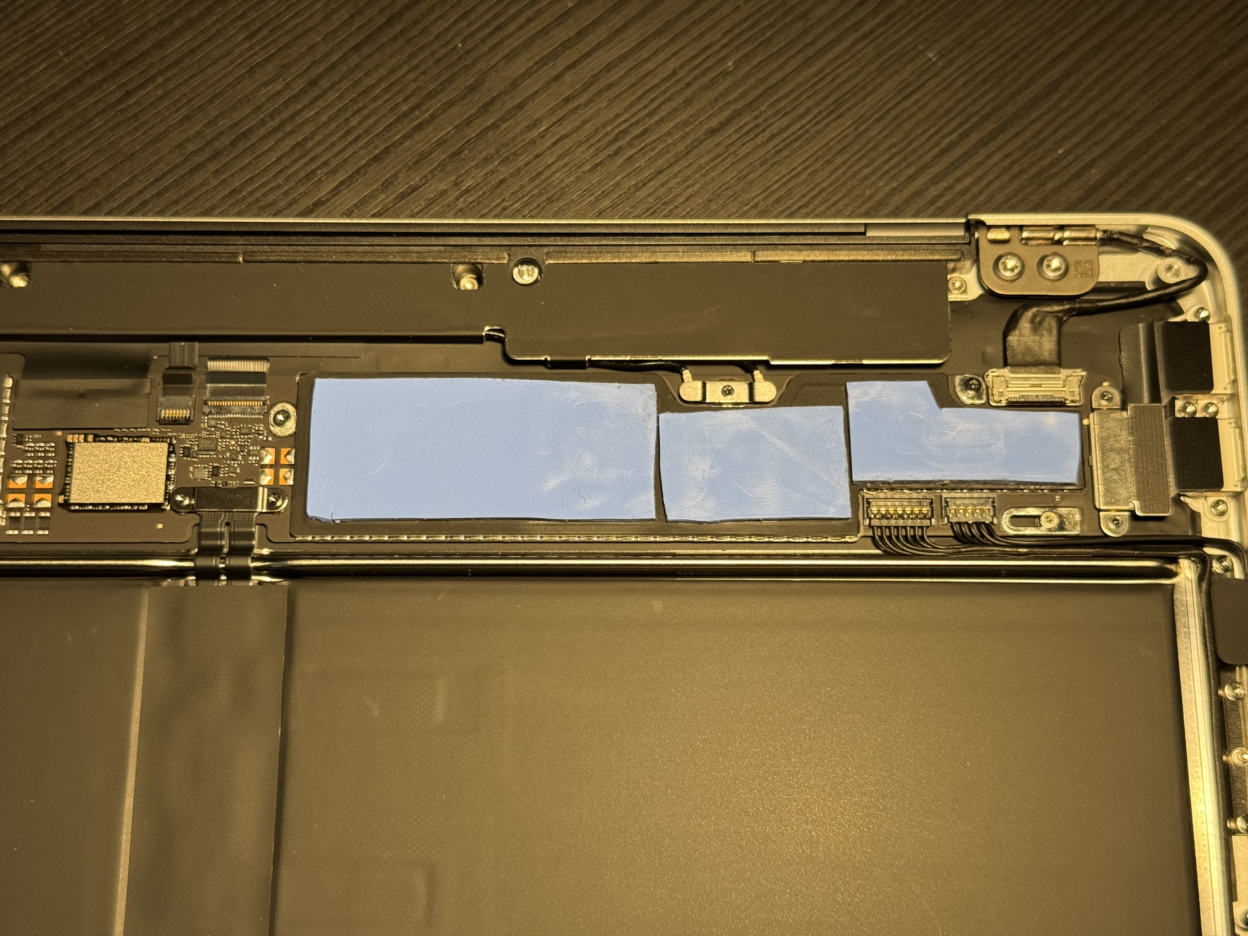

What size thermal pad did you use? Do you have a picture of the two different size pads and placement that you did for your benches?
I used a 1mm thermal pad. As for the placement, the initial pad test was just one small square about the size of the A18 directly over the chip, the second test was with pretty much the entire logic board covered. I ended up putting the pads back in given that there's not much of a thermal issue on the bottom case, especially given how I use my Neo, so here's a pic.

But why not make a custom bottom cover along with a fan in that space at the side?
You'd need air ingress and egress vents, that's a lot of holes. The fan uses energy. The Neo won't have a fan header on the mainboard, how would it be controlled? With an additional temperature sensor? More complexity and hardware.
Seems simple enough. But why not make a custom bottom cover along with a fan in that space at the side?
My suggestion would be to undertake such an adventure and report back on the successes/fails/frustrations.
