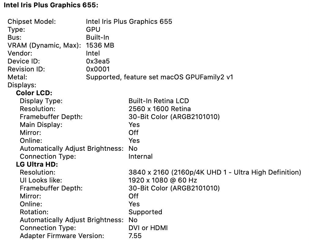

Issue solved. LG OLED55C9 hides higher link rates in EDID until you connect the device, then go to its settings and enable "HDMI ULTRA HD Deep Color" on the port. The Anker must be an active converter then.

On a 13" MBP 2018, this does NOT work. The Anker adapter linked is a simple USB-C to HDMI adapter, and the Intel Iris Plus 655 on the MBP 13 does NOT output anything higher than 1080P in 60hz.
As you can see in the operation mode below, it is connected via the HDMI output / signal generator, which doesn't support HDMI 2.0 required for 4K@60. What I need is an active adapter that lets the MBP talks DisplayPort 1.4 to it, then turn it to HDMI 2.0, but it's super rare it seems.
MacBook Pro 15 / 16 etc output external signals via their dedicated GPU, and on those, it works. But so does any cable that turns USB-C into HDMI directly, it's just a matter of connecting the right pins, no adapter required.

You've got something else going on. I use my 2018 13" with the Anker adapter and an LG display at 4k/60Hz all the time.screenshot.png
Ooh? I'm open to suggestions - this is an Anker A8306, on a MacBookPro15,2 - which has no dedicated GPU options that fixes this issue.
This adapter supports 4K@60 as it can pass through that signal pretty much passively from the HDMI/DVI signal generator, but it doesn't talk DP to the MBP I'm typing this on. Can't convince it to do otherwise, and it would surprise me if this tiny adapter is multi-protocol and talks both HDMI (TMDS) and DP (LVDS).
Option-click "scaled" in Displays gives me 4K @ 30, 24, and also 2560x1440@30 etc etc, and SwitchResX comes to the same conclusion.
A simple USB-C to DP cable gives me 2560x1440 @ 60 on a standard monitor (Dell U2711) which is faster than HDMI 1.4 supports, so the MBP talks DP just fine. It's just a little slow on the HDMI side, I think, but I would be happy if I can convince it to talk 4K@60 natively without even more adapters. Suggestions on what to click / type / edit next welcome.
