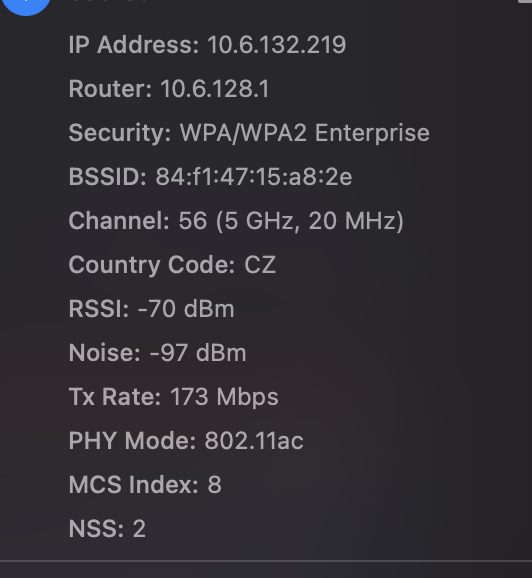

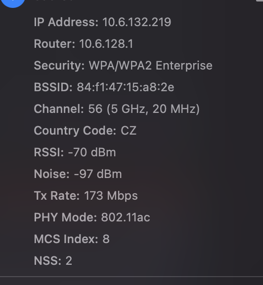

Hello guys, Im having troubles just with wifi icon in top bar section. Even Im connected to wifi, it shows searching icon of wifi (but im still browsing as usual). My stats like this:

Im not sure since its my dorm wifi network, Im sure that top speed on ethernet in this dorm is 100Mbps so I cant really test it out on faster connection. On speedtest.net (over wifi) im getting apporx 70Mbps, whis is normal
