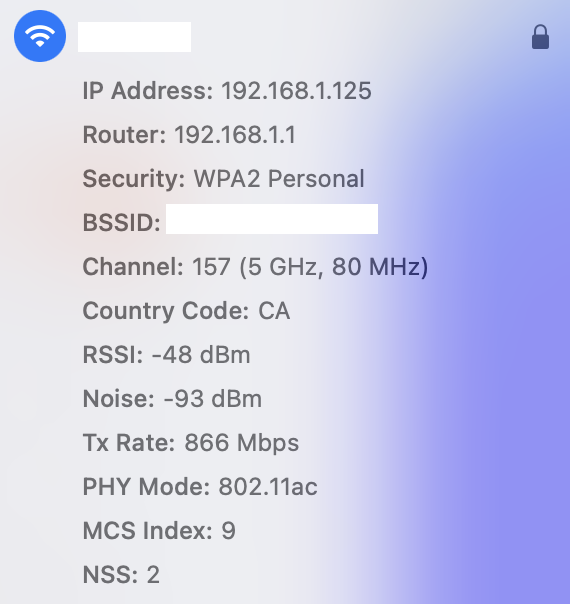

Make sure on 5Ghz you have channel 80 Mhz up. If you are running on 40 Mhz, you get half of the bandwidth. So does 20 Mhz.
Going up to 160 Mhz which my UI hardware router can support won't do much because it only has 2x2 supported by the MacBook Pro 14.

Thank you for the tip. It shows Channel: 112 (5Ghz, 80 MHz), but if it didn't, how would I change it?

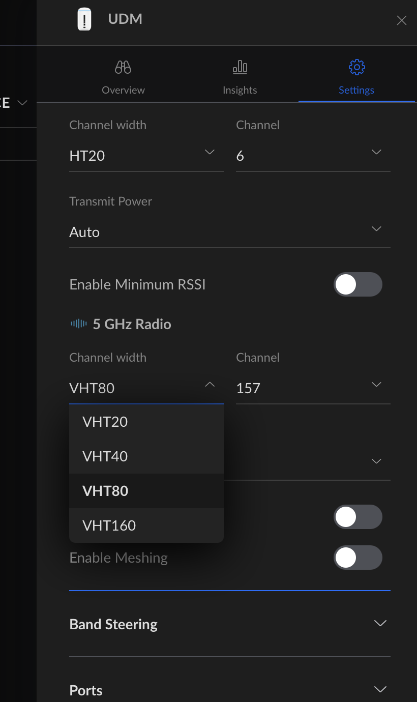

In your router setting/configuration - that I cannot help. Every brand router is different. One I have here is a UDM Prosumer grade router (expensive) that I can switch on the fly.
