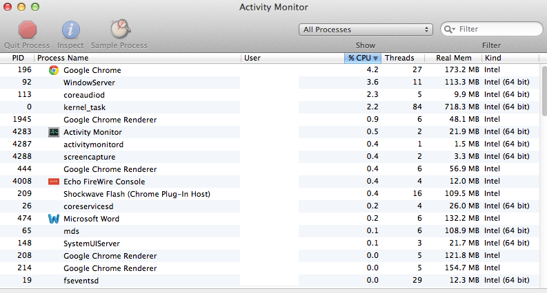

0.o that is odd... what are your temps at? and can you post a screenshot from activity monitor?
It seems to hover at around 63C-65C for the CPU on low load. I just turned on my computer from sleep and starts at around 40C but it slowly makes its way up. I suppose it's just the variance that dusk007 mentioned, but still a bit frustrating.
Also there shouldn't be any issues having restored the computer with a time machine backup right? Upon restoring, it mentioned it should only be used for the source computer that made the backup. With only the cpu and gpu changed, figured it was practically the same machine. Read in some threads some people doing a full-os re-install to help with some heat problems.

with those loads, i am surprised yours is running so hot...
I would think it would hang between 40-50C, especially since I am running a similar load, but at 47C...
wait. are you switching your Graphics to integrated only or using the dedicated (which happens when chrome is open)? that makes a huge difference in terms of temp.

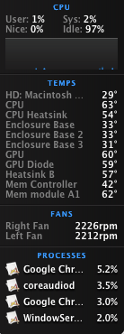

I just have it set to automatically switch. I have an external monitor hooked up though, which I think I read keeps the dedicated graphics on. I will say today, it does appear to be the same temperature, but the fan rpms are maintaining a lower speed. Last night it was around 2600-2800.
Anyway, thanks for the responses. It's hard not to be suspicious, considering the previous machine I couldn't even hear a hum in regular use (reminded me how people feel with electric cars) and seeing forums about overheating mbps.

Your new machine may have poorly applied thermal paste. Quality control on 2011 15" MBPs has been terrible, in my experience.
yes, using the TB port automatically turns on dedicated graphics, because apparently it runs through the AMD card.
That is probably the reason that your CPU is staying so warm, although honestly I think it's still a little high. I would consider taking it into a Apple Store, if possible, and showing them screenshots proving it is running fairly warm.

Also, Chrome triggers the dedicated GPU. I use gfxCardStatus on my 2.4GHz i7 MBP to force the integrated GPU only and it stays perfectly cool. Using the dedicated GPU does ramp up temps a bit, although it really never triggers the fans so that I can hear them..

Chrome isn't the only thing that turns on the dedicated card. If i check, these are the programs that would turn on my dedicated card:

Yeah that's what I'm worried about. Definitely after checking today, the CPU temp hovers around 65C. Wondering if it's worth trying to purchase another one, just to make one last effort of getting a more "perfect" model. Although I would assume it would be from the same production run, so won't be any different. Can't really have my computer stay overnight at the apple store for a check.
