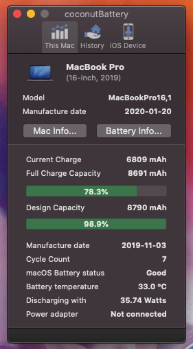

Hello.
I have my MBP 16" since December. I have lost 2% battery life since then (value from coconut battery) but today I noticed that I have only 87% capacity. I noticed this twice - a few days ago I had the same issue but it was solved by resetting SPM and running my machine in safe mode and charge the battery to full.
I noticed this situation both times after playing the game (Diablo 3). While playing game I had a computer connected to AC power.
This is strange. Does anyone noticed this kind of issue?

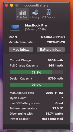

@jerryk Did you understand what my problem is?
My battery lost lot of capacity (more than 1-2% in this case 15%) over few hours and then receive it back. I noticed such case while gaming.
I can't found similar issue in search ☺️.
I have the same issue, I got my MBP 16" in December and it came with 96% capacity and now it is down to 93% capacity with only 30 cycles.
it didn't really lose the capacity, it lost it's internal track of how much charge it was storing.
Capacity calculations and such are all basically theoretical, it's very hard to keep a 'true' value of these things, everything is a best guess/estimate of some sort.
This seems to happen when high demand uses cause battery to be depleted whilst plugged into mains.
Though some capacity will certainly be lost over time-- the 96 to 93% drop is likely more real, but short of full discharge/charge cycles you can't really get a close idea of what it truly is, and such cycles are recommended to be avoided anyway as they also hurt capacity whilst revealing it.

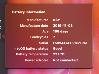

I did that today, but all I've been doing is listening to music, using safari with about 5 tabs open, and my battery is dropping a lot. At this point, with this computer having kernel panics and now battery issues, I just feel like returning this machine.

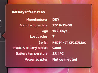

what’s your battery health?
it seems new wait a few days until it’s done its indexing. btw what’s the battery manufacturer? click battery info on coconut
How long does it take to index? I have the computer for about a week now, got until May 11th to return.
