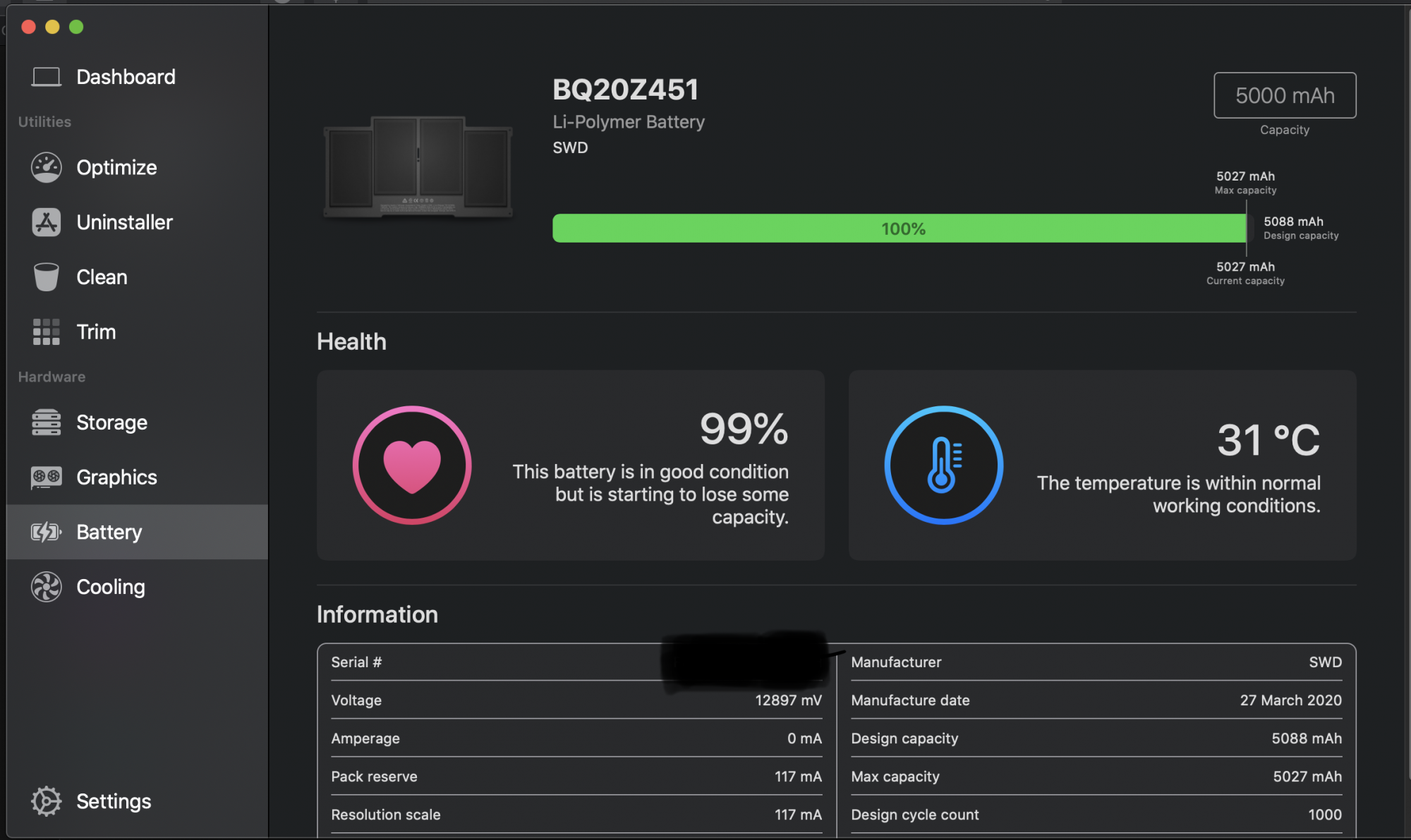

I had the same issue. I've been using this MBP 13" 2020 (highend model) for 2 weeks. however, after downloading the recent MacOS update, I have noticed that my battery is starting to lose capacity. I am using this device for my homework and school projects (Keynote Presentation, PPP, MS word). any thoughts?
How many charge cycles on your machine? Sorry if I missed it; I don't see it in the screenshot...
I have a 2020 13" also an I am still reading 100% capacity (5122/5088) after 12 charge cycles. Manufacture date March 17, 2020.

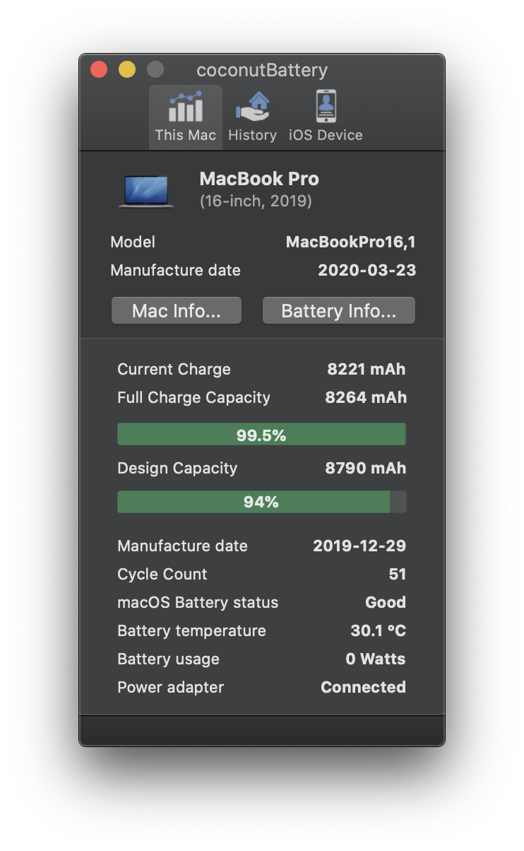

I'm facing the same issue. The root of the problem may be related to Battery health management. After I disable it, here's my battery info. When I re-enable it, the full charge capacity drops to around 7950.
