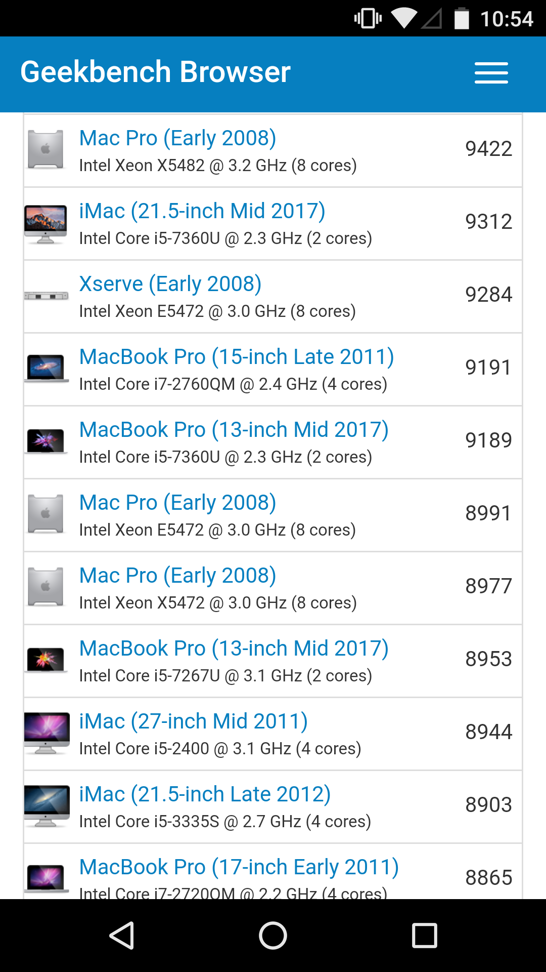

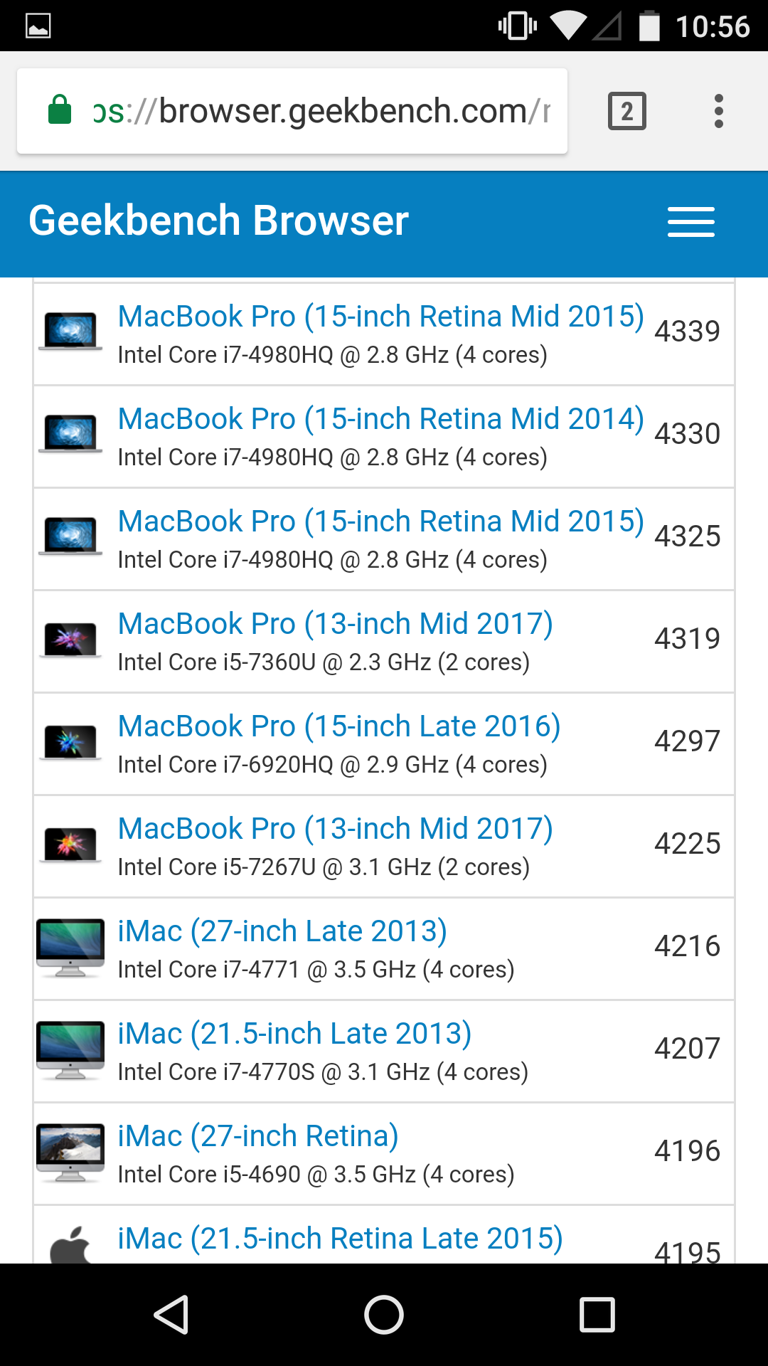

Hi,

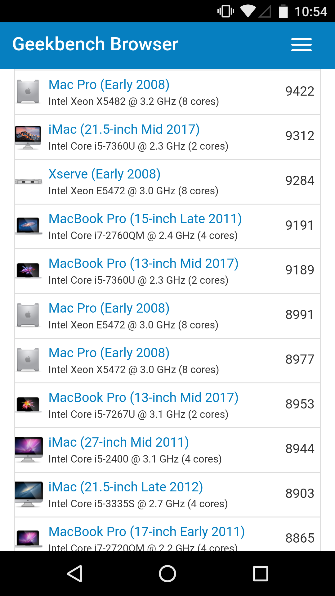

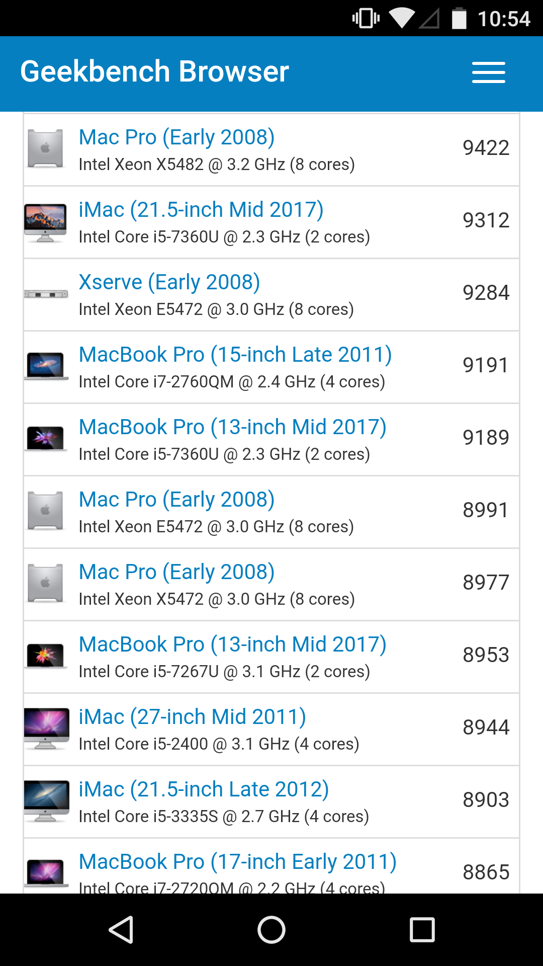

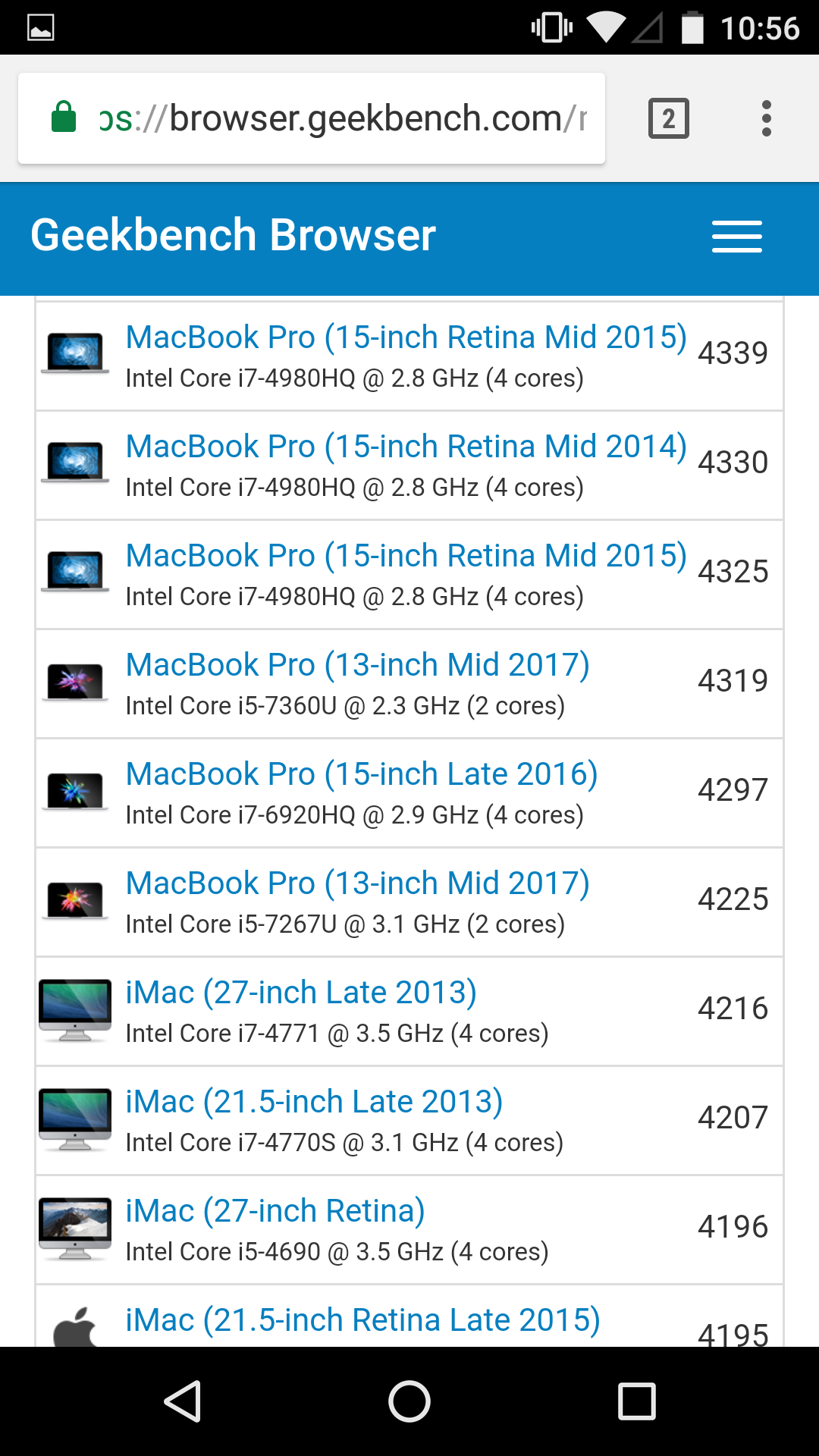

I was deciding between getting the 13" Touch Bar (Intel Core i5-7267U) vs the 13" Non-Touch Bar (Intel Core i5-7360U). The i5-7267U is clocked at 3.1GHz while the i5-7360U is clocked at 2.3GHz.
I was looking at online Geekbench benchmark tests comparing the two processors so I could see exactly how much faster the touch-bar model is. However, I found that the 13" base model with the i5-7360U had higher single and multi-core performance numbers than its more powerful counterpart, the i5-7267U...
How is this possible?
Attached are the pictures of what I found.
Single Core:
Multi-Core:

Well, different tests may lead to different results. Let me give you an explanation which is by no means technical, but more of an educated guess.
The Core i5-7360U is a 15W processor with base clock rate at 2.3 GHz, but which can go up to 3.6 GHz (both single and dual core). The Core i5-7267U is a 28W processor with base clock at 3.1 GHz, but which can go up to 3.5 GHz, both single and dual core. So, while the Core i5-7267U has a faster processor at base clock speeds (most of the time), the Core i5-7360U can go faster when it is required (difference, though, is minimal, and the Core i5-7267U should be faster most of the times). In addition, the Core i5-7267U has a faster GPU than the Core i5-7360U.

The reviews I've seen show performance drops in the nonTB under stress because, as you say, the cooling is inadequate.
The Kaby Lake processor from the entry-level model has the designation Core i5-7360U and the base frequency for the two cores is 2.3 GHz, but the maximum Turbo Boost is 3.6 GHz for both cores. However, this speed can only be maintained for a couple of seconds. Apple removes the usual TDP limitation at 15 watts, but the two CPU cores quickly reach core temperatures of more than 90 °C, so they have to reduce the clocks.
The cooling solution of the MacBook Pro 13 is challenged by the high clocks of the Kaby Lake processor. Sustained workloads simulated by a Cinebench R15 Multi loop results in a performance drop.
The TB, with superior cooling, does not show the same drops.
The processor can maintain its performance under sustained workloads. A loop of the Cinebench R15 Multi Test determines a steady score after 20 runs; the only small outlier was probably affected by a background process.
https://www.notebookcheck.net/Apple-MacBook-Pro-13-Mid-2017-i5-Touch-Bar-Review.227154.0.html
https://www.notebookcheck.net/Apple...017-i5-without-Touch-Bar-Review.234282.0.html
Yup, summing up gjwilly's post above, but click on his notebookcheck.net links to read in detail:
  • MBP nTB = lower wattage CPU, one cooling fan, higher max turbo speed, throttles under heavy load
  • MBP wTB = higher wattage CPU, two cooling fans, slightly lower turbo speed, sustains speed under heavy load
  • Light tasks such as web browsing, email, watching movies, might be faster benchmark-wise on the nTB because of the higher max turbo. Hands-on though, I doubt you'd be able to notice the difference between the two.
  • wTB would obviously be best suited for heavier tasks, but that depends on what heavy means to you.
  • Heat and fan noise could also help separate the two models.
