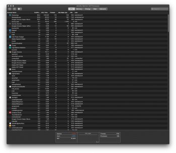

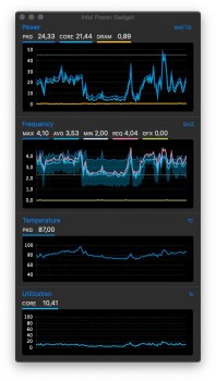

Back from a clean install
just playing around in photoshop with brushes for 5 minutes in just ONE document.
behind playing HD video on chrome.
and some spotify music
87 Degrees...

Chrome is your issue. I’m not sure what it is with Chrome, but that always causes my MBPr’s Fans to spin up.

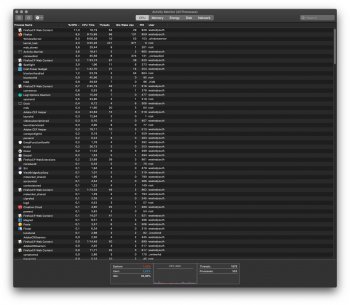

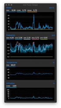

coming back with firefox
no youtube just surfing the internet.
70 degrees average

Are the fans on at all? My GPU operates similarly, where the fan doesn't even turn on until it hits I believe 60C, the temperatures are not a concern until they are in the 90's/low 100's.

Seems like something prevents your cpu from down clocking. It's running at at the highest base clock.
