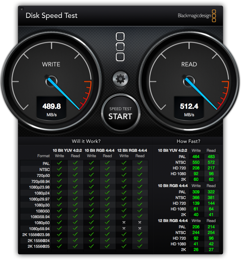

Well, two days past the estimated shipping date (thanks USPS), the SATA cable has arrived and been installed!
I've fresh installed Mavericks onto the EVO and enabled TRIM without a problem! Been using my MBP for about 4 hours now without any hiccups at all! Negotiated link speed is back to 6Gbps as well!
If today is any indication of the future, I'm again very happy with the performance of the machine. Boot times are 15-20 seconds compared to 1.5 minutes and system responsiveness is amazing now...no beach balls! Battery life is already seeing an improvement as well, I've been on battery for 45 minutes now and am still at 91%.
I'm very, very satisfied. Thanks everyone!
