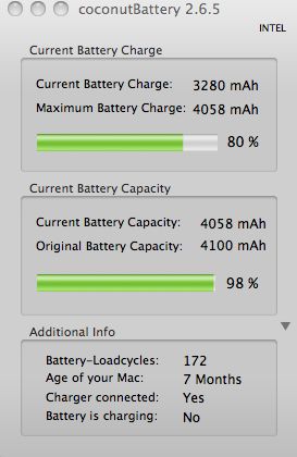

Out of curiousity, I downloaded coconut and checked mine. I show 172 cycles...

Just for everyone posting coconut battery stats... you do know that Apple ignores anything other than what System Profiler says, right?
2nd mac 1st I use, and this time thy didn't get me,
instead of apple care, i made a cheap insurance (without theft) and when the time came they shipped me a new bat and a\c plug.
So I called - I'm out of warranty and the only thing they can do is offer me a part-in replacement that's $30 cheaper yet has shipping and handling and only a 90-day warranty (vs the 1-year warranty with a retail price). I think that this point I'd put all my eggs in the warranty basket.
Genius bar does everything based on [their] current mood, what jerk you get or nice guy you get.
I agree. My battery health was about 50% around the 1.5 yr mark. I made a genius appointment, and luckily got a "nice" guy. He looked at my iStat and system profiler. He then unwrapped a new battery, took my old one and I walked out with a brand new battery in my laptop. Took 10 min max. Never hurts to ask for a new one.
So the same bugs that show up in Coconut actually originate from System profiler? interesting.
CoconutBattery estimates the age of the Mac based on your product's serial number.
The only bug is if it can't work it out and gives a crazy estimate of the product age.
There's no bug related to the actual battery reading.
