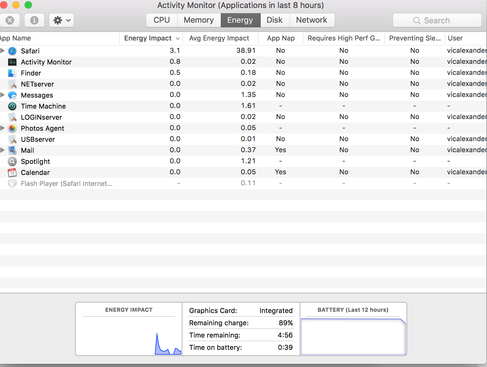

Thanks! Yeah I don't know whats going on..I'm only running Safari... I'll post that info for you
[doublepost=1506544710][/doublepost]Here it is (attached)

Yeah, that definitely looks like Safari is burning up the battery. It's not due to the GPU.
There's a little right-pointing triangle at the left of the Safari name (it's called a "disclosure triangle"). Click it. I'm guessing it will expand to show Safari's sub-processes, which should basically be one "helper" process for each tab or window Safari has open. Please post a screen shot of that, as it may shed more light.
I'm guessing about the disclosure triangle because I don't have 10.12 on anything handy, so I can't check it here.
Since the excess power doesn't appear to be tied to GPU usage, my next guess is that Safari is consuming CPU for some reason.
Safari's CPU use depends on how many tabs or windows it has open, and what's in each of those. The CPU pane of Activity Monitor will show CPU consumption. If Safari has a disclosure triangle, click it to expand and view the "helper" processes before taking a screenshot.

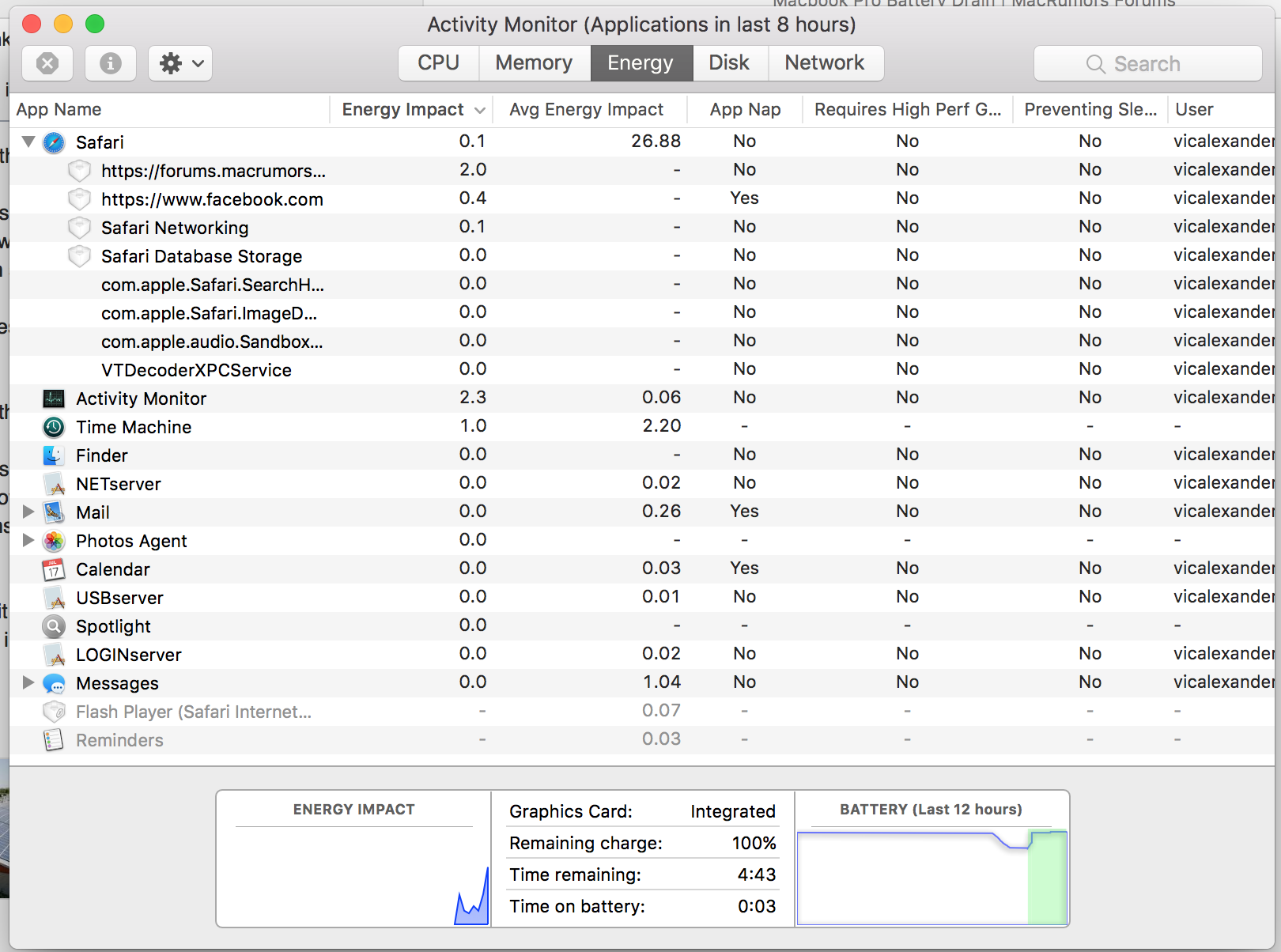

I take it all your recent posts with info, screenshots, etc. have been made in Normal Mode, rather than Safe Mode. If they're in Safe Mode, i.e. Safe Boot is active, then please state that clearly.
I am doing all this in regular mode. Here's the screenie. Thanks so much for your help!

Well, that shows which tab or window is burning the most energy. It's this very site. So my first guess on that is an ad, but that's just a guess.
The CPU usage might add some detail as to what's burning the power.
Does this help?
It does. It tells me that whatever page from this website is loaded when you took that screenshot, it's burning up about 10% CPU. That strikes me as high.
I can't think of a good reason why that might happen, so my first guess is ads.
My second guess is that somehow some JavaScript is running frequently or possibly looping.
If you close the MacRumors website in Safari, and then look at the CPU pane, what does it show? It might take a minute for things to settle down.
If you quit Safari completely and look at the CPU pane, what does it show? What does the Energy pane look like with Safari quit? If you let it stabilize for a few minutes, does the Energy Impact graph go down? Does the Time Remaining estimate go up after a few minutes? That estimate seems to use an averaging algorithm, so you'll have to let it sit there for a few minutes before it recalculates the Time Remaining estimate.
With Safari quit, does the WindowServer %CPU go down? If so, then it's Safari that's causing WindowServer to burn CPU. If not, then something else is doing enough drawing to raise WindowServer's CPU usage.
With Safari quit, does Safari Networking also terminate? Here's another MR thread on that process being a hog:
https://forums.macrumors.com/threads/safari-massive-cpu-hog.1598831/
You could try a solution in that thread of creating a new user account and seeing if you get similar CPU usage from Safari in that account. You should logout of your current account and login to the new one, rather than using fast user switching.
You can find more info by googling: macos safari networking plugin
Another thing to try is to run Safari, then turn off all Internet Plugins in its Preferences window. Do it temporarily, then visit the MR website and see if the CPU usage heads up to 10% again. If not, then you might have an old or malfunctioning plugin. You'd then have to list all your plugins, and check their version numbers against what the latest versions are, or the versions with best 10.12 OS compatibility. You could try enabling them one at a time and see which one, if any, leads to increased CPU.
