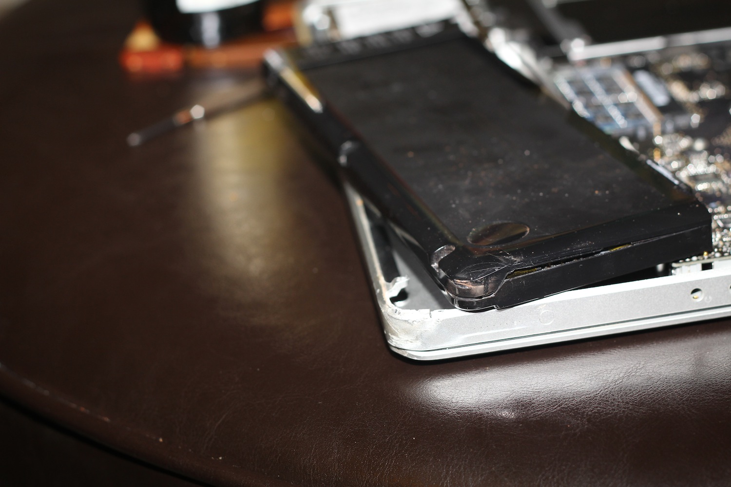

I forgot to put this up, the battery is cracked in the corner where it was dropped. I went to system information and it says the battery is good. I don't know if this has a effect on what's going on?
Picture of the cracked battery please? I also cracked my battery, well opened it in a sense. But I put it back together and it lasted one more year before it started degrading at its expected time (no sooner).

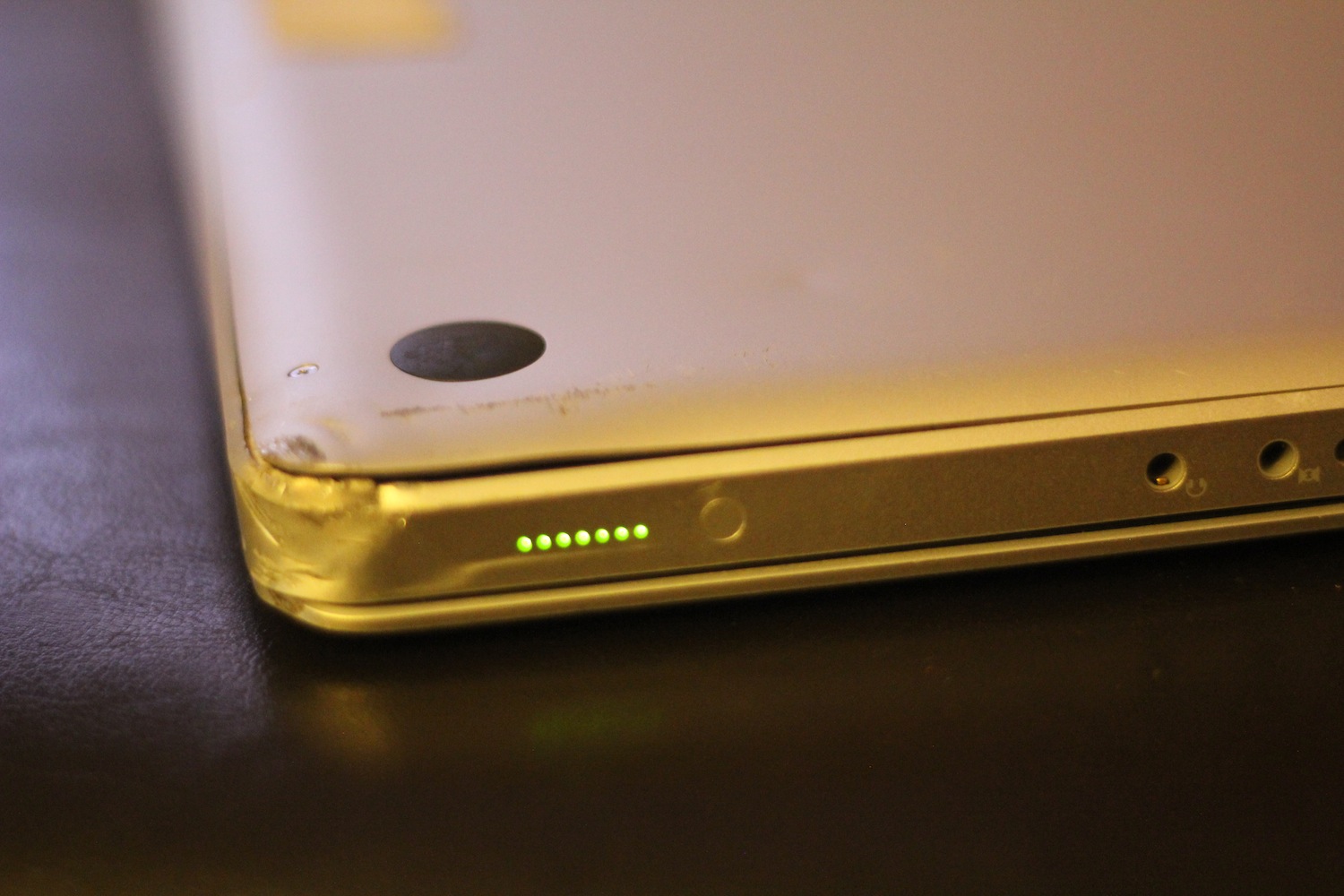

I understand, probably so, show me a picture of where the damage was caused. Let's try to determine what got whacked.
Ok here you go...

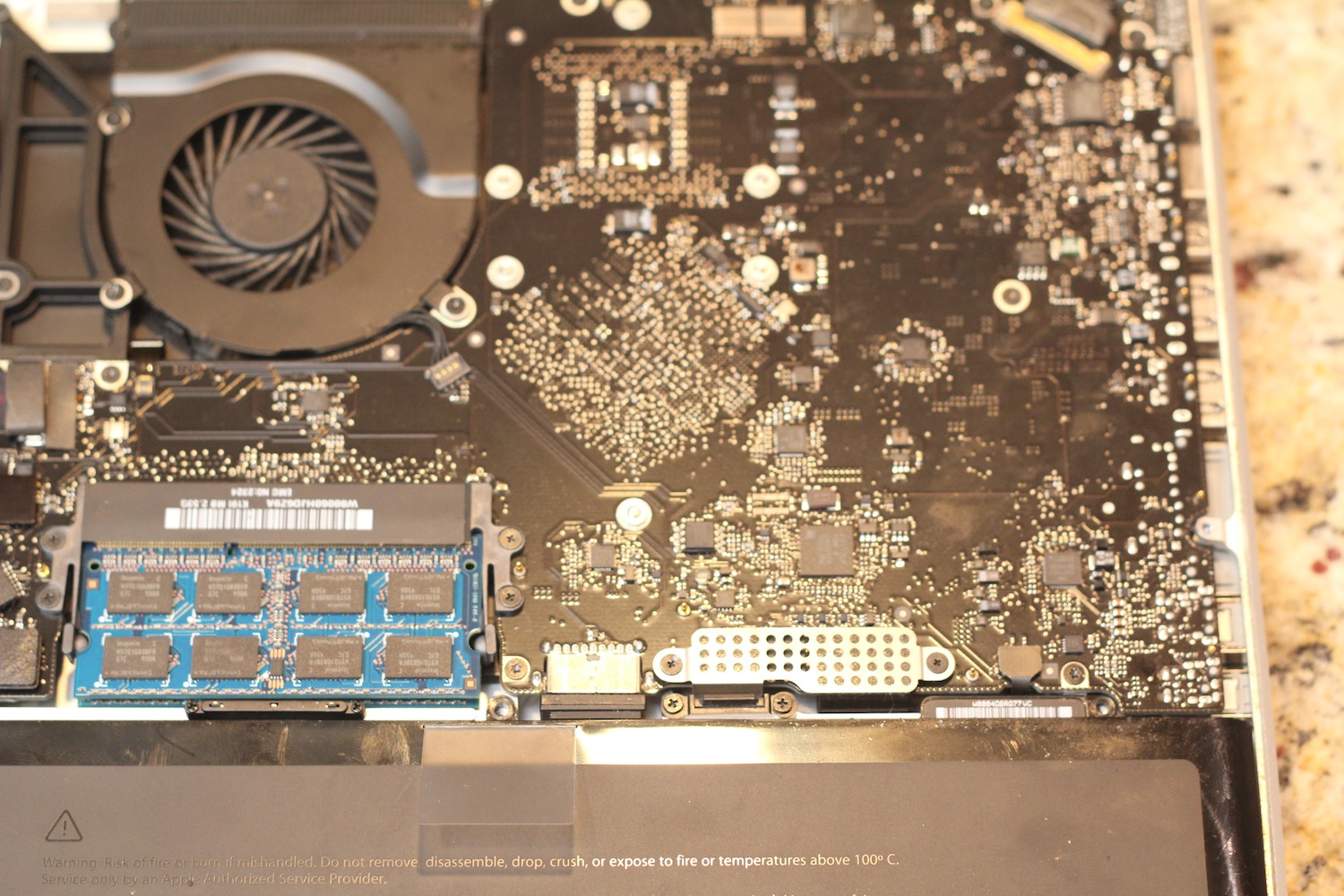

Ok, it seems the battery got the blunt of the hit. Wow, strong hit. Anyways, the force of the impact could have been transmitted over to the motherboard which is right after the battery. Any signs of damage to the motherboard? Lifted edges, moved board? Anything that seems off or out of place by a tiny bit. Remember, Macs (unibody) are engineered to be very precise, and a small misalignment means damage somewhere.
No signs of damage to the mother board. I don't see anything the looks broken? The fan was spinning, so that works. I also check both USB and Firewire by hooking up and external drive and they worked.

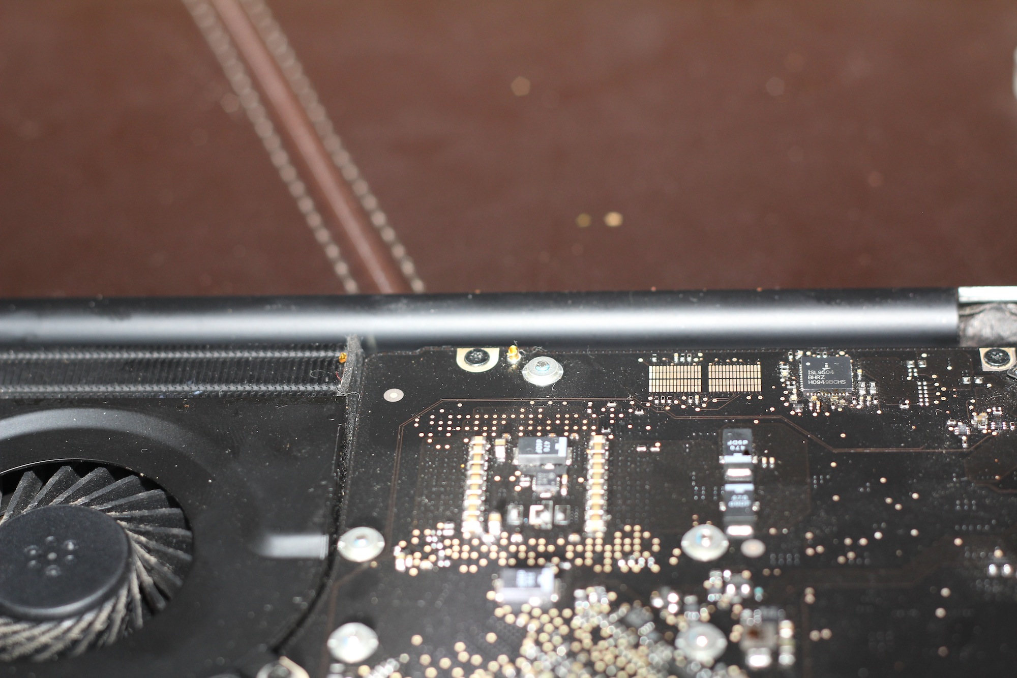

Can you get a close up to the battery/motherboard boundary? I see from the second picture a small dinge to the mobo...
I found this, one the small spring loaded gold pins is broken on the tip.

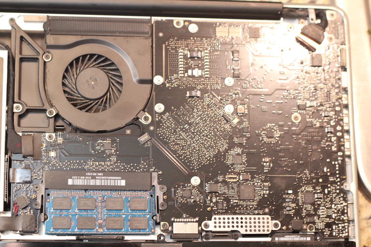

Mother board pics.
