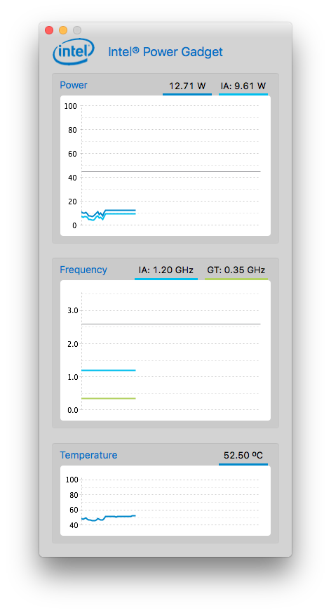

My faithful 2012 15" MacBook Pro is acting a little bit strange. I first noticed it really being sluggish in Final Cut Pro X a little while back, but since my project was really large, I thought that was the cause of the sluggishness, but it is not as I recently found out.

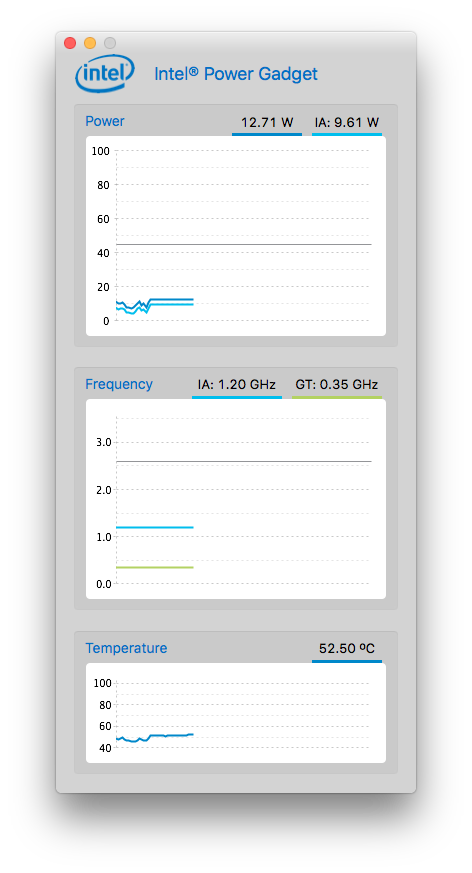

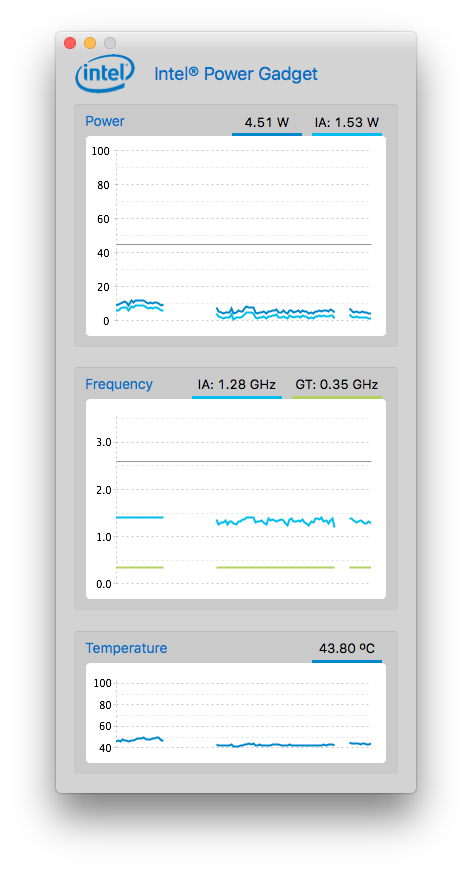

My laptop seems to actually be clocking itself to exactly half of the CPU's advertised clock speed. The CPU is a 2.6 GHz i7-3720QM, but it actually is clocking itself at 1.3-1.4 GHz while in OS X. I thought this was really strange. I used the Intel Power Gadget to measure the CPU clock in OS X and used the Intel Processor Diagnostic live USB to measure it in Fedora while booted off of a USB drive.
In OS X, the clock speed is stuck at that 1.3-1.4 GHz point (screenshots attached) but in Fedora, the clock speed is 2.63229 GHz, normal for the CPU. The first thing that I did after checking the clock speeds was to check CPU temps, but the Intel Power Gadget and diagnostic test reports 45-50ºC, again normal for the CPU. Next I checked the battery, which reports a normal condition. It is well known that a bad battery can cause halving of the clock speed, but that appears not to be the culprit here. After checking the battery, I reinstalled OS X on a separate drive to rule out a software issue. No dice. Clock speed is still 1.3-1.4 GHz. I work in IT for a school district that is an Apple SSA, so I ran ASD next. Completely passed both the EFI and OS diagnostics with flying colors. What???

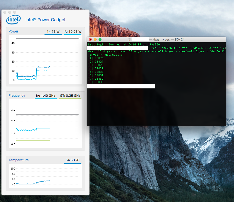

I know that CPUs only run at their advertised clocks when under load, I just forgot to mention that in OP. That said, I don't have handbrake, but I can use "yes" in terminal to max out my CPU cores. When doing this my CPU hits 1.40GHz and stays exactly there. Any more ideas?

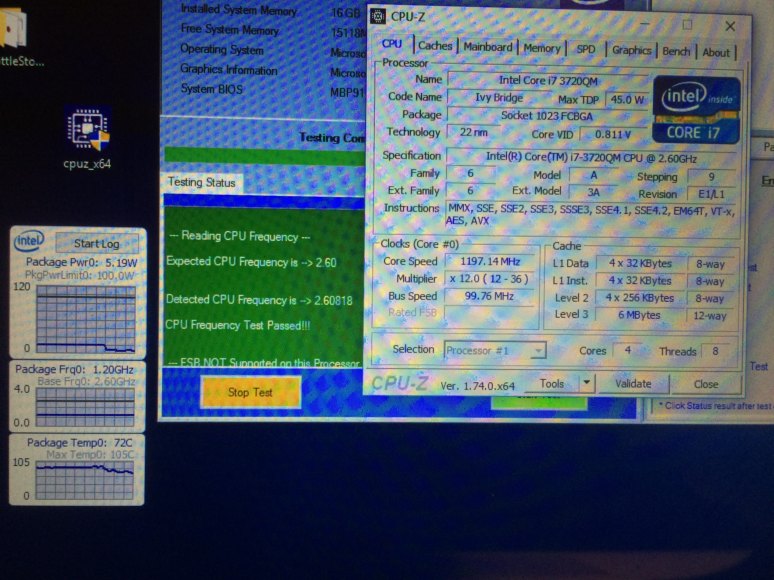

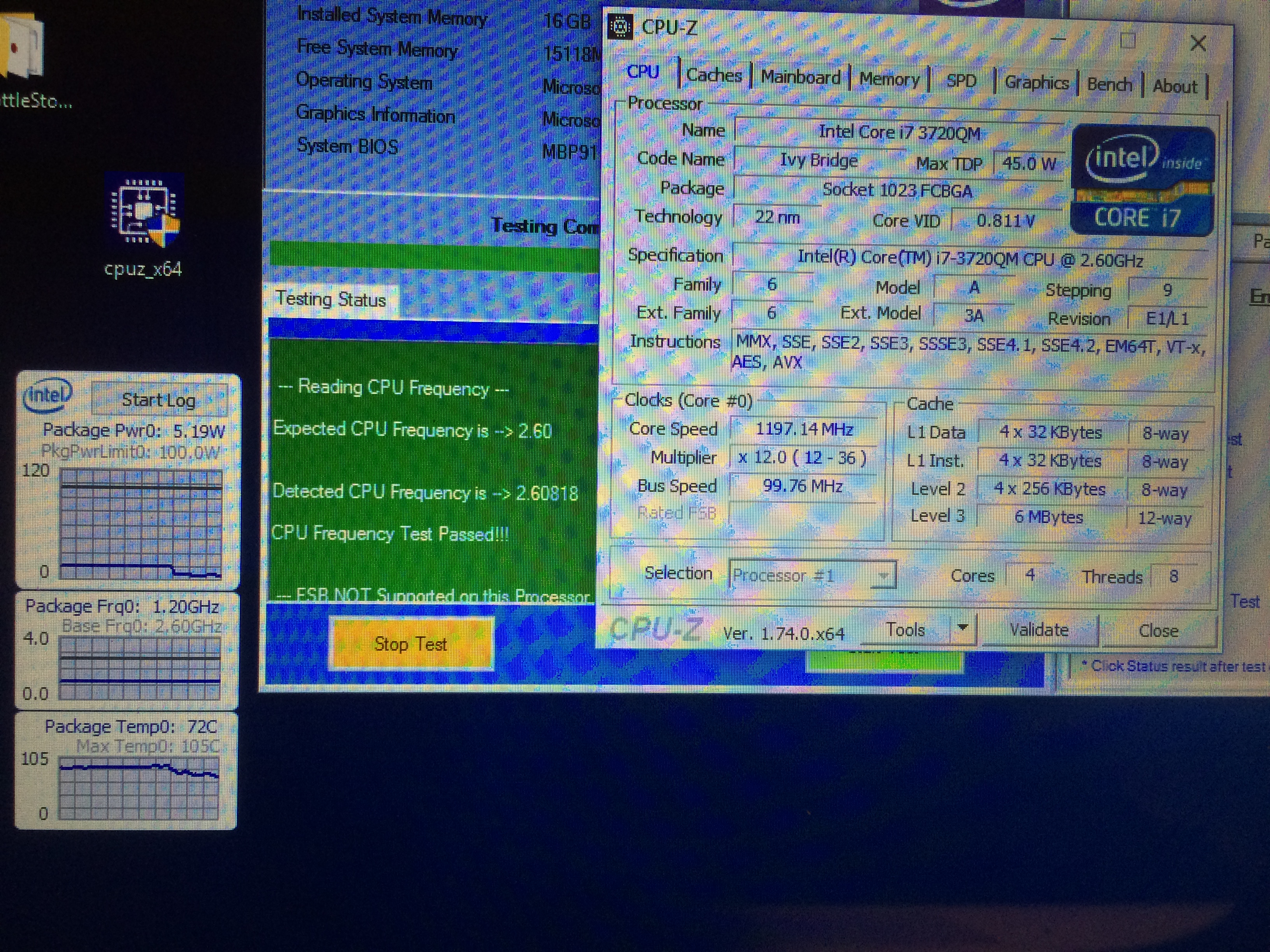

Time to make this already strange thread even stranger... Installed a fresh copy of Windows 10 Pro in BootCamp. Installed CPU-Z and AIDA64 to see what we could get. The CPU is at 1197.14 MHz according to CPU-Z and the Intel Power Gadget while running an AIDA64 stress test. The clock won't go any higher than that exact number. Temperature was constant at 92ºC, so nowhere near the throttle point of 105º (I still did a test with the fans cranked to the max using Macs Fan Control, but it didn't change anything). Interesting... let's run the Intel CPU diagnostic. The CPU diagnostic reports a clock speed of 2.60818 GHz, so a pass for the clock speed test. Meanwhile, I still have CPU-Z and the Intel Power Gadget open. Both are reporting 1.20 GHz. What?!?!?!? Conflicting results aside, I might have to throw away the Intel CPU Diagnostic results as they seem to not be accurate.
Also, I had a look at AIDA64's voltages tab and my CPU is running at 0.811V, so that is on the really low side of normal. Looking at the 12V rail on the power supply reveals 16.31V. This is a possible issue, but it might just be a monitoring error. Any advice or ideas?

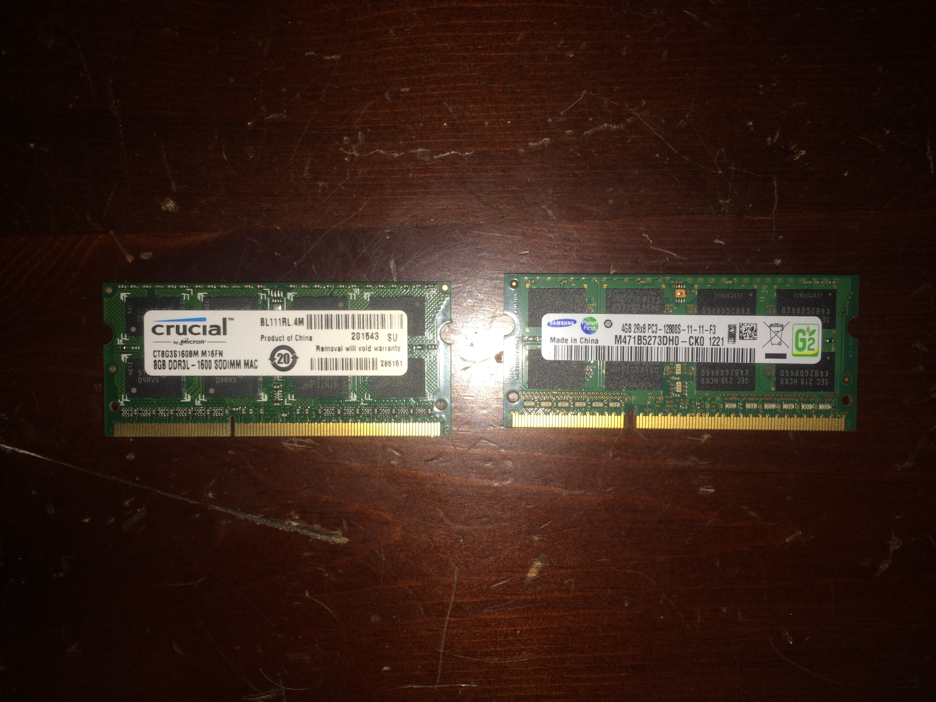

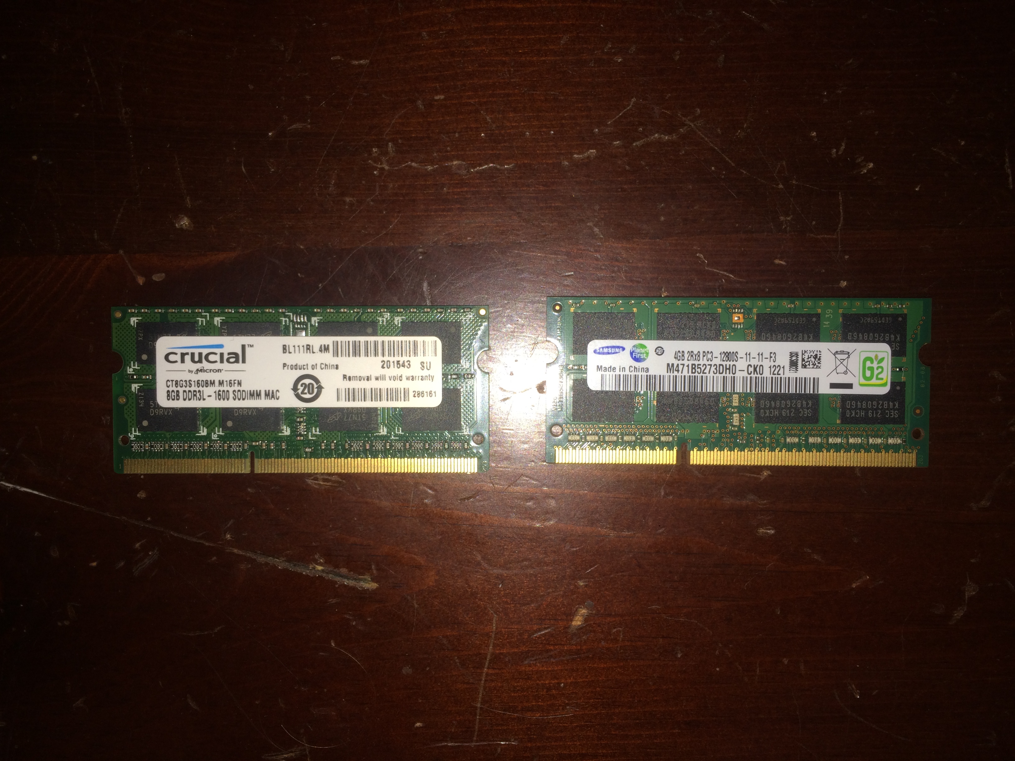

Did you notice the slowdown before or after you put in the new memory? I'd definitely try putting back the old memory back in - especially if you had 8GB (or less) before. Some people who used good-quality memory have reported problems with 16GB in their 2012 MBP.
Now that I think about it, I noticed the slowdown about two days after I installed the 16GB of RAM. The old RAM was 8GB. I will re-install it this afternoon and see what I can get.
Did you by the correct voltage ram?

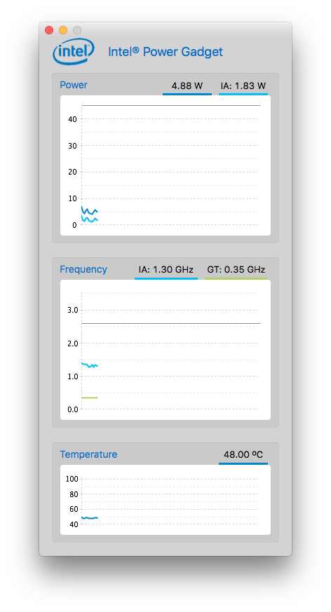

I replaced the memory again with the 8GB of factory-installed memory. No change in clock speed behavior. While I had the machine open, I unhooked the battery and checked the clock speed. I noticed that the speed was constant at 1.20 GHz with the battery unplugged, even while running yes in terminal 8 times at once to max out all of the CPU threads, but since the battery is unplugged, this is normal.
I attached a picture of the new vs. old RAM as well, but AFAIK they are completely equivalent spec-wise (I could be wrong though).
EDIT: I wonder if the constant 1.20 GHz frequency that I was seeing in Windows has some sort of relationship to the constant 1.20 GHz frequency that I was seeing when I had the battery unplugged...

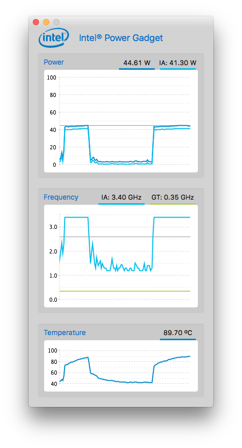

New battery = full on turbo boost for extended periods of time (see attached screenshot)!
This really has been an experience. Not sure why or in what way the old battery was malfunctioning, or why ASD didn't pick up the issue.
Either way, my MBP is ready to be a great computer again for years to come. Thank you all so much for your help and words of encouragement.
EDIT: Attached the screenshot twice, whoops. Also, I have my 16GB of RAM in there too!
