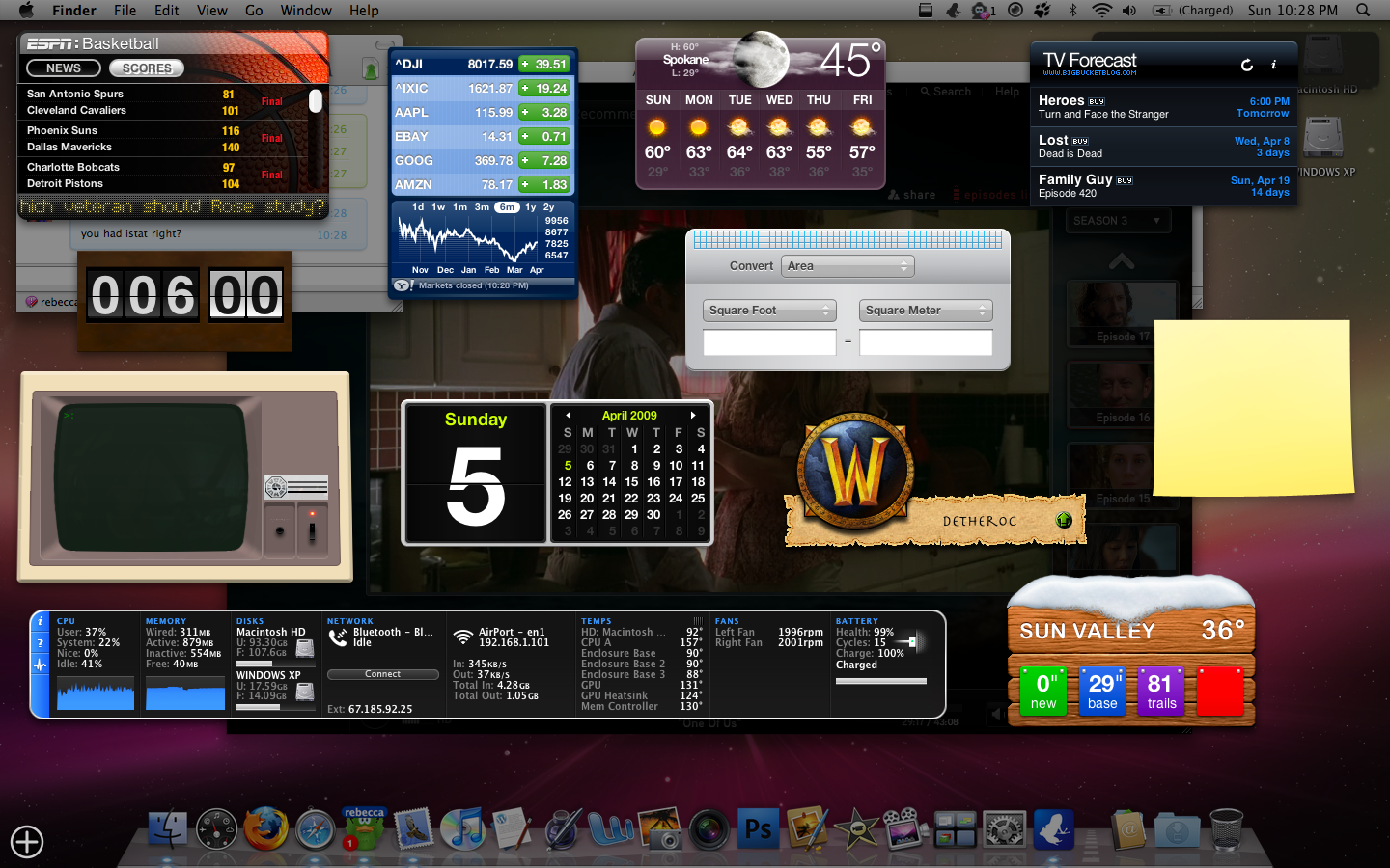

Is this even possible? This is what iStat Pro is telling me about my CPU.
I'd just like to know if anyone thinks this is possible because to me if my cpu was at 150 i would think it would be melting.
My fans are at 2000 rpm as well.

Yeah mine usually runs between 85º and 90º Celsius during encoding. Yours is perfectly fine.
Or in Fahrenheit 185º and 194º.

Well within normal. Mine's at 170, at the moment (CPU A Temp Diode), fans at around 2600. Normal is right around 155-160, when I'm not doing anything. Fan minimum speed is 2000 (they're always running).
Under load (running Handbrake), it gets to about 190ish. The fans will ramp up to keep temps below that (around 183) (also, seems to try and keep bottomside of case at or below 90).
I believe the max temperature is 105C (221F) (for 45nm), so you're nowhere near any limits.

157F is really cold! i would be slightly concerned if it got to 157C but thats not likely.
If you want to make it colder you should close some of the flood of monitoring apps you have going on before your Macbook drowns in them, you'll notice your battery life significantly increase too.
