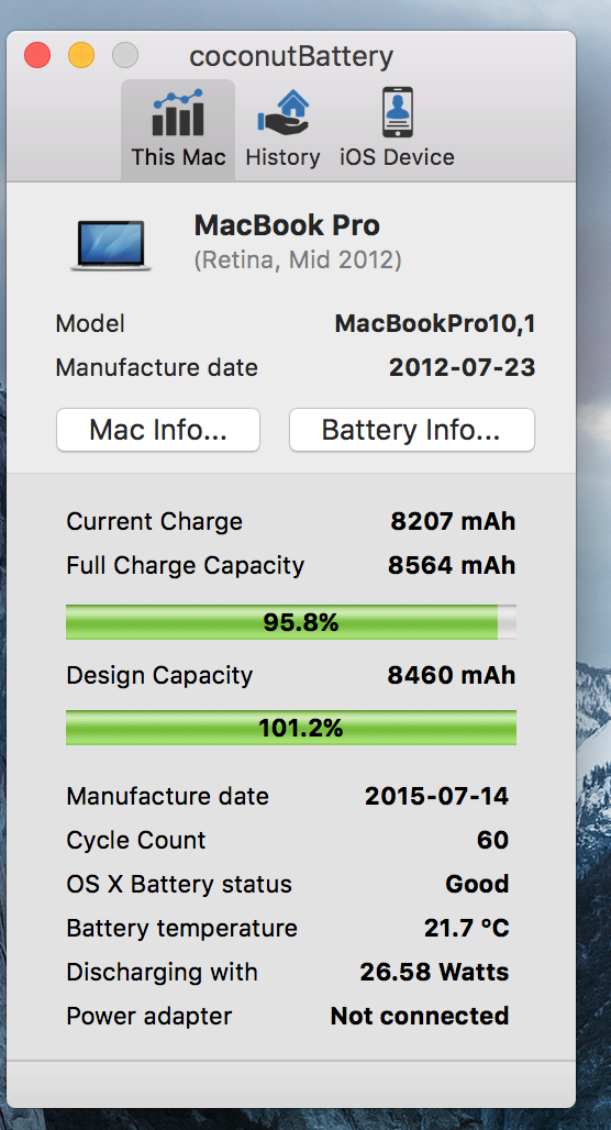

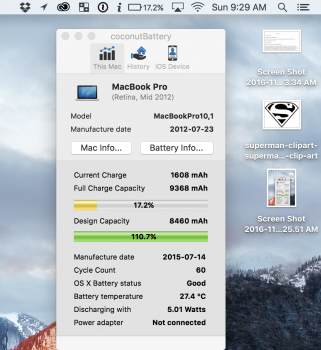

Update: I drained my battery yesterday at 11:00am and left it completely discharged (where it would not turn on) for 24 hours. I then plugged in and charged it back up to 100%. I then left it at 100% plugged in for 2.5 hours.
Now, instead of the battery saying its 112% above design capacity its only saying its at 102%. I drained it to 80% and then charged it back to 100%. It still saying its only 100 to 103% above design capacity (Normally it going back up to 110 to 112% above design capacity.
I'm going to see if I can drain it to 5% and get it to give me a warning. I'm keeping my fingers crossed here. I'm thinking leaving it battery dead for 5 hours wasn't enough. I also did another SMC reset when I plugged the Macbook Pro back in when it was drained dead.
