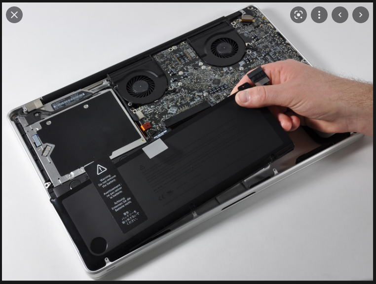

Quick question, is your model using the building-in battery or user replaceable like the Late 2008 models had?
The unibody MacBook Pro (OPs is a 2009 17-inch) battery is somewhere in between. Not the easy replacement of the earlier models, but not like the multi-cell, sometimes glued, later models. It's a hard case battery, with the (tri-wing) screws that need an unusual driver to remove.
That's what I was afraid off. This has me thinking about if one of the cells wasn't replaced.
(?) When you replace the battery, all cells are part of the battery. It would not be possible to replace (or not replace) just one cell. OP's unibody MBPro has a hard plastic case for the battery, but that battery also is made up of several cells inside that enclosure, just not visible as cells like on the newer MacBook retina, etc, models. (Cells can become visible if the battery swells enough to split the case 🙂 )
Reactions: Eightbitgamer757
I'm unfamiliar with the 17" arrangement as I had a 13" one which was an all or nothing approach.
This is the battery situation for my particular MBP, its a hard shell battery as DeltaMac has said, and it is replaceable, just a bit of a pain to do so.
