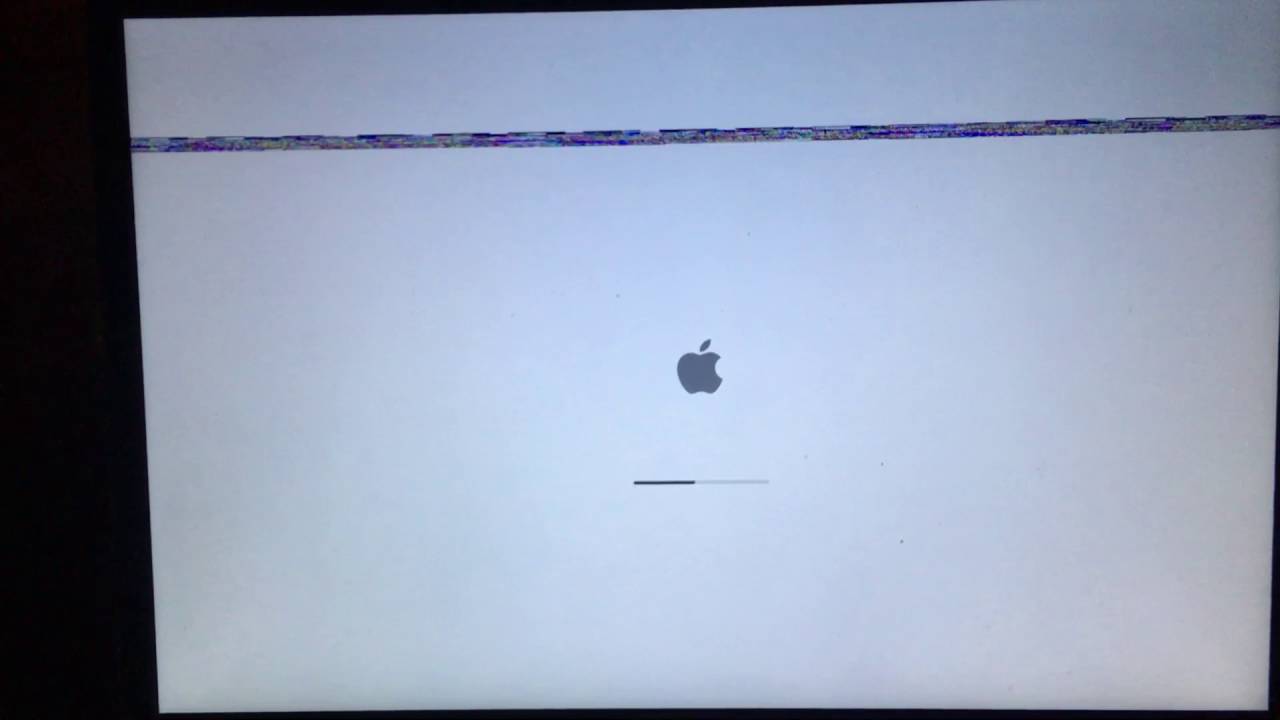

So i wanted to ask if this is a dead GPU or a HDD Problem. Since i read that it could be a HDD Problem. Btw. it boots into Windows without a Problem but when i try to install AMD Drivers in Windows it says no AMD Hardware found. Can someone give me a solution or tell me what the problem is? And how can i reinstall MacOS? I can not get into the Recovery or Network Recovery. Thanks in advance.

Yes but i still think its a gpu failure because of the picture. I can boot into windows but i think Windows only works because there is no Driver for the AMD GPU
Then I stand by my prior statement and say that you should talk to a technician to diagnose the problem. They have specialized tools that can help you in this situation, even if the computer doesn't boot.
If it sticks there with screen corruption then it can't initialise the AMD GPU. Needs the GPU replacing or a replacement logic board.
I don't think that is incorrect. The integrated gpu is not the default, and it will use that by default. It would have to use software based rendering, which is horrendously slow. It would not be mistaken for a moderate drop in performance, and you wouldn't have a normal resolution.
The lack of an installed driver from AMD is irrelevant, given that there isn't any graphics switching. I noticed that stupid band comes up for me upon resetting nvram. It doesn't seem to exactly track the same issues as other graphics problems.
The people saying dead gpu here should back that one up. This model has a lot of problems, yet I am not aware of any circumstance where a dead gpu would still boot into windows. The bootloader would still go through and initialize that gpu, which shouldn't allow it to continue in that case.
It's the AMD dGPU. I had it fail three times on my 2011 with similar symptoms. Apple replaced the machine eventually.
The dGPU is the default, as that's what the DisplayPorts are physically wired into. Hence no graphics switching or Intel iGPU support in Windows.
@MagicBoy I had one fail too, but as you mentioned it defaults to the AMD gpu. It shouldn't boot into Windows if it can't initialize that gpu.
@Zarkex01 it's your money, but it's not worth the $350 for a machine that old with known issues.
First time mine failed it couldn't ID the AMD dGPU on the PCI-E bus. Windows defaulted back to basic (VESA?) 256 colour mode as it would with an unknown new graphics card.
