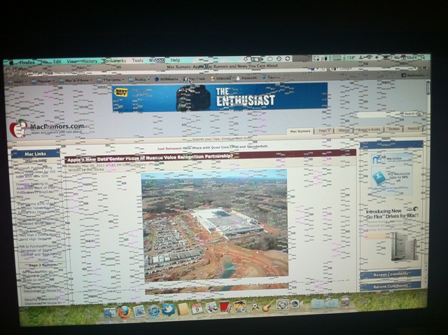

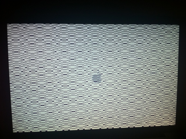

So...my Macbook Pro has been freezing and the display shows the attached picture. It's not overheating, that I'm certain off. It's done it about 6 times this past week and when it happens I can't restart without it happening again at boot up. I've done PRAM reset and nothing helps. Appt with the Genius Bar today...
