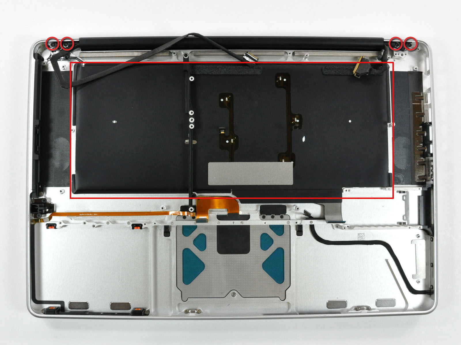

There's a layer of plastic in between the logic board and the upper case. The casing provides less heat dissipation than everyone seems to want to believe.

Hmm, that could be to cool down the keyboard so it's not too uncomfortable to use. Is there plastic on the backplate too? There is still SuperDrive which has no plastic insulating it I think plus the plastic doesn't insulate all heat.
I think that's exactly what it's for. Can you imagine having an 80 C cpu 5-10 mm below a metal grid where you put your fingers? Yeek.
I would imagine since the entire lower casing is also aluminum, that is where most of the heat is dissipated through the casing. Some of it will spread to the top case, but the source of the dissipated heat is underneath. I think the casing provides just as much head dissipation as everyone believes.

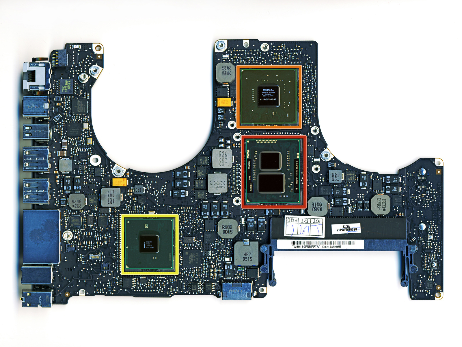

As I said above, the GPU and CPU sit on the "upper" side of the fiberglass logic board, both of which sit in between the two cutouts that house the fans. The main source of heat dissipation are clearly the fans.
1od1riLKYqR5mDDO.huge
(The orange and red boxes denote the graphics card and processor, respectively. Source.)
lECoqwOfdSQKosy4.huge
QunN3ZtAqxdJCjqW.huge
Hmm... so should i unscrew the mbp to check if the 'plastic' is in place? But I can't seem to spot the plastic in the pictures though...
