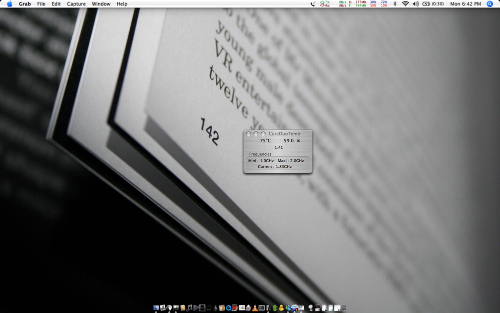

Sitting this on your chest..yeah right. This is the temp of the CoreDuos, but you can ballpark how hot the case is.
75 degrees Celsius = 167 degrees Fahrenheit
