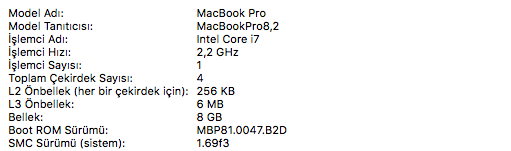

I will try to upgrade beta of 10.12.4 now.
my Boot ROM ver: MBP81.0047.B2D
SMC ver (system): 1.69f3
[doublepost=1489079278][/doublepost]fingers crossed. lets wait and see.

SMC ver is the same. Boot ROM different?
Boot ROM Sürümü: MBP81.0047.B32
SMC Sürümü (sistem): 1.69f3
Hmm, it seems we don't have quite the same machine. Mine is listed as an 8,3 not an 8,2:
Either way it seems to have fixed the problem. It has also gotten rid of a battery issue I was having too whereby my brand new battery was depleting rapidly and stating "service battery" that has now gone and I'm getting ~5 hours again.

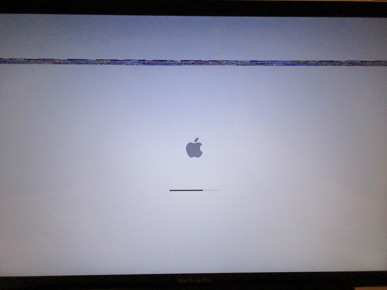

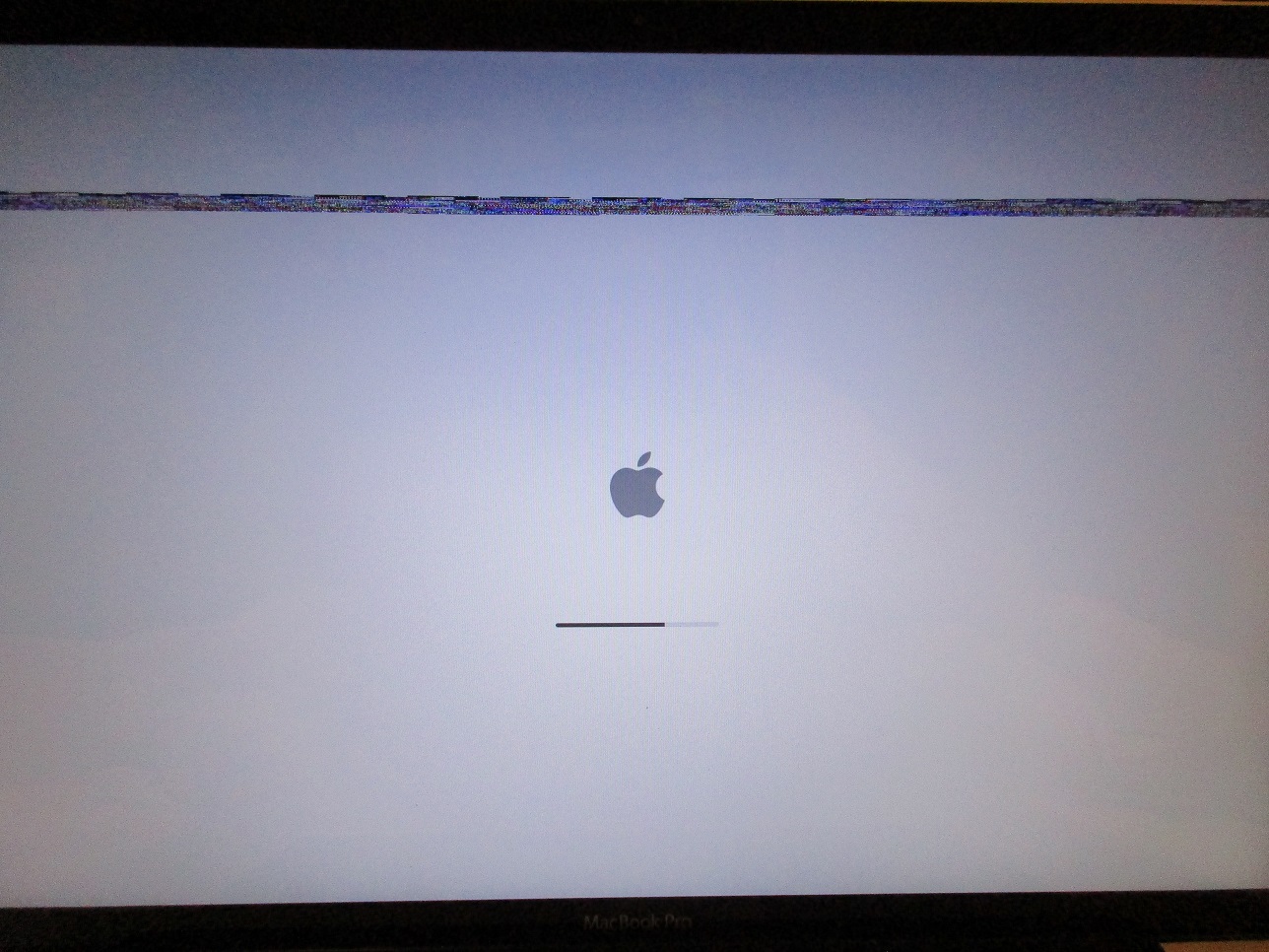

My early 2011 Macbook Pro 17 is displaying a strange graphical glitch as it is loading OS Sierra, at just the point before the screen goes black for a moment and the progress bar zips across to the end (as normal). I've uploaded a photo of it with this message.
The machine has passed the extended AHT and I've not seen problems with it elsewhere, but in truth I do not use it much. I'm worried because I've not seen this on my previous Macbooks, and I know the GPU in the 2011 has a rather dubious reputation.
Can anyone shed any light on what this might be?

Do you have FileVault enabled? That can cause minor graphical glitches on some older machines at the white loading screen.
If you're getting glitches elsewhere when doing other tasks, then it's definitely the beginnings of Radeongate.
