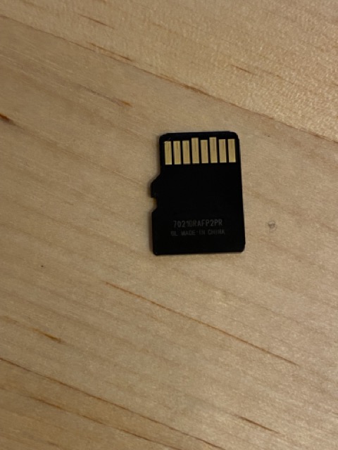

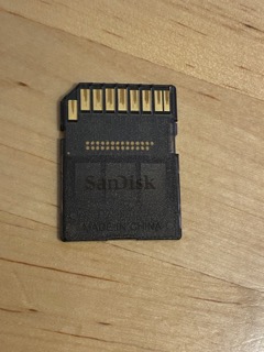

SD-CardSizeDid not copy allSlow Start, Errors, all files copiedOKSpeedOK in external reader or other mac

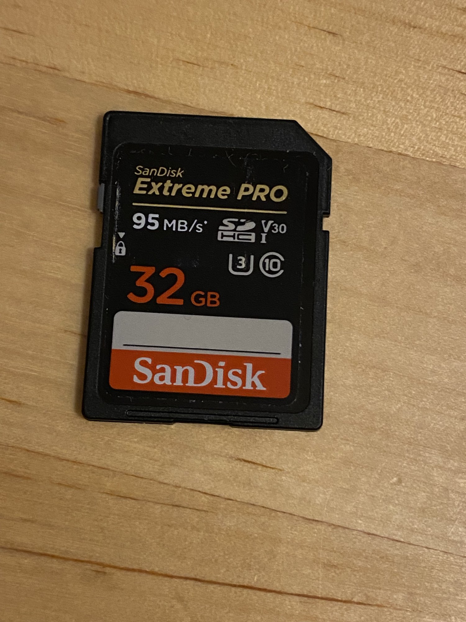

SanDisk Extreme Pro 95MB/s UHS-I U3 V30 SDHC Class 1032GBx
5.28M bytes/sec
Yes

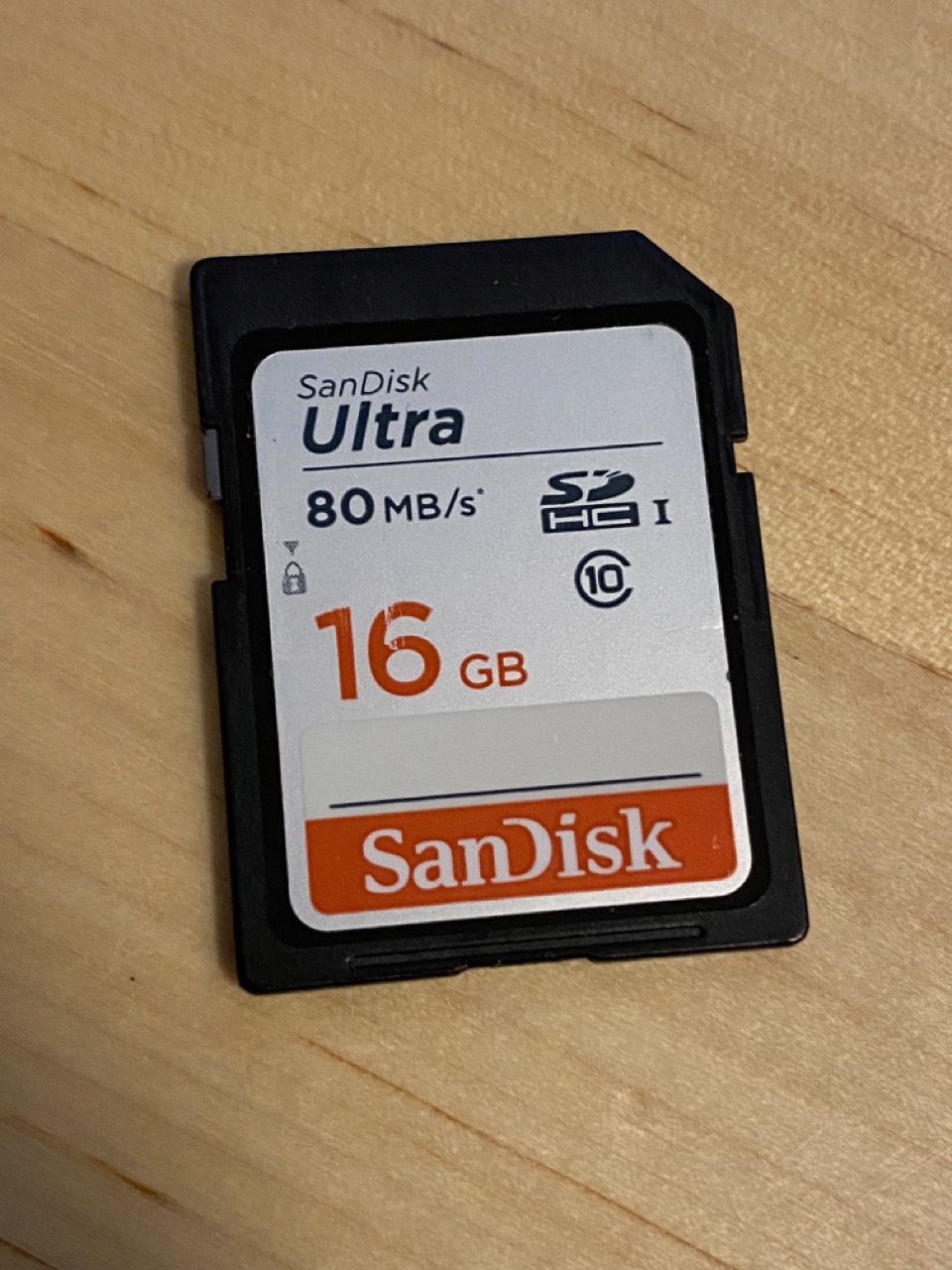

SanDisk Ultra 80MB/s UHS-I SDHC Class 1016GBx
55.52M bytes/sec
Yes

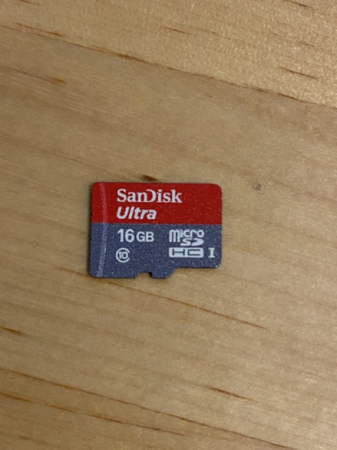

SanDisk Ultra UHS-I microSDHC Class 1016GBx60.95M bytes/secYes

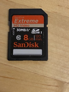

SanDisk Extreme HD Video 30MB/s UHS-I SDHC Class 108GBx
38.00M bytes/sec
Yes

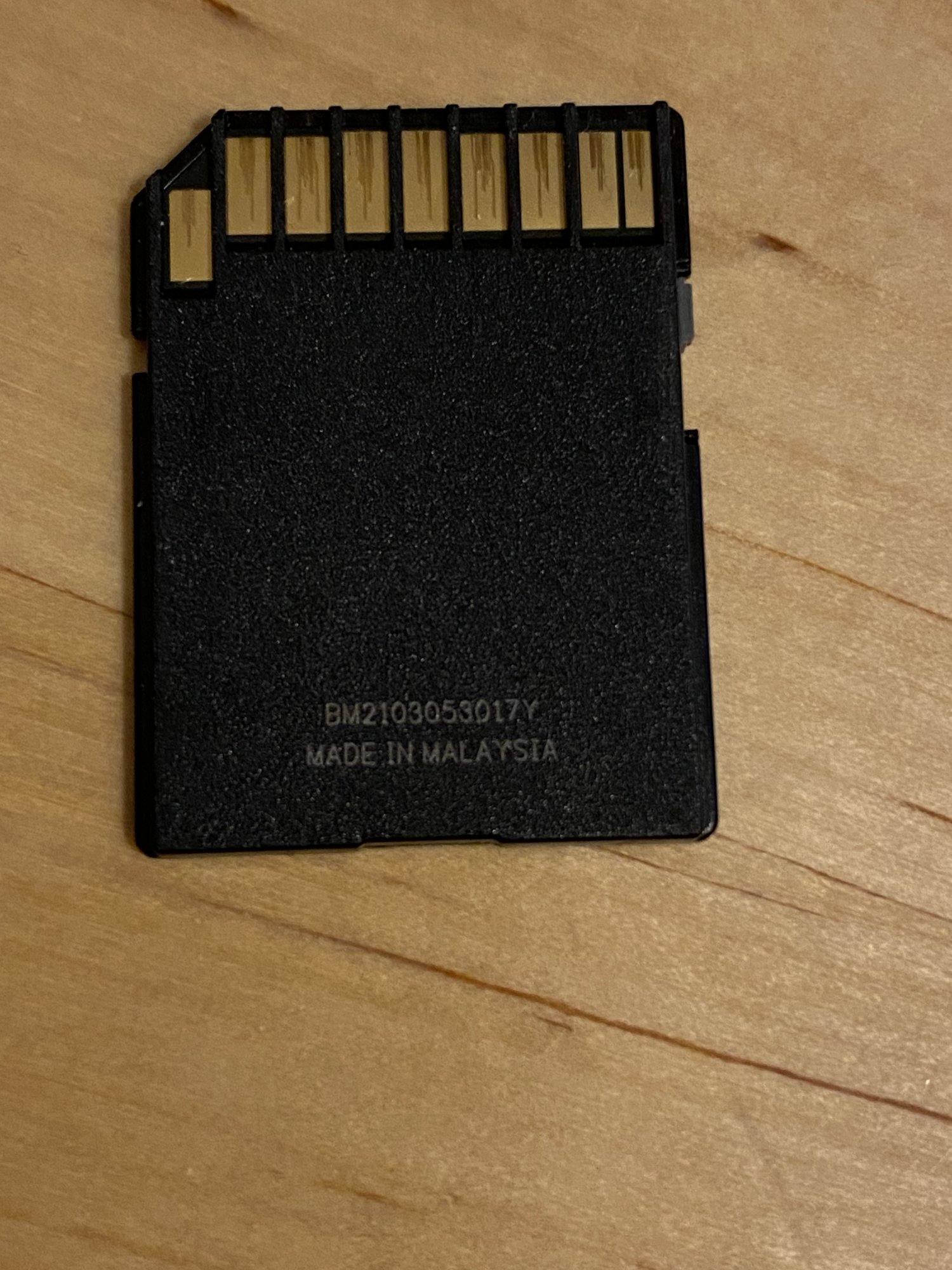

[ ]- Take a photo of the card front, upload it.
[ ]- Take a photo of the card back, upload it

No, there was a 1 minute+ pause before I got an error.
[ ]- When the terminal test finishes copy all the lines into your report.
Last login: Thu Dec 16 15:13:11 on ttys000
pb@M1Max ~ % /usr/bin/rsync -avE -h --exclude=".*" --stats --verbose /Volumes/NO\ NAME /Users/pb/test/SD-Card-Test
building file list ...
[sender] hiding directory NO NAME/.fseventsd because of pattern .*
done
delta-transmission disabled for local transfer or --whole-file
NO NAME/
._NO NAME
NO NAME/ALBM/
NO NAME/ALBM/ALB67ZZ1.BIN
NO NAME/DCIM/
NO NAME/DCIM/100OLYMP/
NO NAME/DCIM/100OLYMP/_1010001.ORF
rsync: read errors mapping "/Volumes/NO NAME/DCIM/100OLYMP/_1010001.ORF": Operation timed out (60)
NO NAME/DCIM/100OLYMP/_1010002.ORF
NO NAME/DCIM/100OLYMP/_1010003.ORF
NO NAME/DCIM/100OLYMP/_1010004.ORF
NO NAME/DCIM/100OLYMP/_1010005.ORF
NO NAME/DCIM/100OLYMP/_1010006.ORF
NO NAME/DCIM/100OLYMP/_1010007.ORF
NO NAME/DCIM/100OLYMP/_1010008.ORF
NO NAME/DCIM/100OLYMP/_1010009.ORF
NO NAME/DCIM/100OLYMP/_1010010.ORF
NO NAME/DCIM/100OLYMP/_1010011.ORF
NO NAME/DCIM/100OLYMP/_1010012.ORF
NO NAME/DCIM/100OLYMP/_1010013.ORF
NO NAME/DCIM/100OLYMP/_1010014.ORF
NO NAME/DCIM/100OLYMP/_1010015.ORF
NO NAME/DCIM/100OLYMP/_1010016.ORF
NO NAME/DCIM/100OLYMP/_1010017.ORF
NO NAME/DCIM/100OLYMP/_1010018.ORF
NO NAME/DCIM/100OLYMP/_1010019.ORF
NO NAME/DCIM/100OLYMP/_1010020.ORF
NO NAME/DCIM/100OLYMP/_1010021.ORF
NO NAME/DCIM/100OLYMP/_1010022.ORF
WARNING: NO NAME/DCIM/100OLYMP/_1010001.ORF failed verification -- update discarded (will try again).
total: matches=0 hash_hits=0 false_alarms=0 data=446047088
Number of files: 28
Number of files transferred: 25
Total file size: 426.47M bytes
Total transferred file size: 446.05M bytes
Literal data: 446.05M bytes
Matched data: 0 bytes
File list size: 473
File list generation time: 0.006 seconds
File list transfer time: 0.000 seconds
Total bytes sent: 446.10M
Total bytes received: 594
sent 446.10M bytes received 594 bytes 5.28M bytes/sec
total size is 426.47M speedup is 0.96
rsync error: some files could not be transferred (code 23) at /System/Volumes/Data/SWE/macOS/BuildRoots/5b2e67f8af/Library/Caches/com.apple.xbs/Sources/rsync/rsync-55/rsync/main.c(996) [sender=2.6.9]
pb@M1Max ~ %
[ ]- From Apple menu (Apple in the menu up to the left) choose About this mac. In Overview click System Report. You see Hardware at the top. Go down to Card Reader. Copy ALL the text into your report.
Built in SD Card Reader:
Vendor ID: 0x17a0
Device ID: 0x9755
Subsystem Vendor ID: 0x17a0
Subsystem ID: 0x9755
Revision: 0x0001
Link Width: x1
Link Speed: 2.5 GT/s
SDHC Card (Class 10):
Product Name: SDSP32G
Manufacturer ID: 0x03
Revision: 8,0
Serial Number: 2277460708
Manufacturing Date: 2021-01
Specification Version: 3,0
Capacity: 31,91 GB (31 914 983 424 bytes)
Removable Media: Yes
BSD Name: disk4
Partition Map Type: MBR (Master Boot Record)
SMART status: Verified
Volumes:
NO NAME:
Free: 31,48 GB (31 475 302 400 bytes)
Capacity: 31,91 GB (31 910 789 120 bytes)
Writable: Yes
File System: MS-DOS FAT32
BSD Name: disk4s1
Mount Point: /Volumes/NO NAME
Content: Windows_FAT_32
[ ]- If you got another older mac or external reader, do you get the same problem?
No. Works in 2015 MacBook Pro and Satechi external reader.
No problem
[ ]- Did the photos copy in an even stream?
Yes
