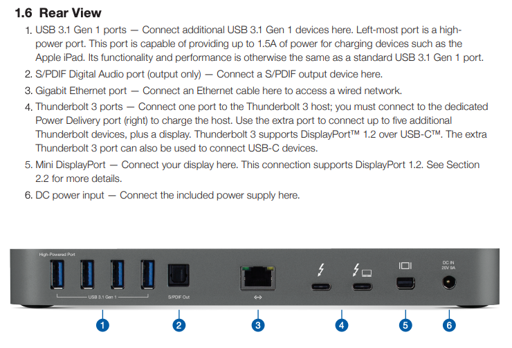

Rear Configuration (Picture from manual included for reference):​
  • Host machine connected to the dedicated Power Delivery port (4-right) using included Thunderbolt 3 Cable
  • Acer Monitor connected to the extra Thunderbolt 3 port (4-left) using Display Port to USBC cable
  • Dell Monitor connected to Mini Display Port (5) using Display Port to Mini Display Port cable
  • Ethernet connected to Gigabit Ethernet Port (3)
  • Acer Monitor USB Hub connected to High Powered USB 3.1 Port (1-far left)
  • Logitech Webcam connected to USB 3.1 Port (1-second in from the left)
  • 3rd Party Keyboard connected to USB 3.1 Port (1-third in from left)

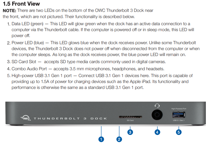

Front Configuration (Picture from manual included for reference):​
  • Logitech G733 Headset receiver connected to High-power USB 3.1 Gen 1 Port (5)
  • Audio cable connected to Combo Audio Port (4)
Issues:​
Monitor Wake Issues​
When host machine is sleeping and then wakes up, only the monitor connected to the extra Thunderbolt 3 Port via DP to USBC cable wakes, and the monitor connected to the Mini Display Port remains dark (does not detect any input from dock).
What Resolved the Issue
  • unplug the mini display port from dock, and plug back in
  • unplug thunderbolt 3 cable from host machine, and plug back in
  • Disconnect monitor plugged into dock's extra Thunderbolt 3 port, and connect it directly to host machine (with other monitor still connected to the dock via Mini DP, and the dock still connected to host machine)
What Did Not Resolve the Issue​
  • Reboot host machine (works sometimes, does not work others)
  • Connect the dock to host machine using one of the host machine's other Thunderbolt Ports (tried all 4)
  • Turn the monitor that did not wake off and then back on
  • replace original thunderbolt 3 cable connecting dock and host machine with generic brand thunderbolt 3 cable
  • replace original thunderbolt 3 cable connecting dock and host machine with high quality thunderbolt 3 cable
  • replace original DP to Mini DP cable connecting Dell monitor and Dock with new DP to Mini DP cable
  • Change Monitor Configuration (ie. connect Acer monitor to dock's Mini DP port using DP to Mini DP cable, connect Dell monitor to dock's extra Thunderbolt 3 port using DP to USBC cable)
    • The monitor connected via Mini Display Port continues to remain dark when host machine wakes.
  • Change host machine configuration (ie. connect host machine to extra Thunderbolt 3 port, and connect Monitor to extra Thunderbolt 3 Port
  • Update host machine to latest OS
  • Update host machine's graphics drivers with latest
  • Install OWC Dock Ejector software
  • Update Dock's Firmware
    • N/A, from what I could find this is not possible.
  • use a different OWC Thunderbolt 3 Dock (slightly newer model)
    • had the same issue
Have yet to try​

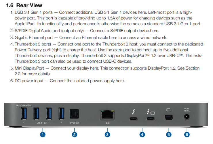

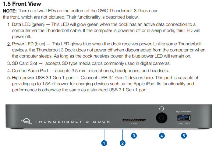

Issues:​

Peripheral Issues​
When on a call (Slack/Discord) using Logitech G377 Headset, my voice becomes staticy/robot-like, or cuts out entirely for participants.
When on a call (Discord) using Razer Man O'War, participant's voices will suddenly become staticy and their volume will increase to unpleasant levels.
  • Use a wired USB headset
  • Use a wired audio jack headset
  • Plug wireless headset receiver directly into host machine
  • update Logitech G377 Headset's firmware
  • update Razer Man O'War Headset's firmware
  • Reboot Slack/Discord (works initially, but issue comes back shortly)
  • Reboot host machine (works initially, but issue comes back shortly)
  • Move wireless headset receiver to different USB 3.1 port on the dock (tried all ports)
