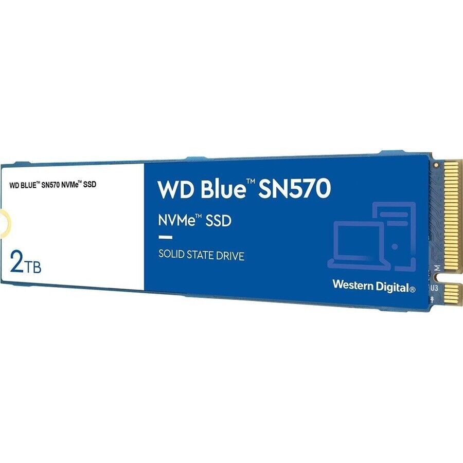

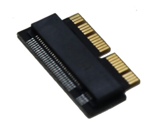

Go with the Western Digital Blue SN570 2TB NVMe M.2 storage drive. With a Syntech adapter you will see average read/write speeds on your Mid2015 15 inch MBP of around 2500mb/sec. This is what I am seeing with my Western Digital Blue SN570 2TB storage drive installed in my Mid2015 MBP.
The Western Digital storage drive is the best bang for the buck.

Thanks so much! Two follow up questions: 1. I assume I need an adapter with this. Should I get the full length on or the one that just goes on the end? 2. The SN570 is no longet available. Will the SN580 work as well?
Get this while you can:
The Western Digital Blue SN 570 2TB open box:
and the Syntech adapter needed to install the Western Digital NVMe SSD into your Mac (assuming it is a 2013 or later model):
Get these items and you should be good to go.
