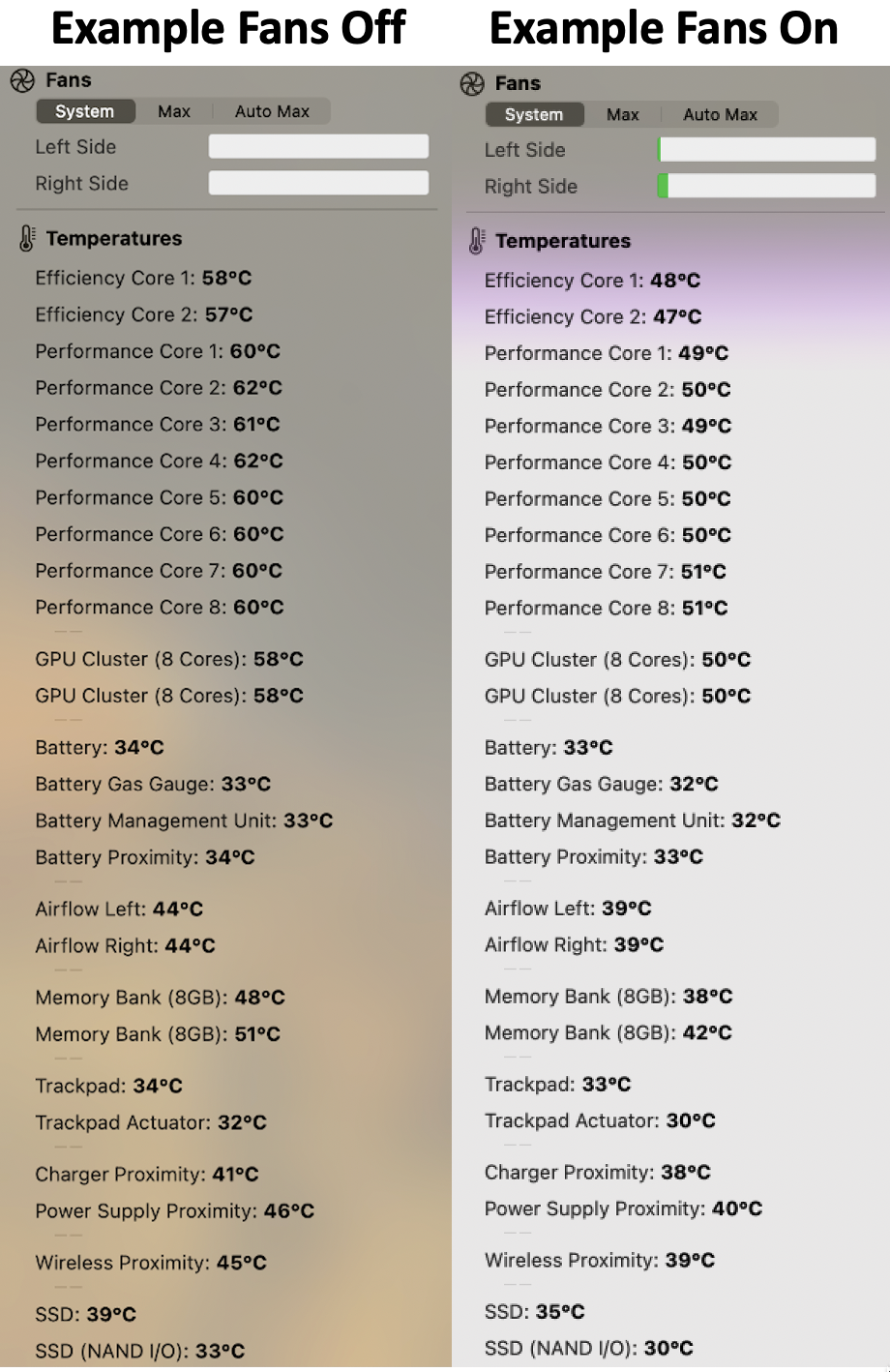

I bought a 16’’ MacBook Pro (M1 Pro) with the conviction that while performing light office work it would operate without a fan. While, for some time, it seemed to work that way (except during calls using Teams), now in the Summer it often spins up the fans (although never beyond an average of 1500 rpm).
So I bought TG Pro in order to create a custom fan curve that would activate the fans only when the SOC reaches higher temperatures (usually the fans kick in around 50º). I do not care that the SOC throttles, in fact I would have bought a 15' MBA if that was available.
Before I start messing with the fan curves, I would like to understand what criteria does the default Mac fan management use to activate the fans. It certainly isn't the SOC temperature alone because it sometimes goes near 60º and the fans do not spin up.
Can anyone shed any light on the default fan curve? Is anyone using a custom fan curve in order to keep the fans off more often?
When the fans spin up, usually the CPU usage is somewhere between 10% and 15%.
I don’t think that there’s anything wrong with my specific unit, I just need some insight on how these 2021 Macs manage the fans in order to safely create a new fan curve allowing for a more silent usage.

Weird. I just checked mine and quickly moving from photo to photo in Lightroom got the average temp up around 70 with fans off. I then started a render and it took until a little above 90, with a few of the performance cores in orange, for the fans to come on. I'm not doing anything custom with it.

Are the fans that audible to you that they are causing issues? If so, you must be in an extremely quiet environment with a very low level of background noise unless the fans are spinning very fast, but according to your graph they are spinning at minimum speed. For comparison, my Mac Studio fans run whenever the system is on at around 2100-2300 rpm and are inaudible to me sitting right in front of the unit. If I put my ear right up to the exhaust vent on the back, I can hear a slight whooshing of air, but no actual fan noise.

From your temperature listings above, it looks like with the fans on at minimum speed, you temps average about ten-degrees cooler than with them off. Isn't that a good thing? It's the heat that is generated by the components that over time tends to kill them, so less heat is usually better for the system.
