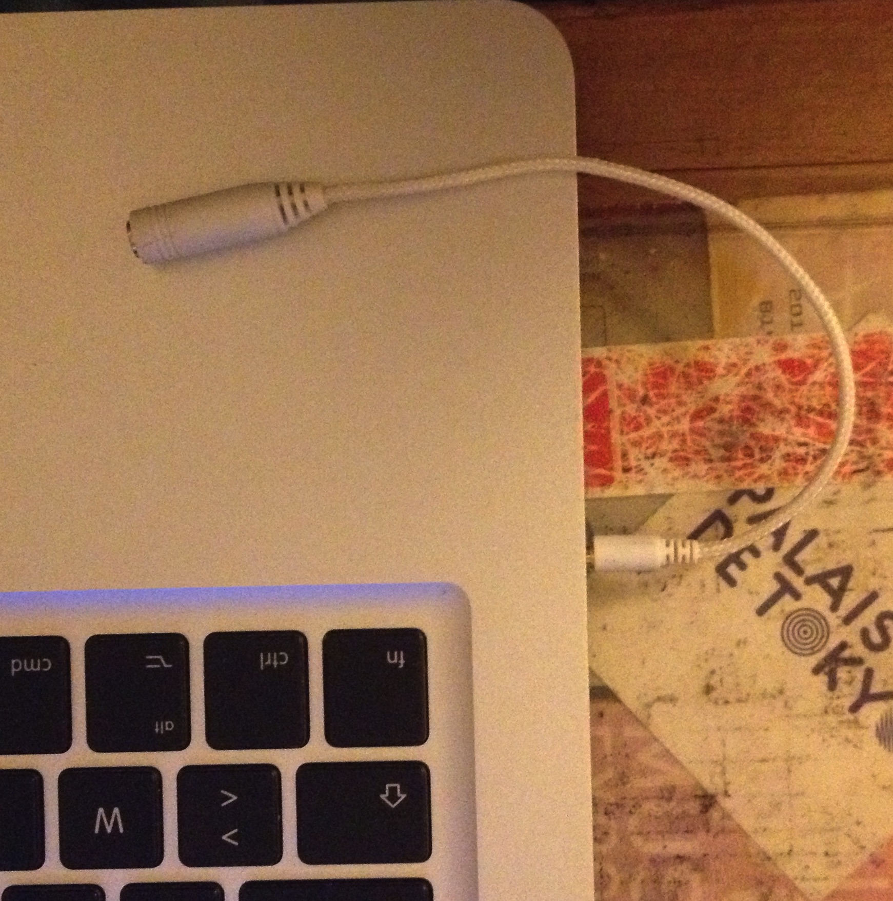

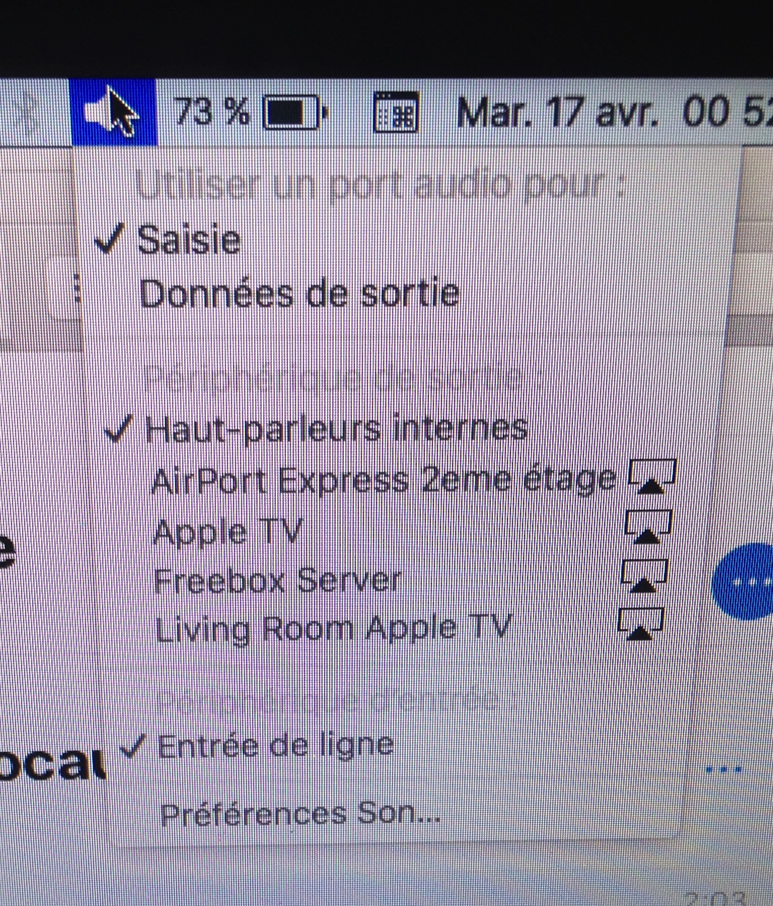

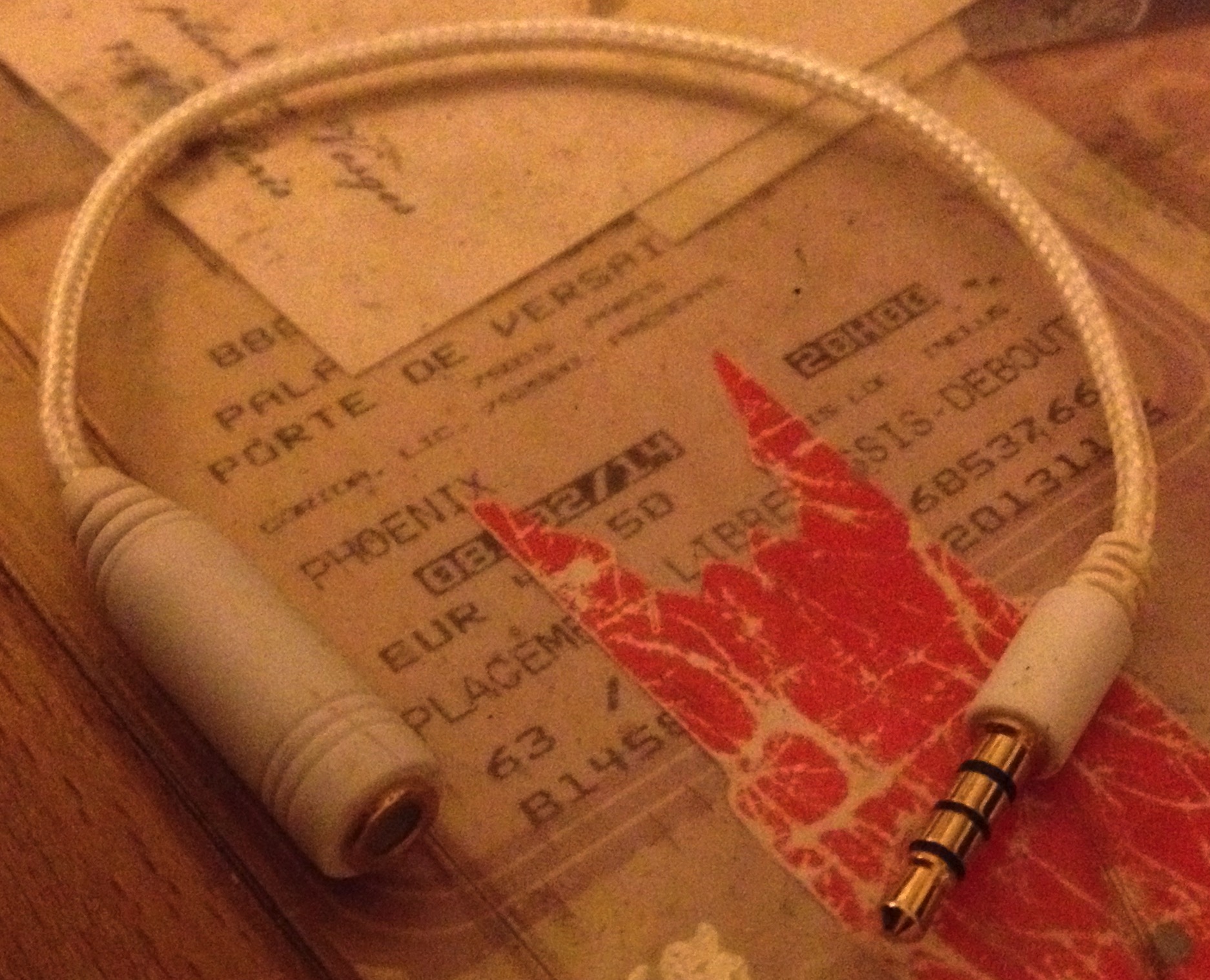

For me nothing Worked (toothpick and any other thing so I found a little jack cable female and male and with it inside i can choose internal speakers (alt+click on sound) and it's working... 10 years and only this solution for me (EL CAPITAIN mb Pro 2011)
