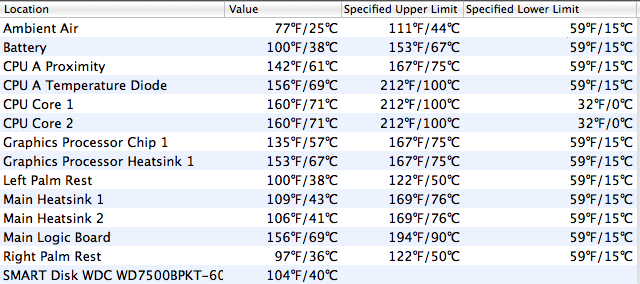

Overtemp Shutdown Report
Here is a screen clip of the temps when lines started showing up on my screen. The computer froze a few seconds after I took it.

I think you have something else going on, as these temps are well within the operating range, with the CPU just below 70C. I have a 2.4Ghz C2D 15" MBP 4.1 and it easily copes with CPU temps around 100C. Does the machine feel overly hot to the touch? If you were hitting the three figure mark the symptoms would be more understandable at 70C it not temperature unless the system has a hardware fault, bearing in mind that your Mac is now getting on a bit.
