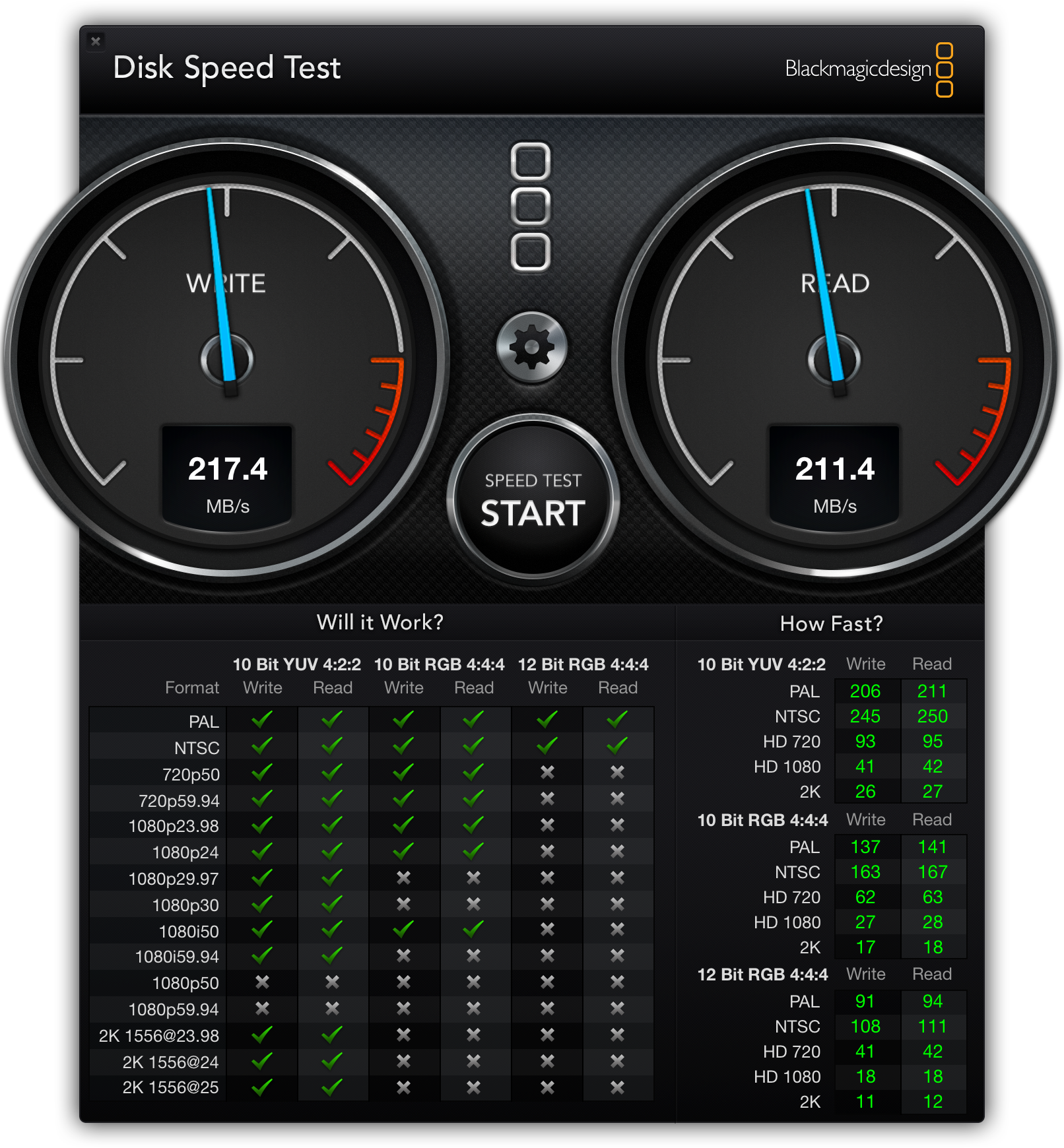

Slow RAID 0 on MacBook Pro 13" 9,2
Hi all.
I would need some help for the configuration of my new MacBook Pro RAID 0 setup.
Recently I bought the non retina MacBook Pro 13" with i7 2.9 Ghz, 750GB HDD and 8GB RAM. I purchased a data doubler from eBay, not the OWC one, just a common Chinese product for the DVD Superdrive tray. Then I' got two Samsungs SSD 840 PROs 512 GB to put in RAID 0. I did the RAID 0 setup and a clean MAC OSX install through the 750 HDD that I took out, and what I get on Blackmagic speed is something ridiculous slow like 130 MB/s in write, and 350 MB/s in read speed. 🙁
I haven't tried enabling TRIM, I tried to update the SSDs firmware, but the MacBook Pro was giving me some weird message that there is no bootable disk on the system. I was booting from the CD, so I don't know what could be wrong in that? I tried the same CD in my older MacBook Pro mid 2009, and the CD worked fine. 😕
Maybe I did something wrong?
Can you give me a few suggestions how to improve the speed? It should be over 900 MB/s in both read and write...

Give it some time. Maybe your MacBook was still initializing. It had the same issue, but when i tried the next day it was amazingly fast, much faster than the day before.
I hope so...

Okay just making sure it wasn't an older model and sata 2 or something. Knew it was a longshot because they switched to sata 3 in the 2011 models. Last ones to have sata 2 was 2010 models.
I have the exact one and running a 840 Pro at 480 write/520 read so I have no idea what could cause your problem besides one is faulty and causing slow speeds.
Have you tried un-raiding them and doing a speed test on each one separate?
Thats what I would do.

I will definitely try all the suggestions, until I get a reasonable explanation. First, I'm going to update firmwares on both of them, then I'm going to enable TRIM, then I'm going to leave them for a couple of days and try to work like that, and if I still get slow readings, I'll try to unraid them, restore MAC OSX on each one of them and test them individually. I need to come up with something. I just hope it is something wrong with the software.😕

Hi.
That's me back home and restarting the RAID 0 performance checks. I managed to upgrade to the latest firmware today, and I installed TRIM and enabled it. The situation now is a little better, but just a little. Write speeds are around 240 MB/s, and read around 550 MB/s. I am wondering now if it the block size counts. I didn't change it, and by default was selected on 32 kB. Is that too small? Can it be the reason why I get low write speeds?
Please, any suggestions would be great appreciated. I don't want to strip the SSDs one by one, and test them individually by reinstalling the OS back on from beginning. 🙁
