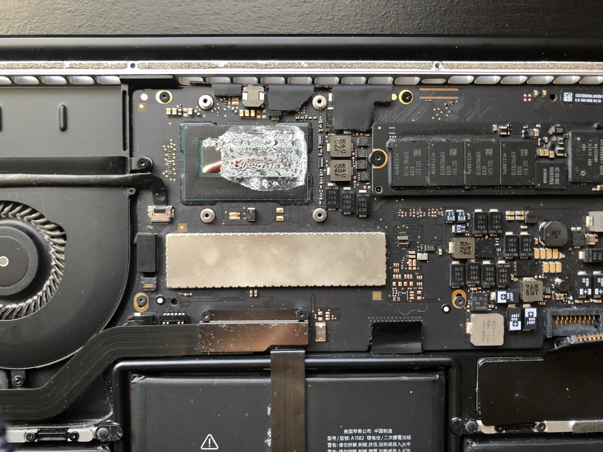

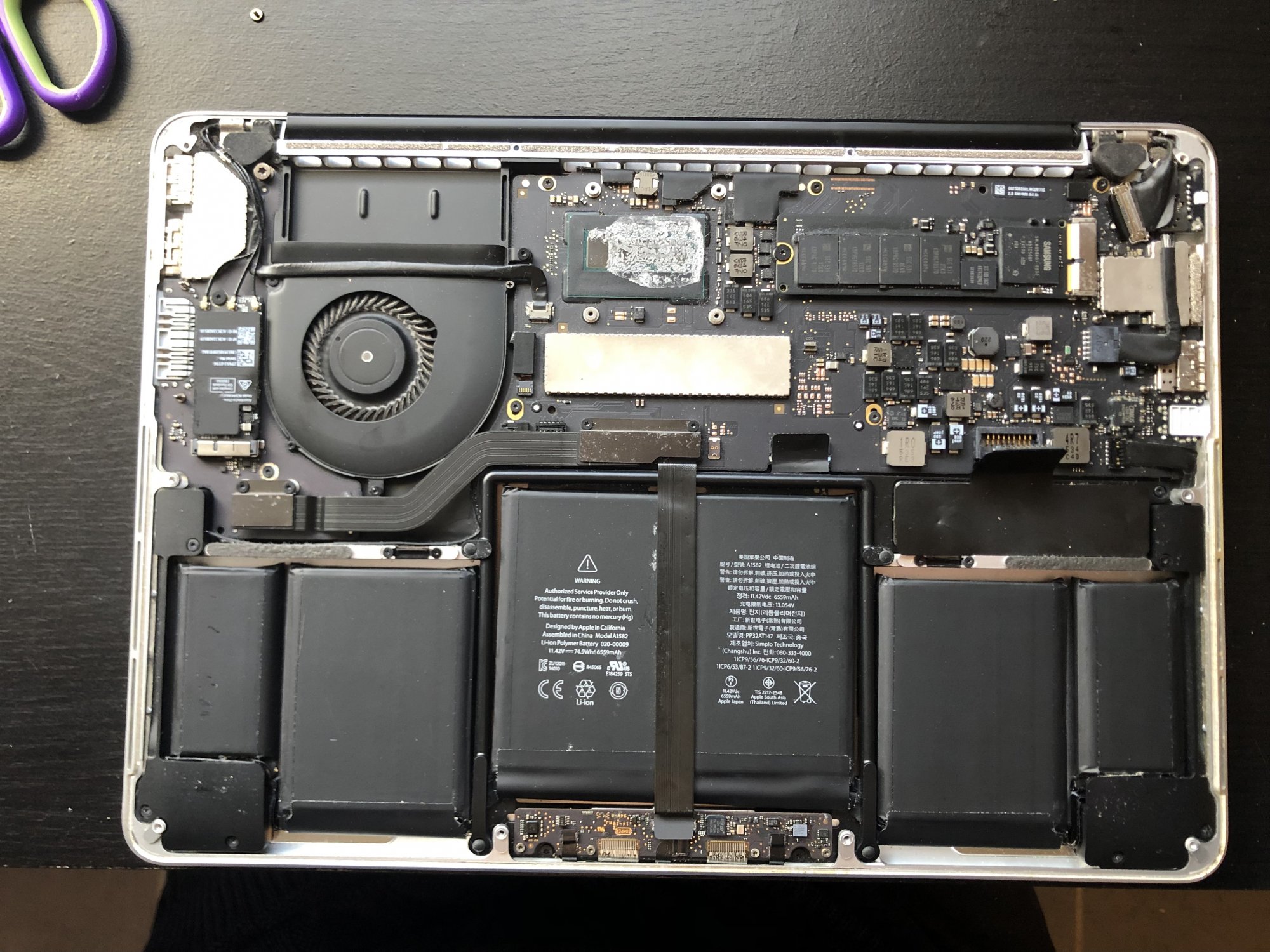

Hi everyone. I am trying to troubleshoot my MacBook Pro (Retina, 13-inch, Early 2015). I’ve had this laptop since 2016 and it just won’t turn on.
I’ve tried all of the keyboard reset prompts (NVRAM and SMC).
I’ve unscrewed the back panel, unplugged and replugged the battery connector, pulled out and reinserted the SSD and still no luck. When I plug in the mag safe charger, the light stays orange.
There is no start up sound or lights and I cannot hear the fan whirring.
Do I need a new battery? Do I need a new logic board?

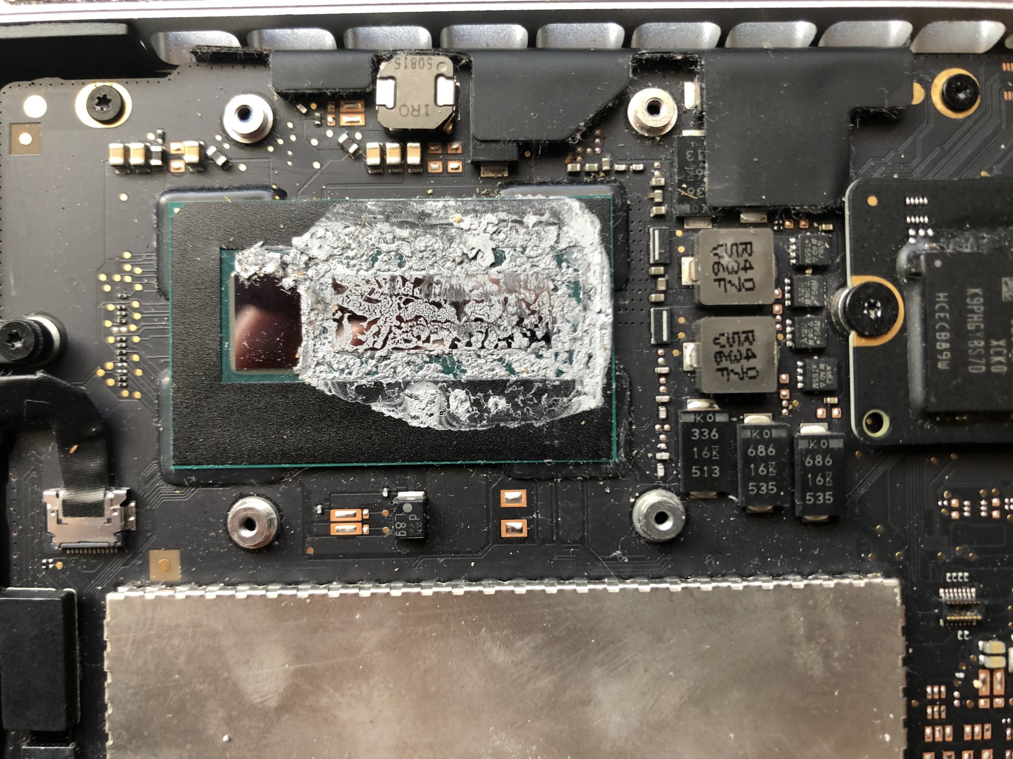

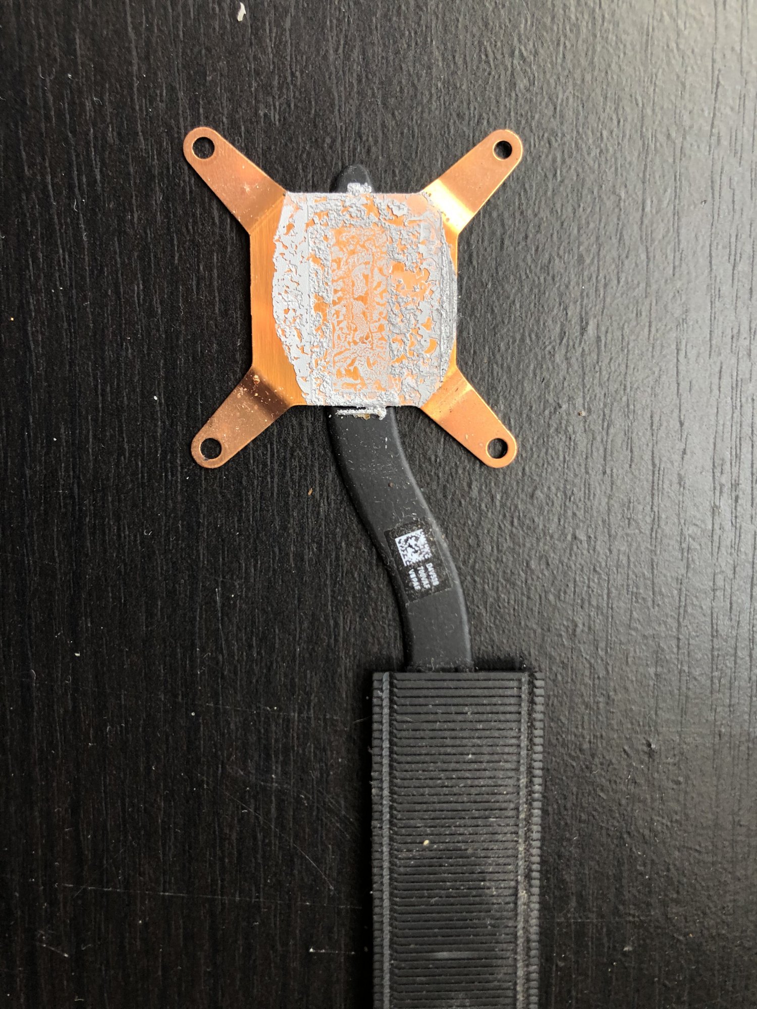

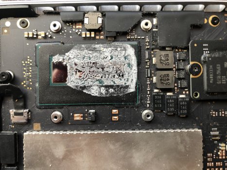

I took some pictures of the heat sink as well. If I cleaned the heat sink and reapplied the thermal paste, would it help?
Is it worth replacing the battery and the logic board? I don’t really have the money to buy a new laptop at the moment.
Any advice is very much appreciated.

Did you remove the heatsink for a particular reason?
Any loose connections?

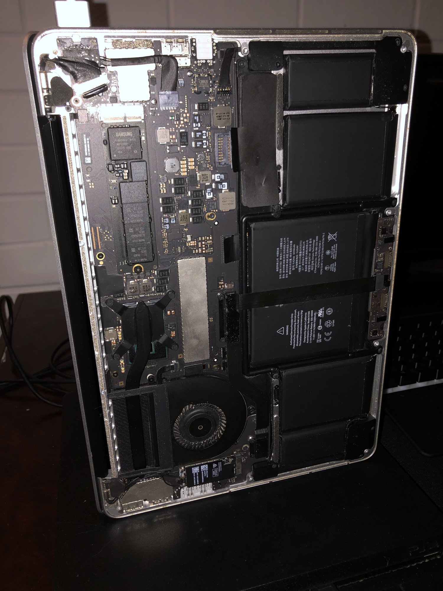

Disconnect the battery, leave the bottom cover off, stand the MacBook on its side, connect the charger, look at the inside of the MacBook, don't press any keys, wait about a minute to see if the MacBook powers up on its own and whether the fan spins.
Reactions: Macdctr
No need to apologize.
Thanks for your patience. I’ve followed your instructions but unfortunately the fan is not turning and the MacBook has no signs of life…

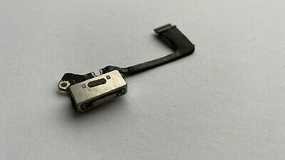

Have you tried disconnecting the MagSafe 2 DC-in board from the logic board then try rebooting off the battery? Since the MagSafe connector from your charger is not lighting up orange (charging) or green (charged) then perhaps this board is bad and causing your issue? Would not hurt to disconnect this from your logic board and see if you can get your laptop to boot.
The MagSafe 2 DC-in board looks like this...
Hi thanks for your advice! I’ve just tried this and unfortunately the laptop still won’t boot.. I’m thinking that there is a serious problem with the logic board. Unfortunately I don’t have the skills or money to fix it at the moment. The laptop is quite old now, I’m not sure if it’s worth spending $500 to get it fixed. I’m thinking of saving up and buying a new MacBook Air.
