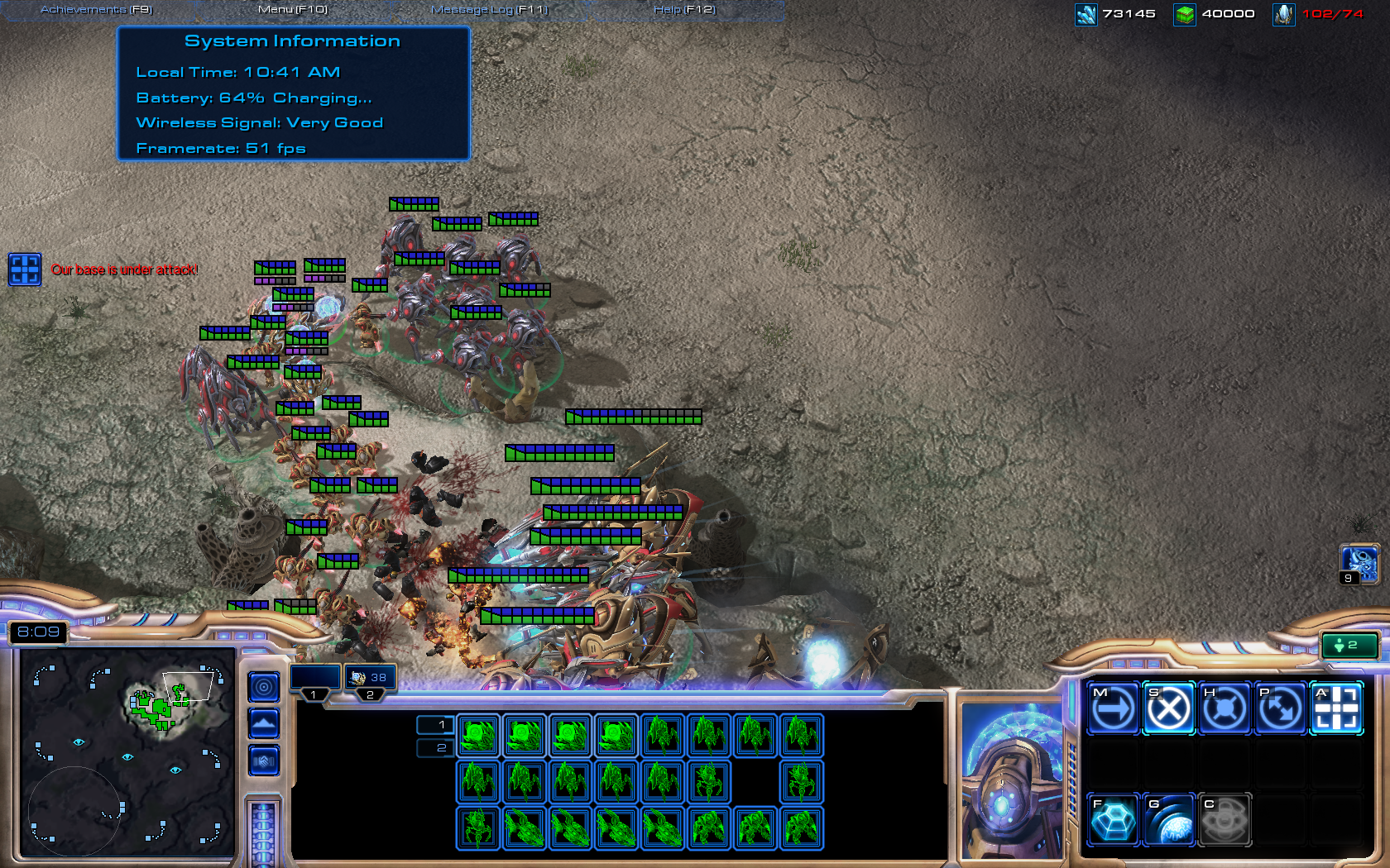

Here's ultra at 1680x1050: https://forums.macrumors.com/attachment.php?attachmentid=346979&stc=1&d=1341688612
Ran between 50-70fps, no lag.

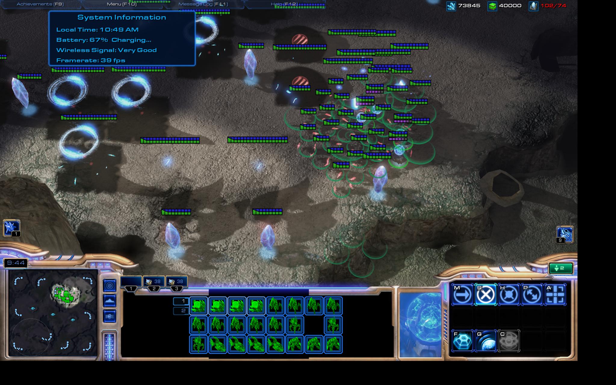

Here's ultra at 1920x1200: https://forums.macrumors.com/attachment.php?attachmentid=346980&stc=1&d=1341688686
This one was weird... It screwed up all the images, and went super messed up. Maybe it's just my computer acting up, but not sure why this happened...
