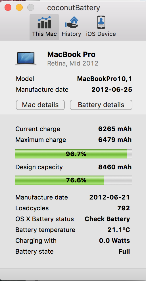

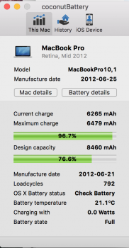

How many charge cycles do you have on yours? I've got nearly 800 cycles on a launch 2012 laptop so I'm not really complaining.
