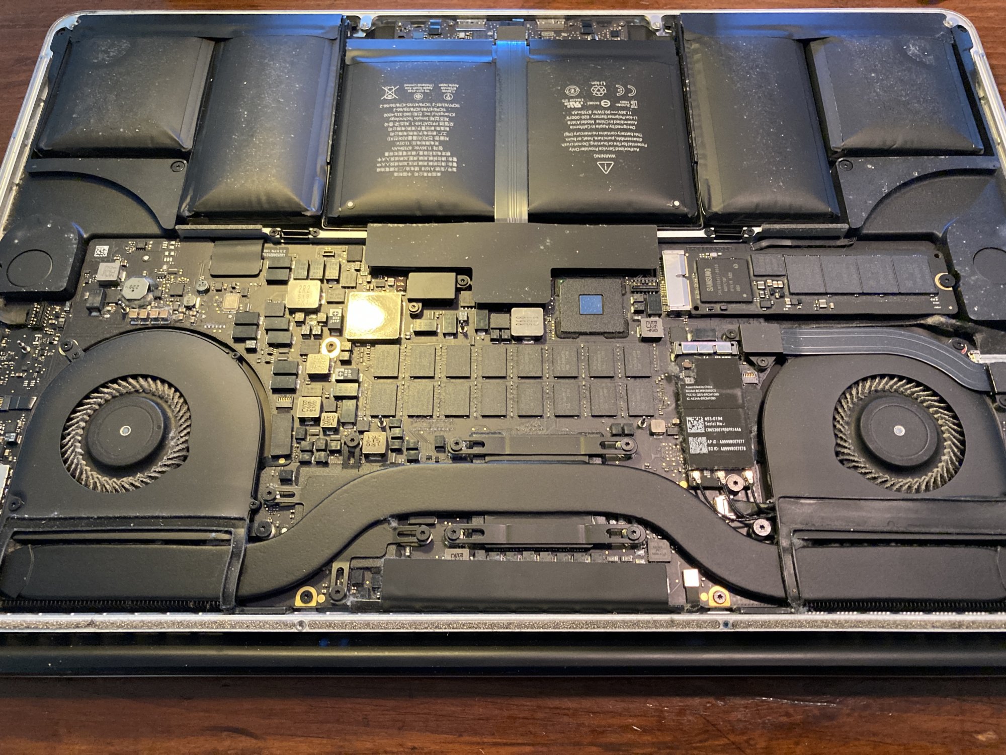

Just yesterday I dropped off my 2015 MacBook Pro 15" Retina at the Apple Store for a battery replacement. I bought it refurbed in 2018. The speakers had gone bad, so I replaced them two months ago (that was a journey), cleaned up the interior and redid the thermal paste on the CPU and GPU while I had the machine open. That was when I really noticed that the battery was swollen, so I knew it was time to replace it.
The Genius was super helpful, and surprised that I had switched out the speakers. Ran diagnostics that showed everything was working except the battery was in trouble. I showed him that the bottom of the case was being pushed out by the battery - the four feet weren't even touching the desk any more! And he showed me that the trackpad was also being pushed up, which I hadn't noticed.
So they're going to try to fix it on site, said it should take 3-5 business days. It will cost $199. If they can't fix it there, I'll bring it to a local repair shop that specializes in Macs, but I wanted to take it to Apple first.
Will update with the results!
Here's a photo showing the MacBook after I removed the case, but before I had replaced the speakers, done the cleaning, etc. You can see the puffy battery cells.

$200 is a very good price for a battery replacement. I spent $100 on the ifixit battery replacement kit just a few weeks ago. The battery in my late 2013 rMBP looked a lot like yours. It took a bit over an hour and now the computer sits flat on the desk again and the trackpad clicks like new.

Wow, hat-tip to you for undertaking that project. I looked at the same option and watched the video, and I really didn't like how difficult they made the battery removal look - all that isopropyl alcohol, all that prying and scraping. I thought I'd pay $100 more and have professionals do it, and not risk tearing a battery cell or ruining things some other way.
UPDATE - I got a call from the Apple Store today and they already had it repaired. It took less than a day. I ran over after work and picked it up. It looks great* - sits flat again, the trackpad is normal again. Would have loved it if this were covered under their battery replacement program, but I'm not unhappy with how things turned out.
*in addition to the battery, they replaced the top case, so I have a new keyboard and trackpad. The top case was damaged from impact when I bought it as a refurb, so it's in better condition now than it was when I bought it.

In my case, the battery removal went very well. I skipped nearly all of the "caution, this cable is extremely delicate" steps and used dental floss with just a few careful drops of the adhesive remover. I think it's probably a lot easier to remove a badly swollen battery than a new one, because the swollen battery has already done some of the work for you.
