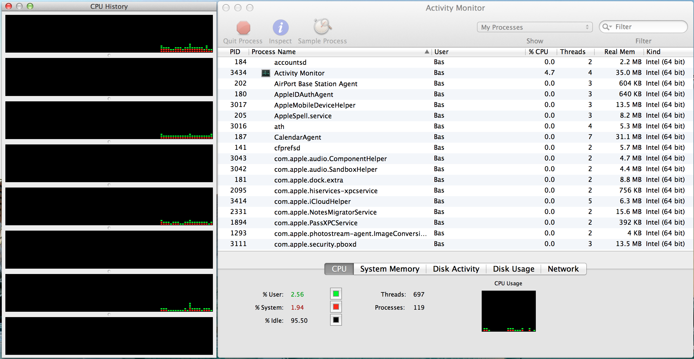

My first question is that the activity monitor shows 1 core...
should it not be 4 physical (8 logical) ??

activity monitor should show 8 cores. It should show all of the logical cores available, take it in and get it replaced

and on further inspection, if i go into activity monitor and show cpu history it shows 8 bars.

My laptop also so as one core in activities monitor.
You have to choose CPU tab and then double-click on the black square and it will show all of eight cores.

Activity monitor shows a combination of all cores, unless you specifically choose the floating CPU window.

Default it shows all cores combined in one graph.
In order to see all cores individually, go with your mouse on the CPU core window, and simply double click. Now you can see 8 cores 😉

as for the core thing that is no longer an issue, it turns out apple have just decided that on the 'dock' it will only show one bar, it just confused me at first.
