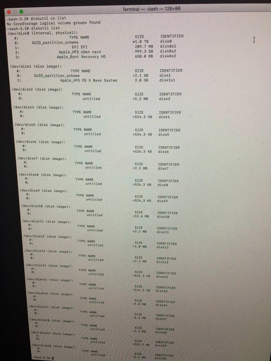

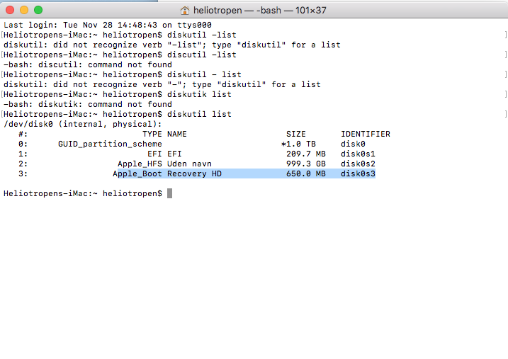

Before going further -- what, specifically, "broke" on the iMac's SSD?
Have you tried to "de-fuse" the drives inside, and then tried "working on them" individually?
Can you at least re-initialize the platter based HDD and boot the iMac using that?
I tried scanning your posts above, and you weren't clear on this.

1) I'm not sure what broke but yes - I don't think it's a fusion problem.
I talked to apple care (over the phone for a few hours actually) and they ran all kind of diagnotics and commands on it (most of it I had already tried myself) - and the ssd part of the drive seamed to be just gone. They ended up saying that the ssd part of the fussion is either dead (or needs to get replugged).
*See the attachments*
=> Otherwise I would have been fine unfusion it, since it was a 128gb version.
And yes the HHD part of the drive works just fine, that's what I'm booting on now: but that 5400 HHD is really slow.
2) I would not tear it open myself: if you look in the posts above you can see that I have gotten a few offers from local repair centers on it. - They don't want to offer me to replace the PCI-e SSD thought - apprently that's more work than just putting a an ssd in the SATA III slot and replace the 1 gb hd that is currently there.
The negative part of that is that I lose 1 gb storrage, but to be fair I have a 2 tb usb3 hhd that is about as fast as the internal, so won't be a huge problem.
3) Not sure about if I should go with the USB3 or the Thunderbolt - because the price will not be that much diffrent.
I get 500 gb on the usb3 for about the same price as the 256 gb Thunderbolt, not much saved in a 256gb usb 3 actually.
