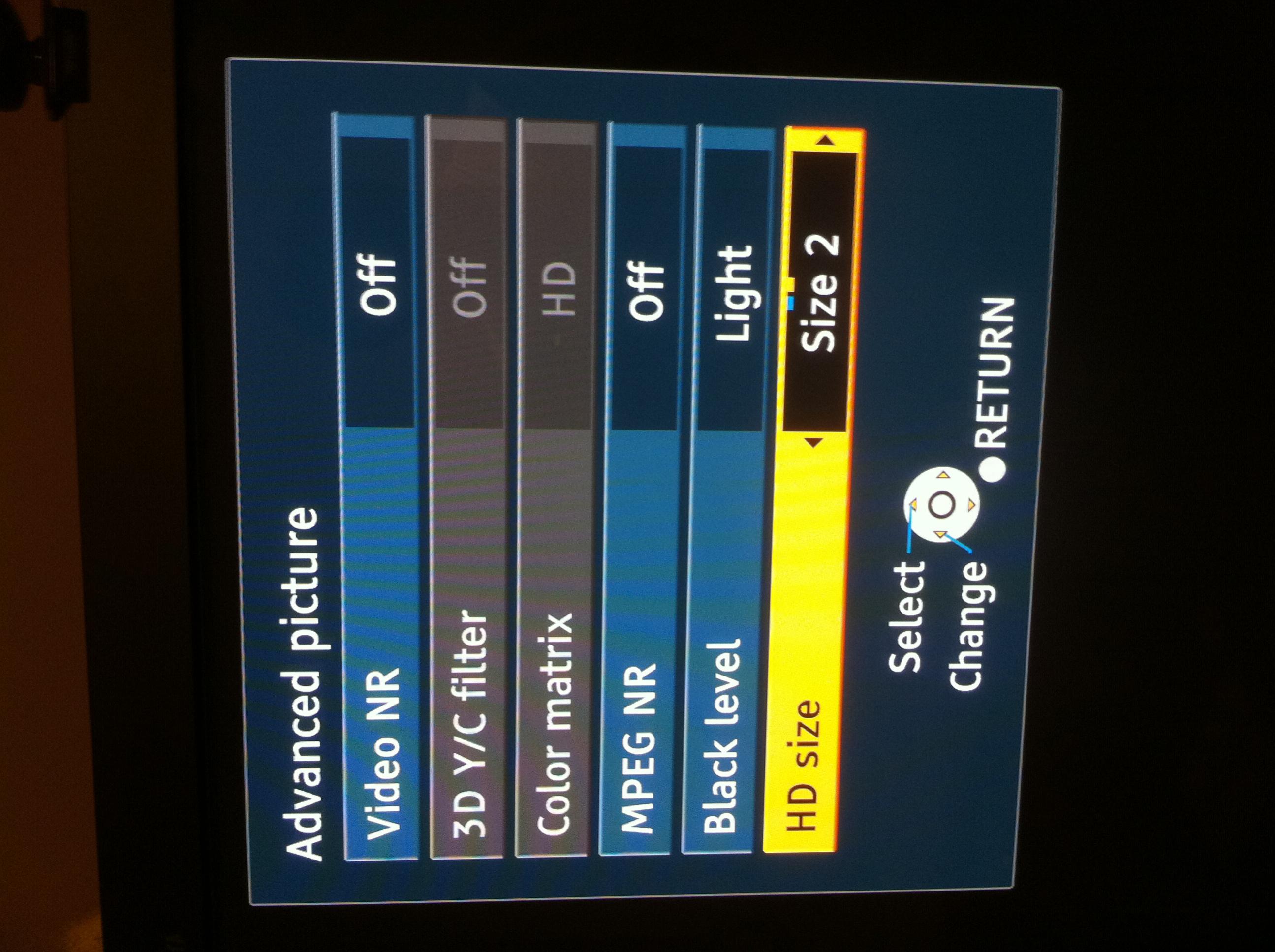

I'm posting from my phone so I can't see the screenshot, but:
I think what aznguyen is referring is the zoom, what I'm referring to is the pixel mapping. Networks broadcast with blanks along the edges of the video which is cropped by the tv (I believe this is the HD 1 setting) and the HD 2 setting is 1:1 pixel mapping - you'll want to use this with bluray players, game consoles, and most computers you connect over hdmi.
EDIT: Here's what you do:
Menu -> Picture -> at the bottom select advanced settings -> HD Size -> "size 2"
edit again: This is on my tv which is over 2 years old now, so the menus may have changed a little bit, but the option label is probably the same.

Did you check the "HD Size" option I recommended? I have a strong feeling that you're having the same configuration problem I had.
Such option isnt available on this panasonic plasma tv, im checking the manual and it says it will detect automatic if its 720 1080 etc 🙁
I think you're looking at the wrong option, it literally says "size 1" and "size 2" - this is different from the resolution.
Im looking at the exact menu you just posted and only difference is that mine is missing the last option 🙂 , bad luck i guess.
