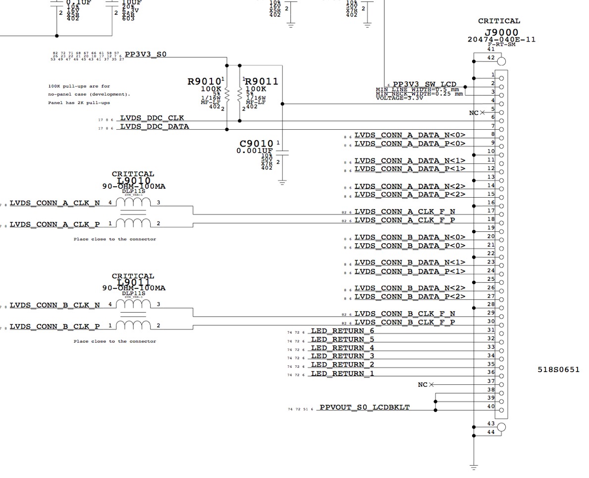

I haven't seen the pin out posted for the 15". I had another go yesterday, replaced the 2A fuse but no joy still no backlight. I was thinking of connecting an external supple of 18-27V to pins 38-40 to see if the led's war at least working. this way i could figure out if it is logic board side or screen side.
any thoughts?
i think someone posted earlier in the thread they managed to power up the leds this way. do you have the 27v on the motherboard? here is the pinout:

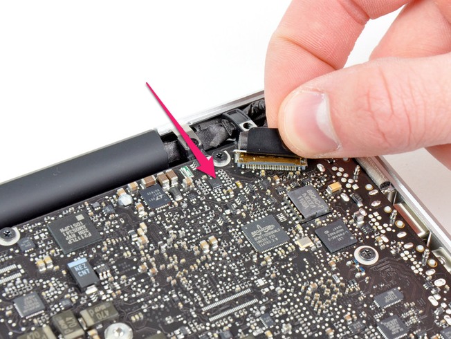

so mine blew due to the clip that holds the screen cable shorting on the back of the connector, the new one came better insulated:

Here is the 15" pinout.

Just wondering how is everyone measuring the voltage of the wled pins when the logic board is installed, it's not the side you can get too?
Thanks. Hopefully it won't come to removing the glass. I'm going to try another fuse now.
On the MBP 13" they are on the top side. On the MB Aluminum Unibody they are on the bottom.
When they are on the bottom I measure right at the pins of the LVDS connector. But I have very fine tip probes. I would not try that with large clunky probes.

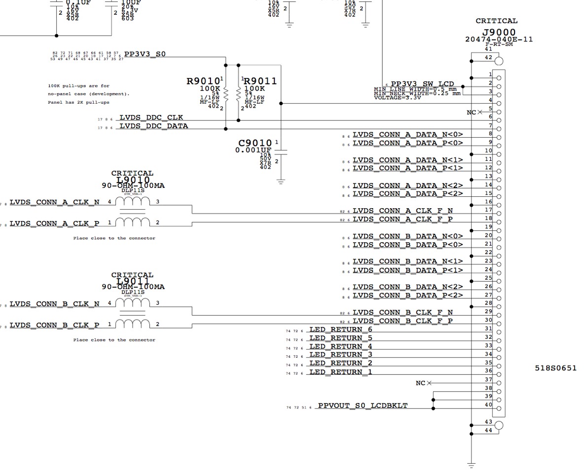

i got about 1v when the resistor was blown, changing the brightness level made a slight difference to the voltage also. did you check the cable and connector for shorts? with my old cable plugged in 39 & 40 were shorted to earth inside the connector.
you could try an external supply voltage to 39 and 40, remove the two caps maybe and connect it there. it risks doing more damage though. i don't know if the led return 1-6 would still carry the return current. psu voltage, 18.5v, should enough to get it to light up, with a small fuse eg 1a glass fuse in circuit for protection. it may be nescesarry to route the led return to earth also, maybe unsolder the resistors near the weld driver. of course its much better to get it working properly if you can, but if all else fails.
there are small voltage step up converters with adjustable output voltage, too big to go in the case but it could stick it on the lid in a box to get it usable again, or maybe take the optical drive out.
http://www.ebay.co.uk/itm/LM2577-DC-DC-Adjustable-Step-up-Power-Converter-Module-/280734840807
it could take power via the usb 5v or off the battery/12v supply inside.

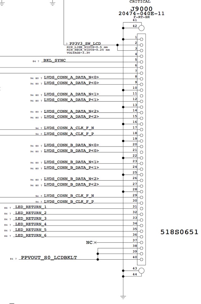

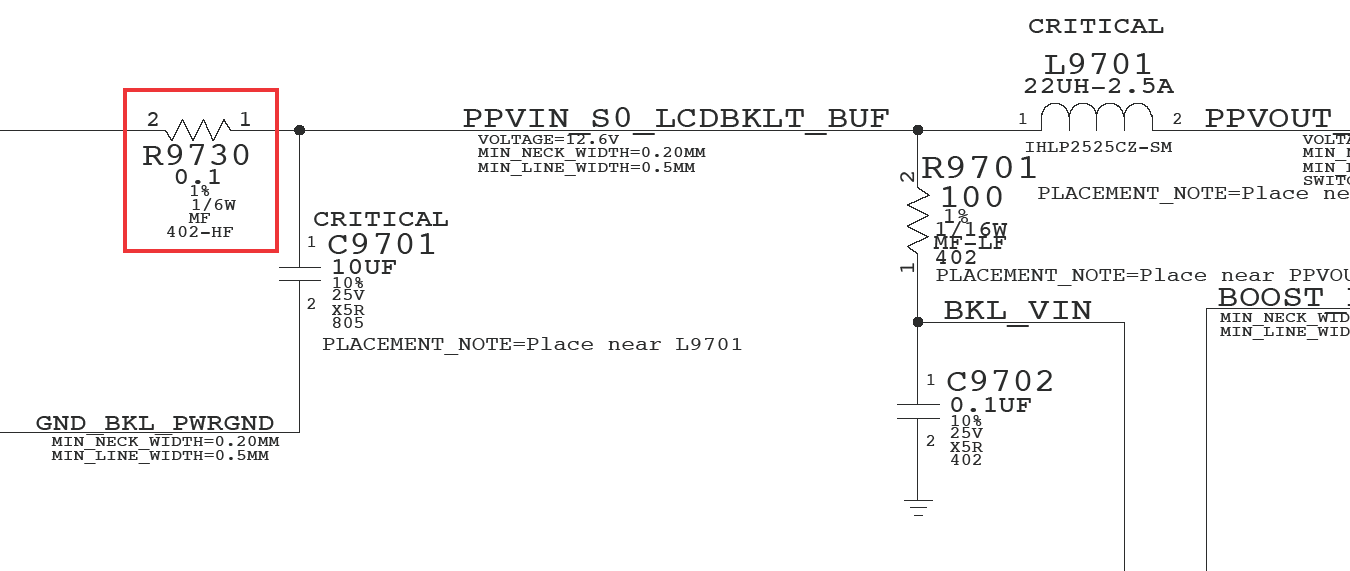

The schematic shows 2 X 0.4ohm 1% resistors. So that would make them 0.2ohms in parallel. If you can get a 0.2ohm 1% that would be about right. Never really considered putting through hole components on surface mount pads. There will be quite a strain on the solder pad so you need some good strain relief if you go this route. Obviously it would be better if you used SMT resistors but work with what you've got.
Good Luck
Good Luck
in the area where i soldered there is plenty of space, one side is on the edge of the square transformer thing, the other one has a dot next to where the resitor goes, but is on a big track. i could get a surface mount one though.
is is not R9730 shown here?
the two in parallel must be the pair next to each other in my pic ??

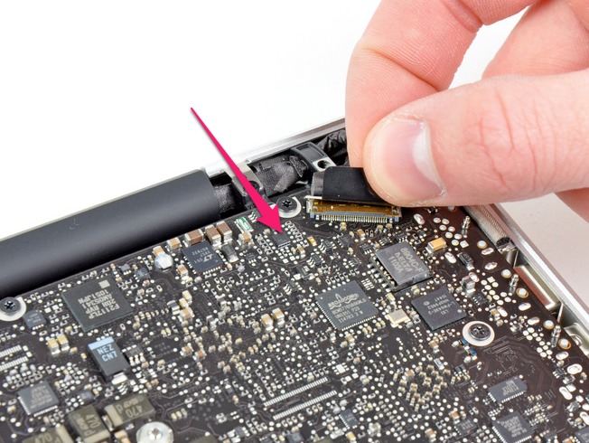

Hello guys,
My friends has Macbook A1278. He had spoiled coke on it. I cleaned it carefully,image is visible,but backlight isn`t working.I`m new to electronics,but I figured out that A2 0402 fuse isn`t open (I don`t know how to say it right in english,but multimeter in beep mode doesn`t beep 🙂 ). When I connected a with wire it both sides backlight appeared for a moment,then protection worked. And I detected that lcd connector has a burned pin,it was damaged before. So what I need to do?
Buy new cable and fuse? How to check l8545? Maybe some advices?
P.S. Which pin on video cable is for backlight? Because on my cable burned pin 10 or pin 20.
If you have the mbp13 then they don't use the pair of current sensing resistors. I am on the road right now so can't look in more detail. If you are talking about a single standalone resistor then you a probably looking at the one before the inductor as you indicated. The parallel pair are right beside each other on the board but they are only used with the APP001 circuit I think.

You definitely need to replace the lvds cable and the connector itself. Once you have replaced the connector check to make sure there are no shorts to ground on the backlight voltage before connecting everything back up.
I am not at home now to check but those look like about the right spot for the backlight voltage pins. There may be a connector Pinout earlier in the thread.

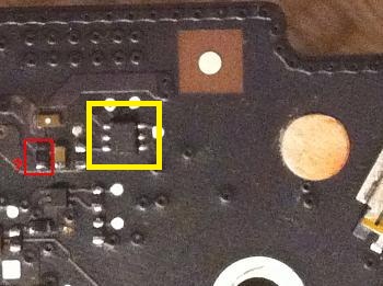

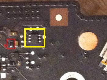

so which one is the WLED driver?
maybe have a look at this picture
Possibly the small black square package just down and to the left of the top mounting screw. Can you read the part number on top of that?
It says 15AK D68B
edit:
It is a 25 Pin Micro SMD (BGA) Package.
I suppose it's from National Semiconductors, maybe LP8551, i just sent an inquiry to them and hope they help with providing which specific driver it is.

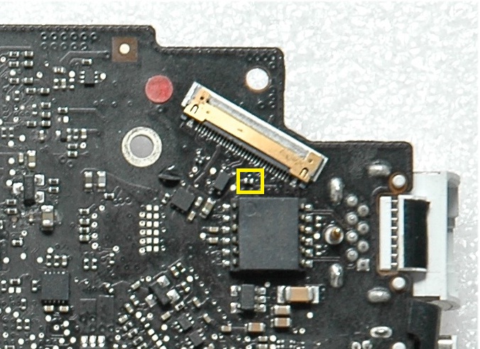

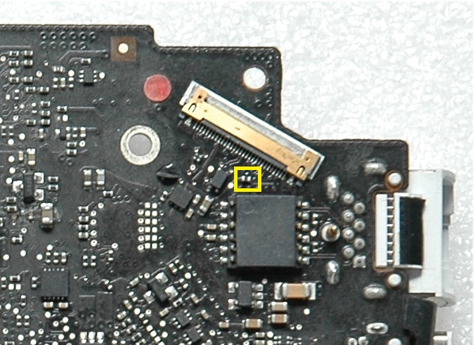

Macbook White Unibody 2.26
Hey guys
Just a quick question
I have a macbook white unibody 2.26
machine was working perfect
I needed to test an lcd assembly so I hooked it up to the perfectly working machine and the lcd came on but just stayed white so i checked the lvds cable from the assembly and it had some broken/burnt pins so I hooked up the original assembly and I get the same thing, upon further inspection near the lvds connector on the logicboard I see that a component has blown
So can a bad lcd assembly with a blown lvds cable blow out a good logicboard?
I have included a picture from google and highlighted the component in yellow
Any ideas on what can be done,
I have a few dead boards but not the same model
Could I just bridge it?
Any help would be great
Thanks

The picture is not high enough res to zoom in and really see the part or which pins it connects to. However, looking at the general layout of the LVDS connector I am not sure if it has the same pinout as the MBP13 2009 or MB Aluminum Unibody 2008 which are interchangeable. Looks like it is possible that the white unibody has a different LVDS pinout despite using the same connector.
To answer your question it is entirely possible to blow components on the logic board by plugging in a bad LVDS cable or bad LED display. The LVDS connector carries backlight voltage (up to 28VDC) as well as 3.3V power to power the panel.
If you can get a high res closeup of the parts right at the LVDS connector I may be able to figure out the pinout.
