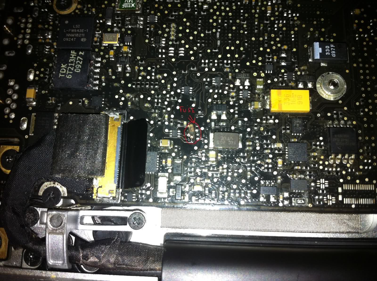

ok made a picture:
1=soldered location by old owner is gives 005 @ ohm 200 setting
2=same kinda capacitor gives no reply at all to multi meter! i also noticed this is the capacitor which is shorted on pictures above (few posts back by other person)
going further on wled to ground now
help?
Regards, Peter
OK. So just to make sure I understand... Are all of the purple lines you drew on the WLED driver measuring 005 ohms? There should only be a few points measuring shorts to ground.
What is the 200ohm circle you drew?
Also, I am not sure what the fuse you labeled as "2" is. Fuse "1" is the fuse that feeds the WLED driver I believe. Unfortunately I don't have a logic board of your particular vintage to check for myself.
edit: Just looked closer at the picture. Typically components with the "dot" on the top are fuses but you indicated that one of them is a cap? I wish I had one of these boards so I could walk you through it but I need to just go by pictures unfortunately :-(
Peter. Can you enable PM or email on your account so that I can send you an email? I have something that might help....
No forget that i die that wrong, they measure 005 form wled pin ten follow track to next point. I saw later that it needed to be wled pin to ground instead to next point. I still need to check them all again.
The ohm thing was just what settings i used, i have 2 digital multimeters and a lot of knowledge on mobile phones repair, so i am technical but not on this level but i dan learn. 🙂
Fuse 1 is on the board most top and already soldered by former owner i guess.
Fuse 2 looks like the same and i just saw it and thought let's measure it aswell.
It gives no respons at all.
I have motherboard of this model for you of you want, but with liquid damage.
I will enable PM.
Regards, Peter

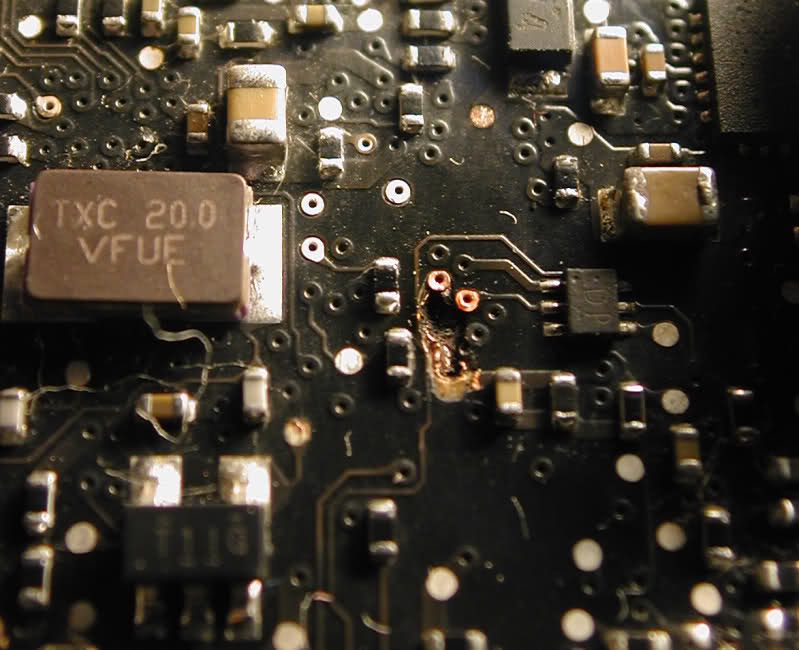

I have had this before. Sometimes it also eats away at the tracks on the circuit board. I fix them by replacing the connector with a new one and bridging solder if required to get contact on the logic board. I think the connectors are made by I-PEX. Replacing them takes a bit of soldering skill and the right tools (microscope, good iron).
It appears that there's nothing to solder it to.

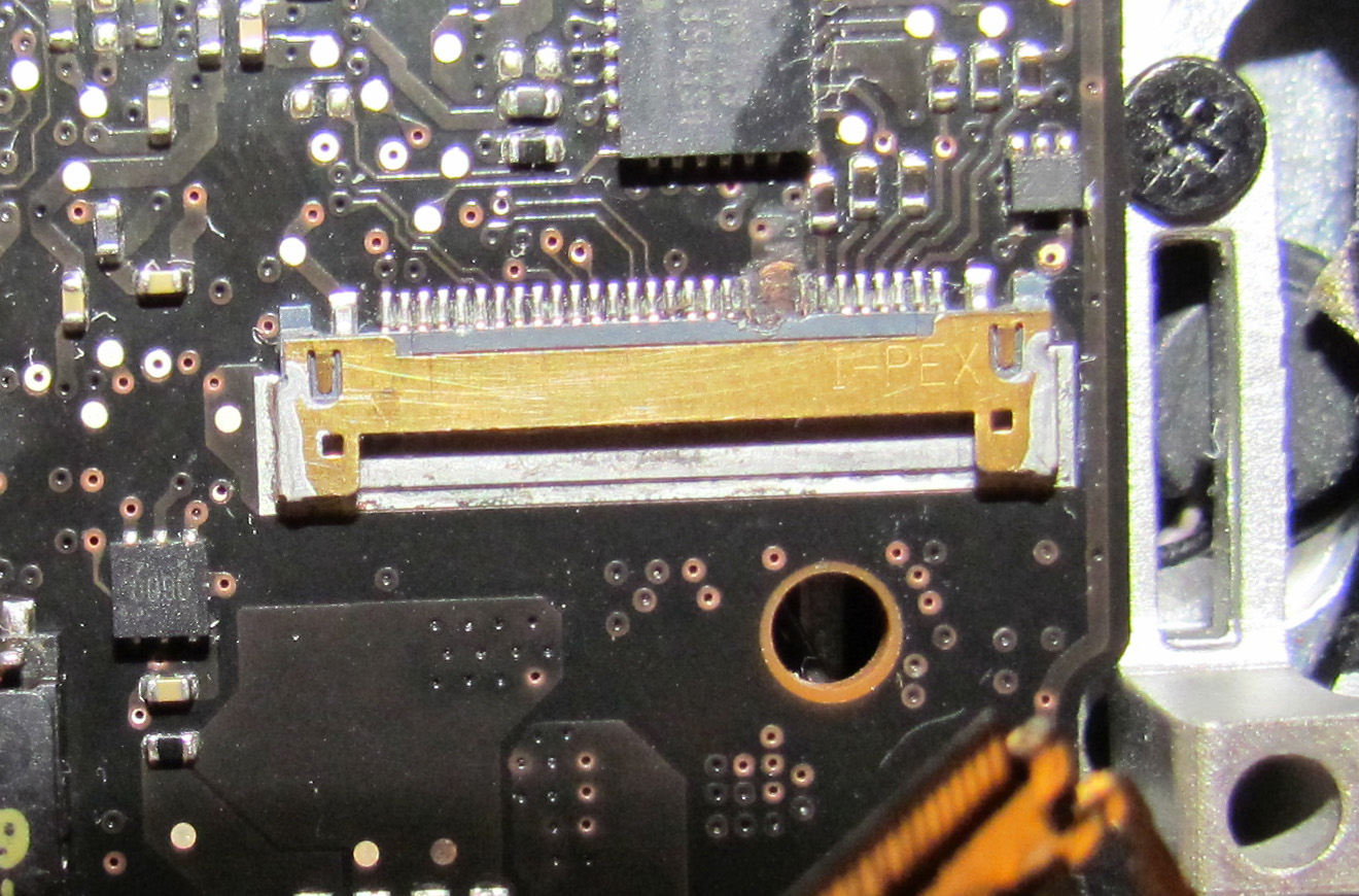

Ok, so I verified that the pad isn't pulled off. I have my 27v, and in checking it, I must have made contact with the busted pins because the LED lit right up. Considering the fact that I don't have a microscope, does anyone know a place that I could send it to have a new I-pex connector put on? Is there anyone here that has done it before that would like to tackle this little project?
Well that is good news. Under a microscope you could probably use an exacto knife to scrape off the solder resist to expose copper beneath and have something to solder to. If you can hold up the board on a bit if an angle under a microscope you could view where the pins come out of the back of the connector and attach to the board. If there is enough pin left you "might" be able to get solder to attach to it but the plastic is very heat sensitive so it may not survive the attempt.
The 30pin connector used on the 13" models is 20474-030E-11 so some googling might identify a place that carries them. Example below from a quick Google search. Not endorsing it....

Well there wasn't enough pin left so it looks like a new connector. What kind of microscope and soldering iron do you recommend?

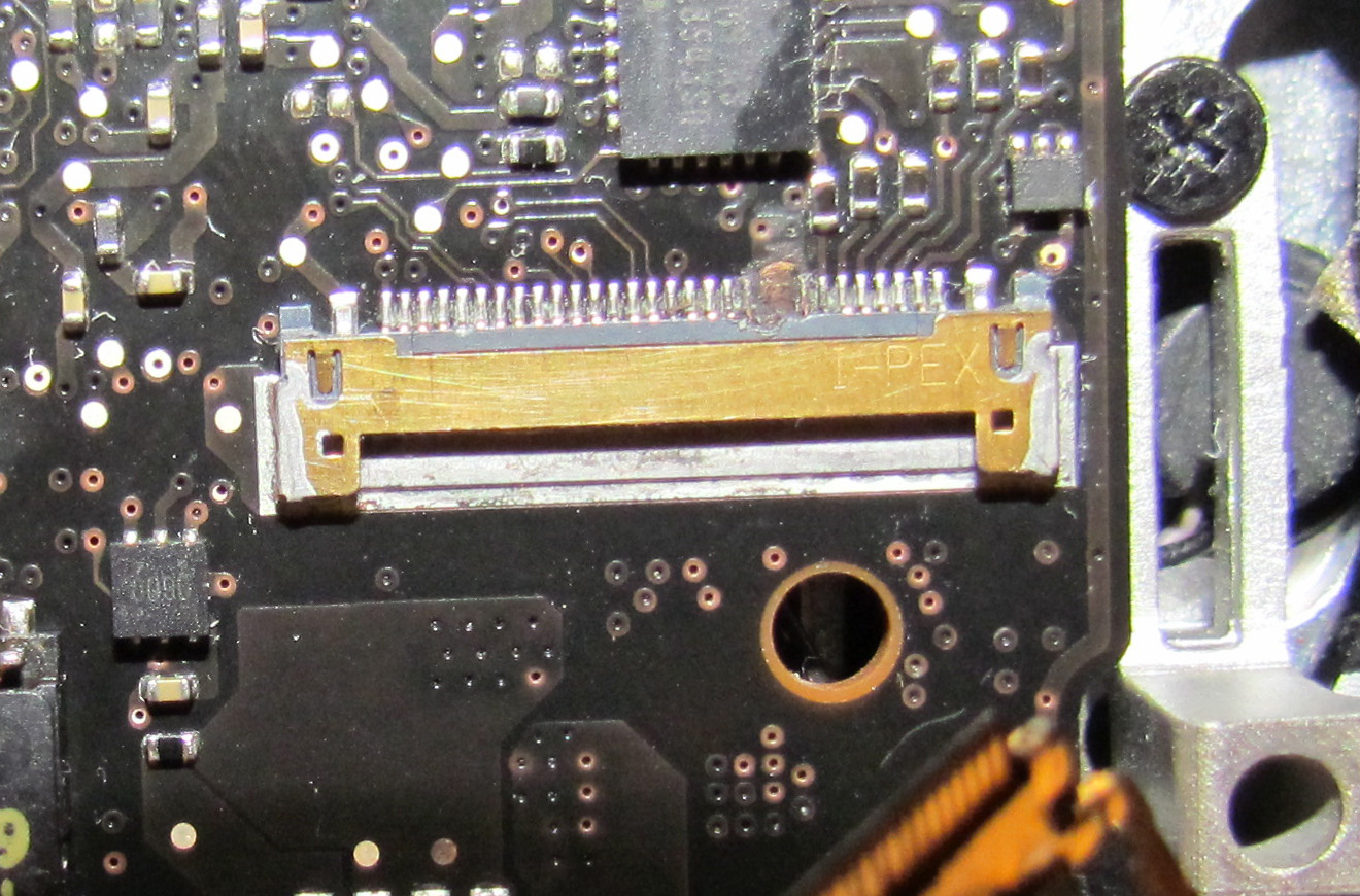

i traced where on the board the led wiring comes to:
are these green things fuses?
the top two measure .4 ohms but the lower one is o/c
success! the green things are additional fuses.
for now i replaced it with a 1a glass fuse with leads soldered on, taped next to the fan.
so mine blew due to the clip that holds the screen cable shorting on the back of the connector, the new one came better insulated:
Dadioh thanks for your help, another macbook saved 😀
