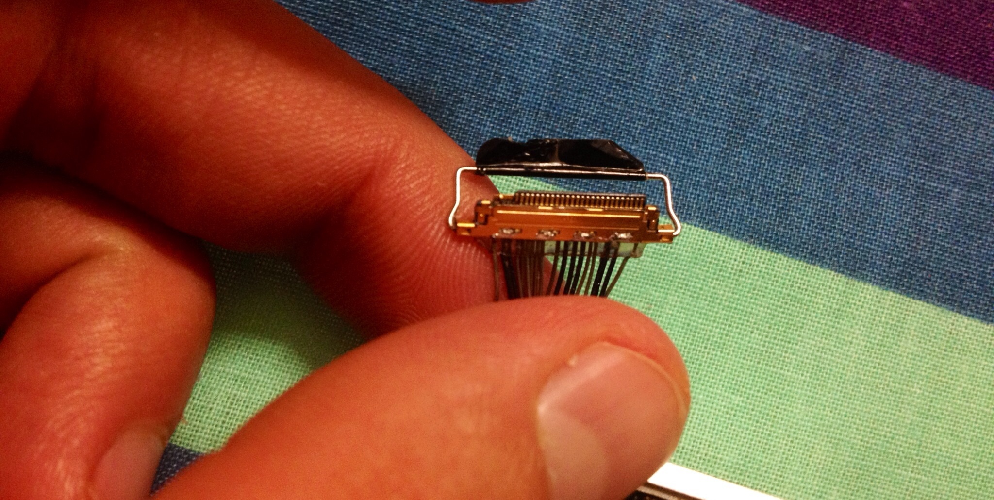

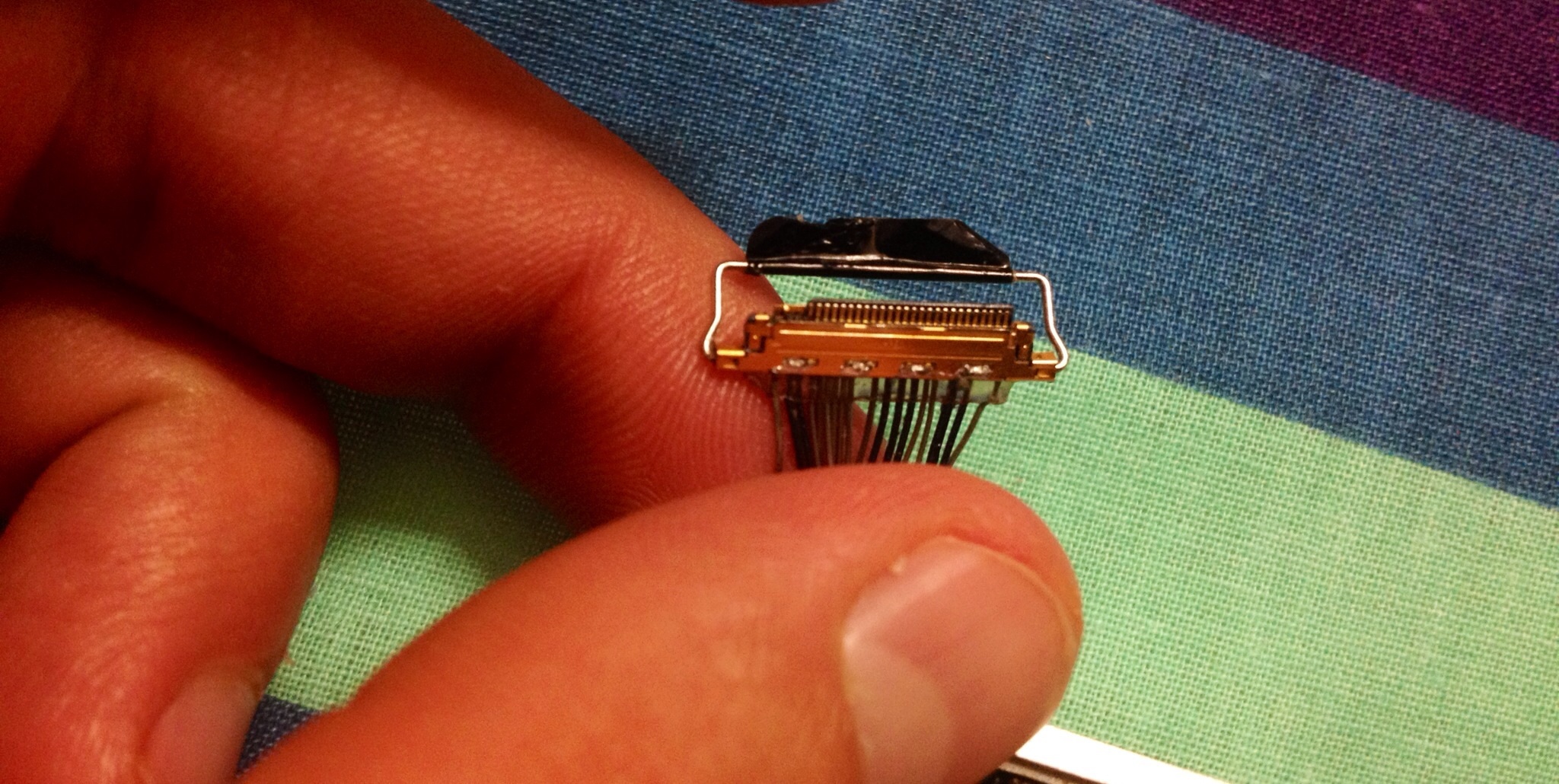

Macbook Air Late 2010 A 1369 - No Backlight
...this is the LVDS cable

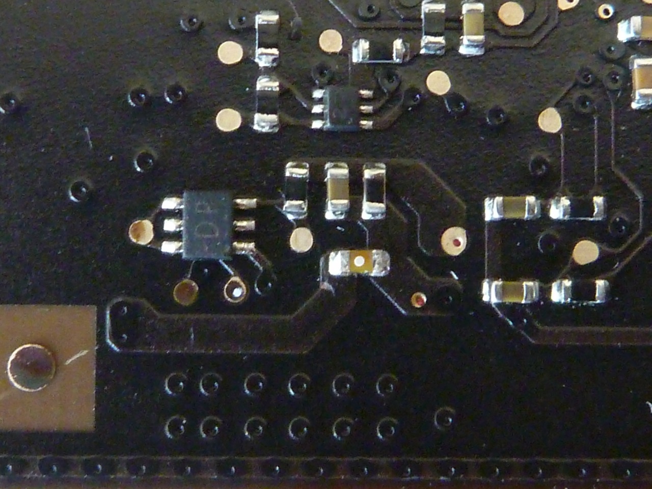

Macbook unibody a1342 keyboard connector
After replacing 4 402 packages on this board. I stick the keyboard in and some how break the slide connector. Does anyone know if this is a replaceable part? Thanks again folks!!

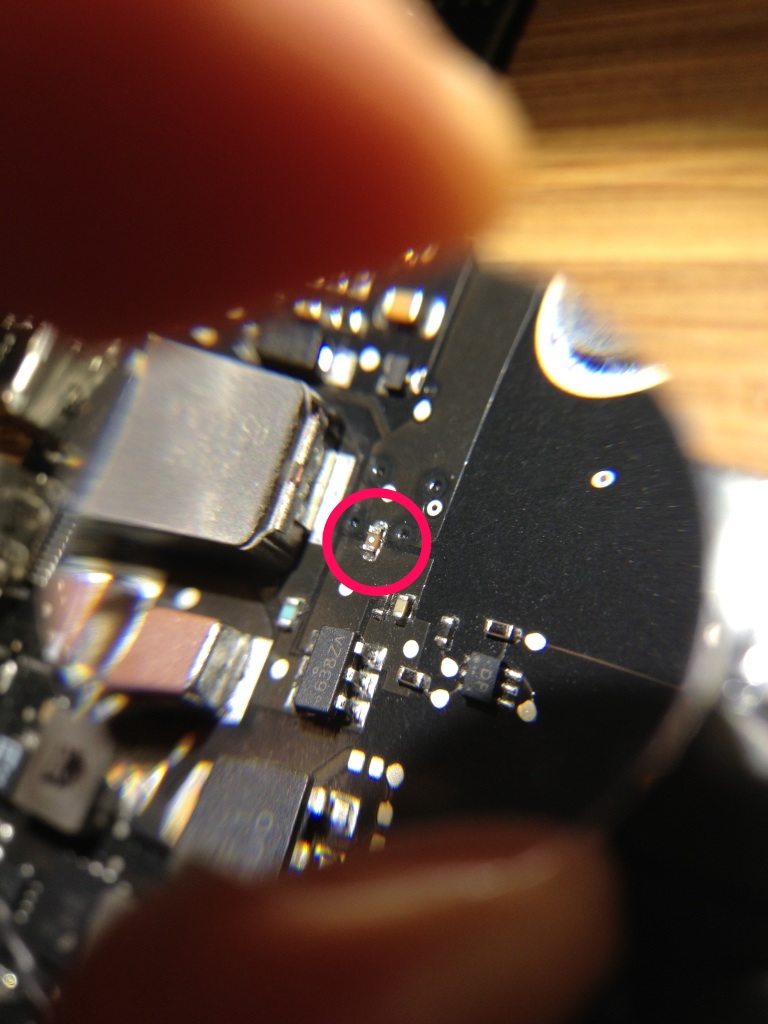

There should be a diode near the LVDS connector. On the cathode of that diode (marked with a white stripe) is the 27V that drives the LED's in the display. If you have approximately 27V there but no backlight then the issue is either the LVDS cable or the display. If there is no voltage then it is the WLED driver circuit. You want to be VERY careful probing on the board while it is running. One little slip and you will let the smoke out.
This is what the diode looks like on the 13" MBP unibody.

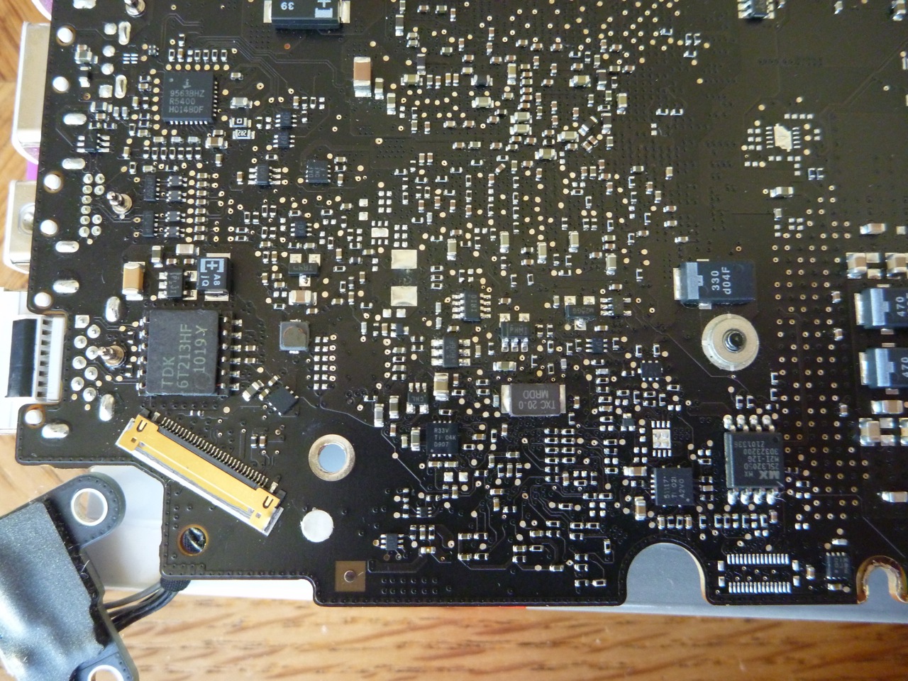

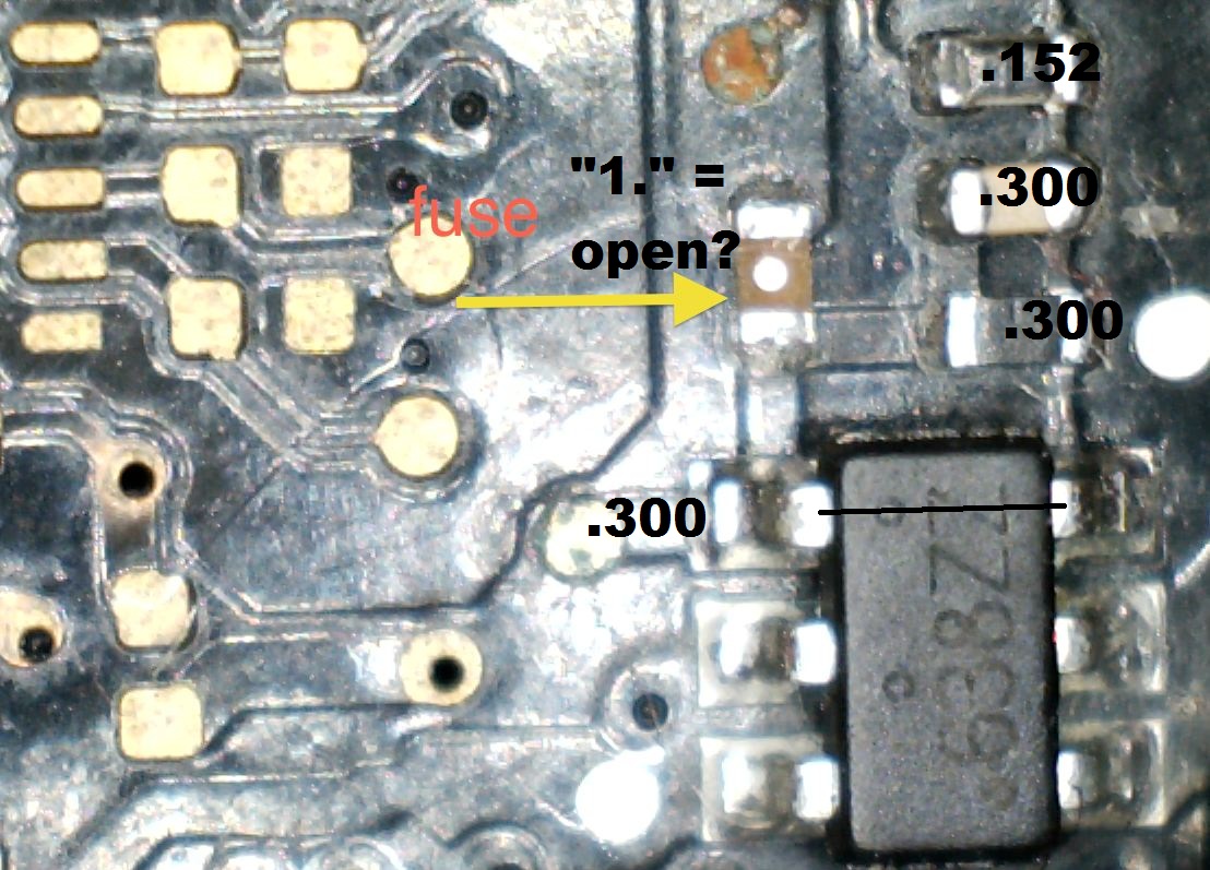

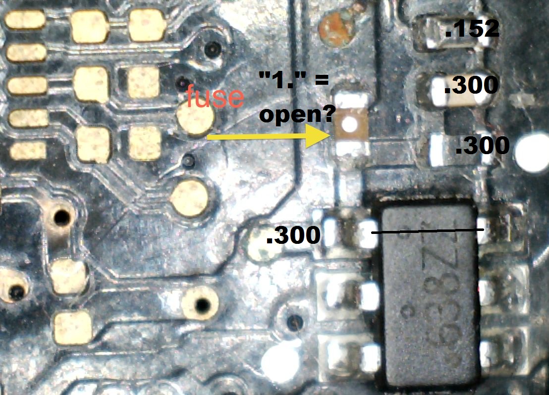

Hi all,
I've taken some multi-meter readings and I'm hoping someone can confirm my suspicions that the fuse is indeed open/blown...
This is an MBP A1286 2009 820-2533-B board and I've used a Rapidtest MAS830L meter to take readings all on same scale (2M resistance measurement).
The meter reacts and gives .300 and .150 for the indicated parts but when I test the fuse it just stays on "1." which the manual says is an "overrange indication" - I've tried all the resistance settings (2M, 200k, 20k, 2k, 200) - there's no change or indication of any reading...
Am I correct in thinking this fuse is blown?
Many thanks!!!

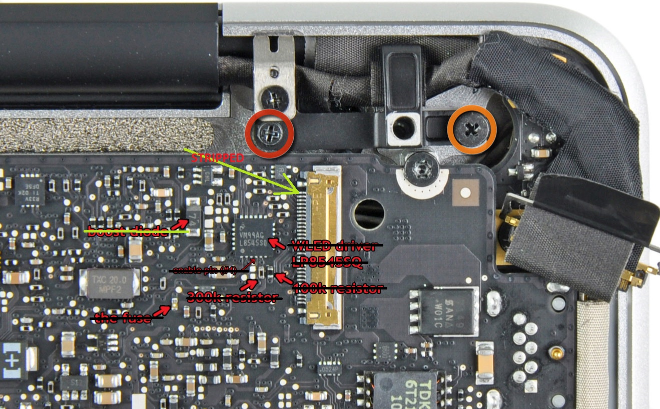

12v on the output of the boost diode means the WLED driver is not boosting. With power disconnected from the board disconnect the lvds cable and see what the resistance to ground is on the backlight pins of the connector. Maybe there is a short in the lvds connector on the logic board.

jayjohn, could you please tell me, where you found 100k/301k resistors on the board? I found one with 100k, but another one close to it seems to be dead. I have a1278. Thanks!

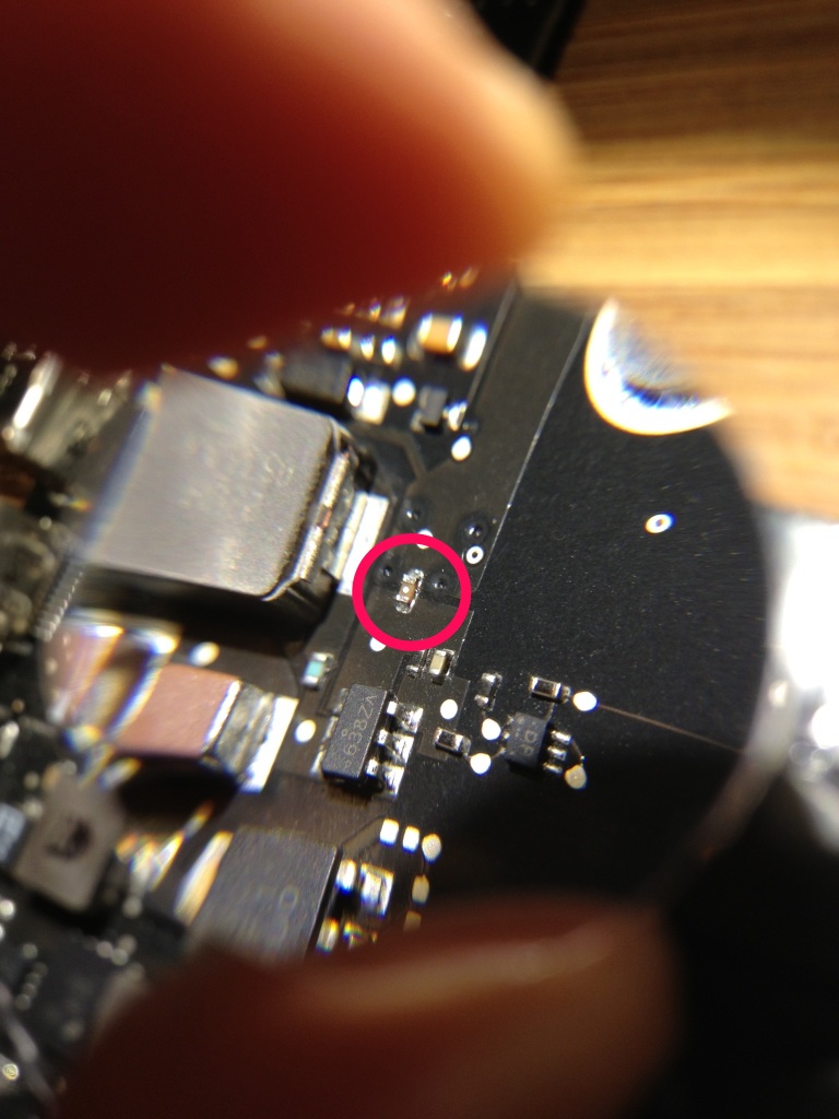

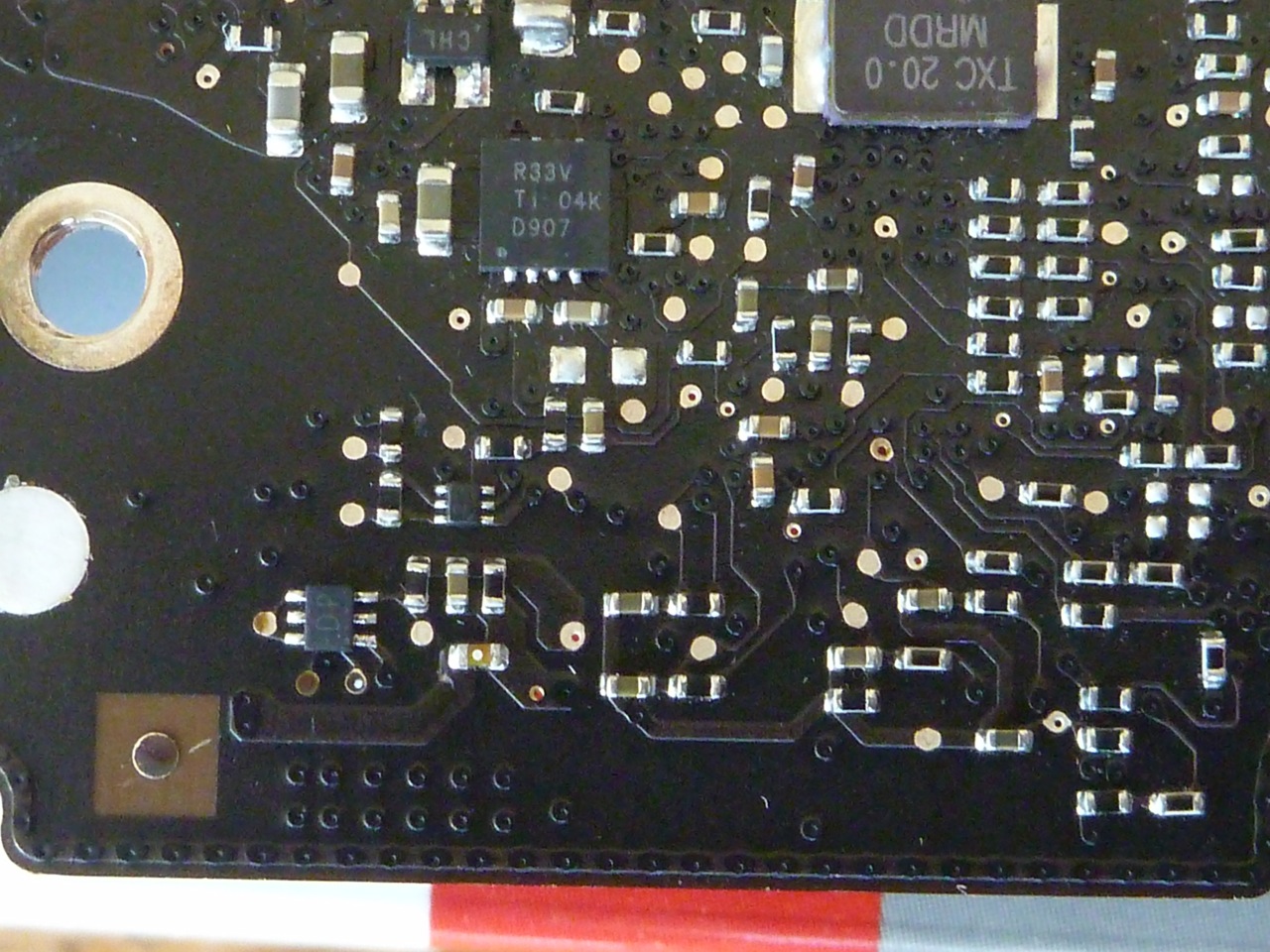

Hi!
I have a Macbook with no backlight, already replaced the LP8543, the fuse is ok. The backlight only flashes for less the 1 sec when manually shutting down the Macbook. I found a voltage drop at the below marked resistor, the resistor itself is ok but the measured voltage before and after it is not the same. Would really appreciate any help!!
Could you please show the location on the board of the 301k resistor you show here? Thanks!

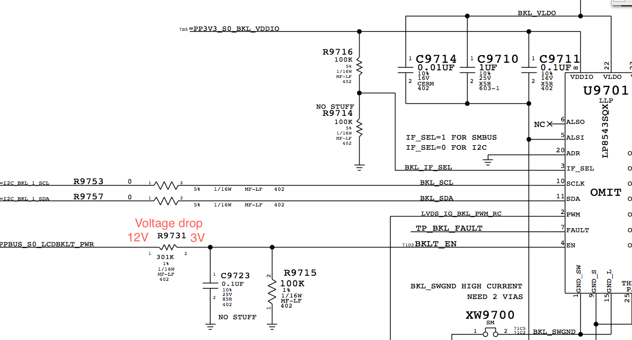

Hi everyone, I found the glitch! 🙂
Actually, my brother did, but anyway, here's what happened.
We followed the schematics (http://cl.ly/1T1m2C0A2a3W2K3Y3t0j/o), we were checking the components around the WLED driver. The problem was in the resistor which is connected to pin 4 (enable pin). This resistor should be 300 kOhms. We measured it and it read 300k, so we thought it's ok. But than we turned on the macbook and measured the voltage on it - and here was the glitch - one pin of the resistor was 11.8V but the other pin was 0V. The measured resistance probably wasn't the resistance of the resistor, but the resistance "around" it. (That's why you're supposed to measure electrical component while it's not connected to the circuit 🙂 )
Next, my brother tried to measure the resistance on the enable pin (4) - and - the backlight turned on! Basically, he brought the signal on the enable pin with the multimeter (when you measure the resistance, the multimeter puts some voltage on it's electrodes).
Anyway, the point is, the resistor was wrong, I'm going to buy one tomorrow and replace it.
The 4pcs of WLED driver (LP8545SQ) that I ordered from across the sea for $30 should arrive in a week or two. They are hard to find on our continent (Europe) but it seems like I wont need one and I also bought 3 spare pcs, so feel free to contact me, if you need one 🙂
Again thank you all for this thread, I would have probably never solved this without your help.
Here's the schematic: http://cl.ly/3J3B0E3x1G2H1H2p2y3d/o
Another Macbook Pro saved here! Used the guide above to pinpoint the problem, it was a dead 301k resistor.
I gave 3V manually (using external universal power adapter) to the pin 4 and the backlight lit up! I now have to find the resistor (which is easy) and solder it.
Thanks to all of you guys in this thread!

Yeah I think it is open. Fuse should read ~0 Ohms when not blown.

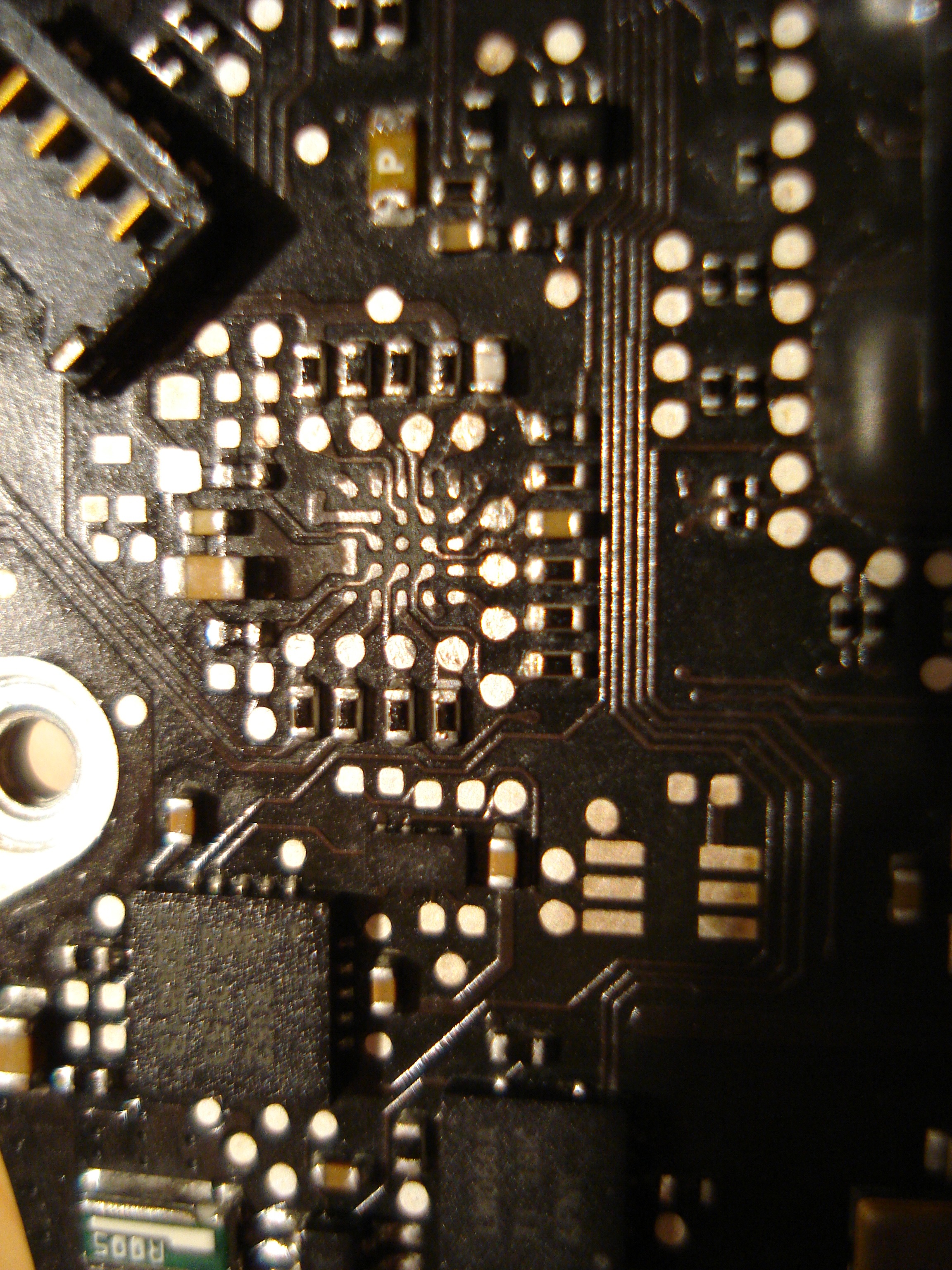

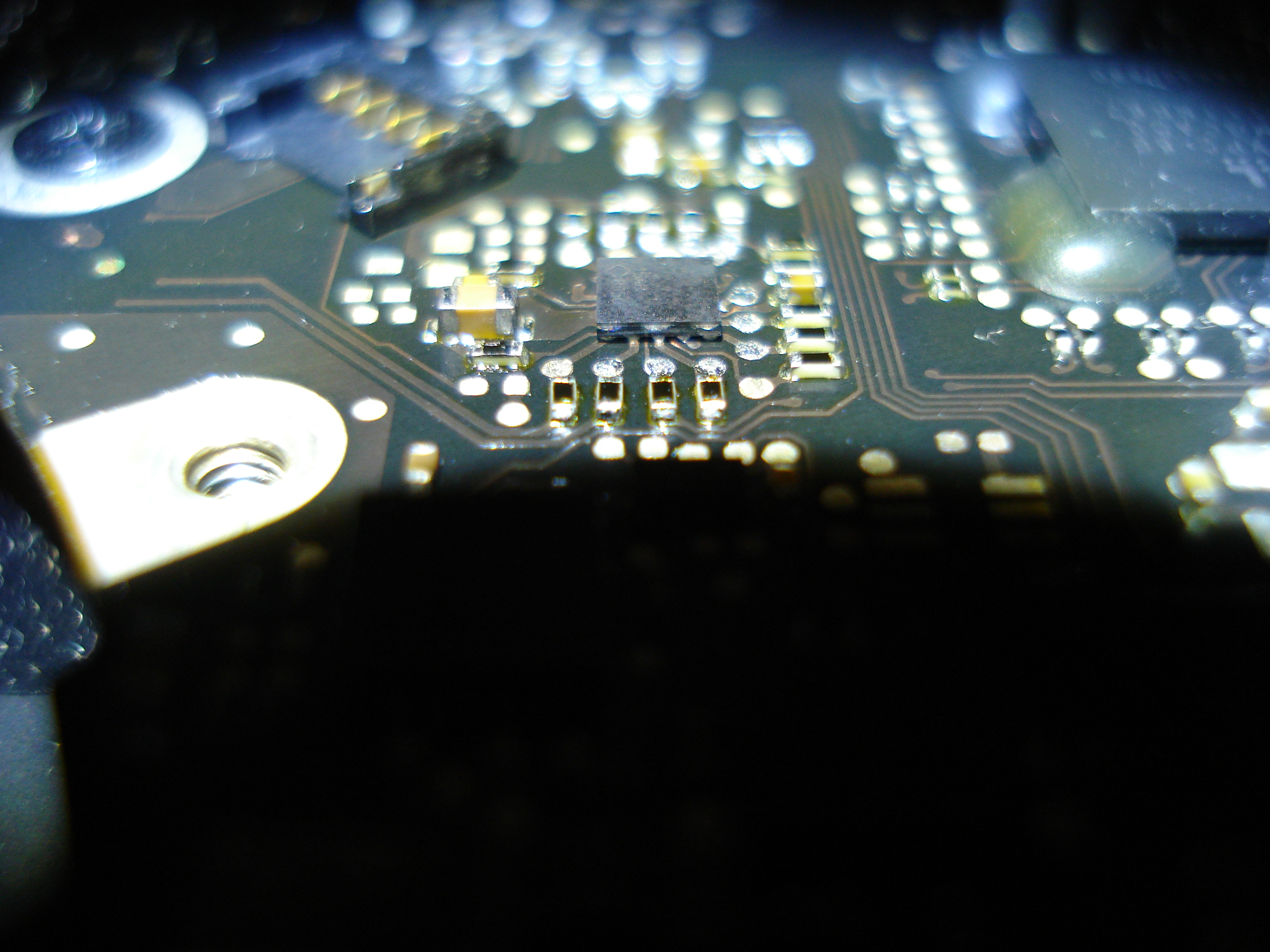

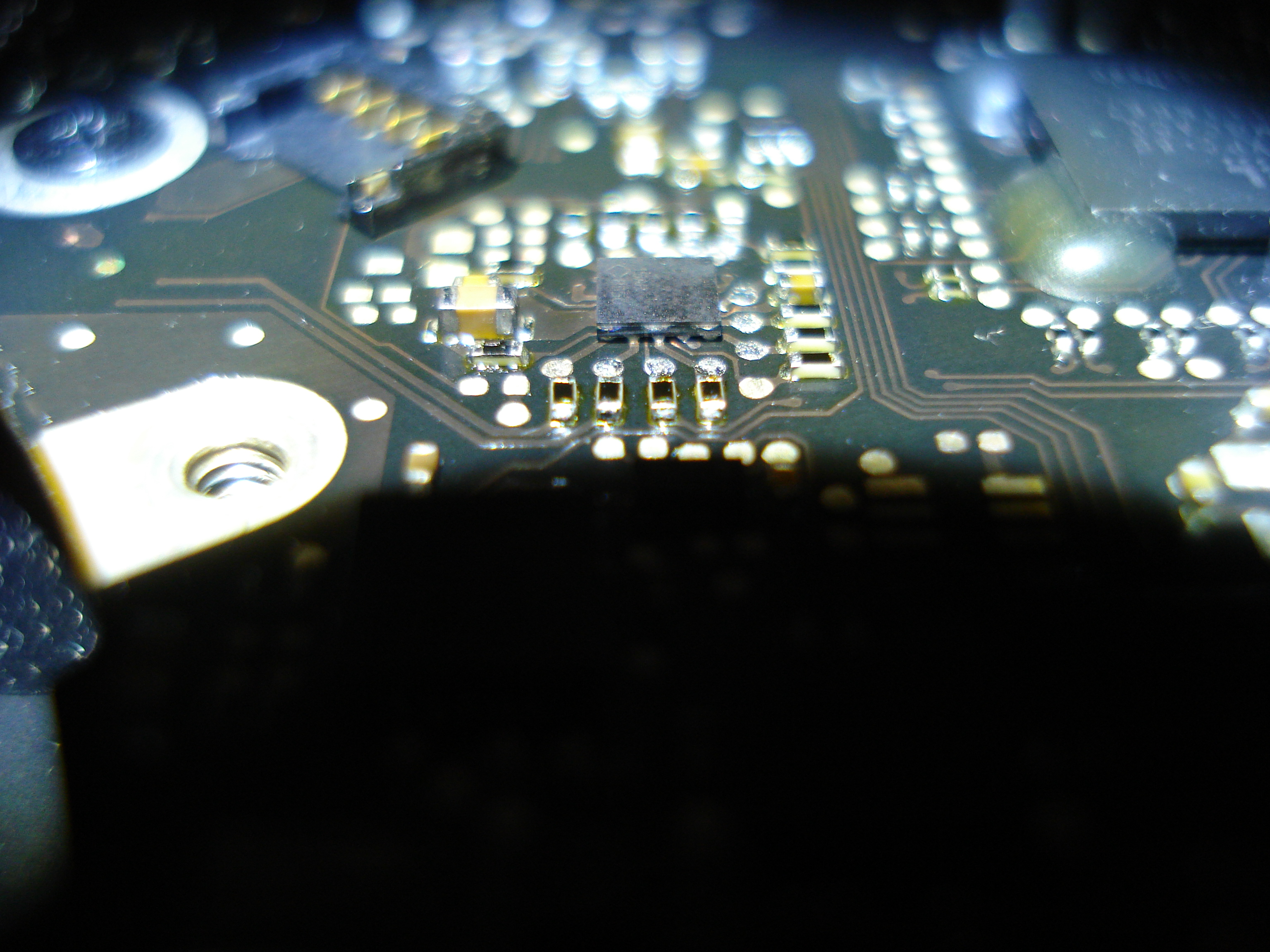

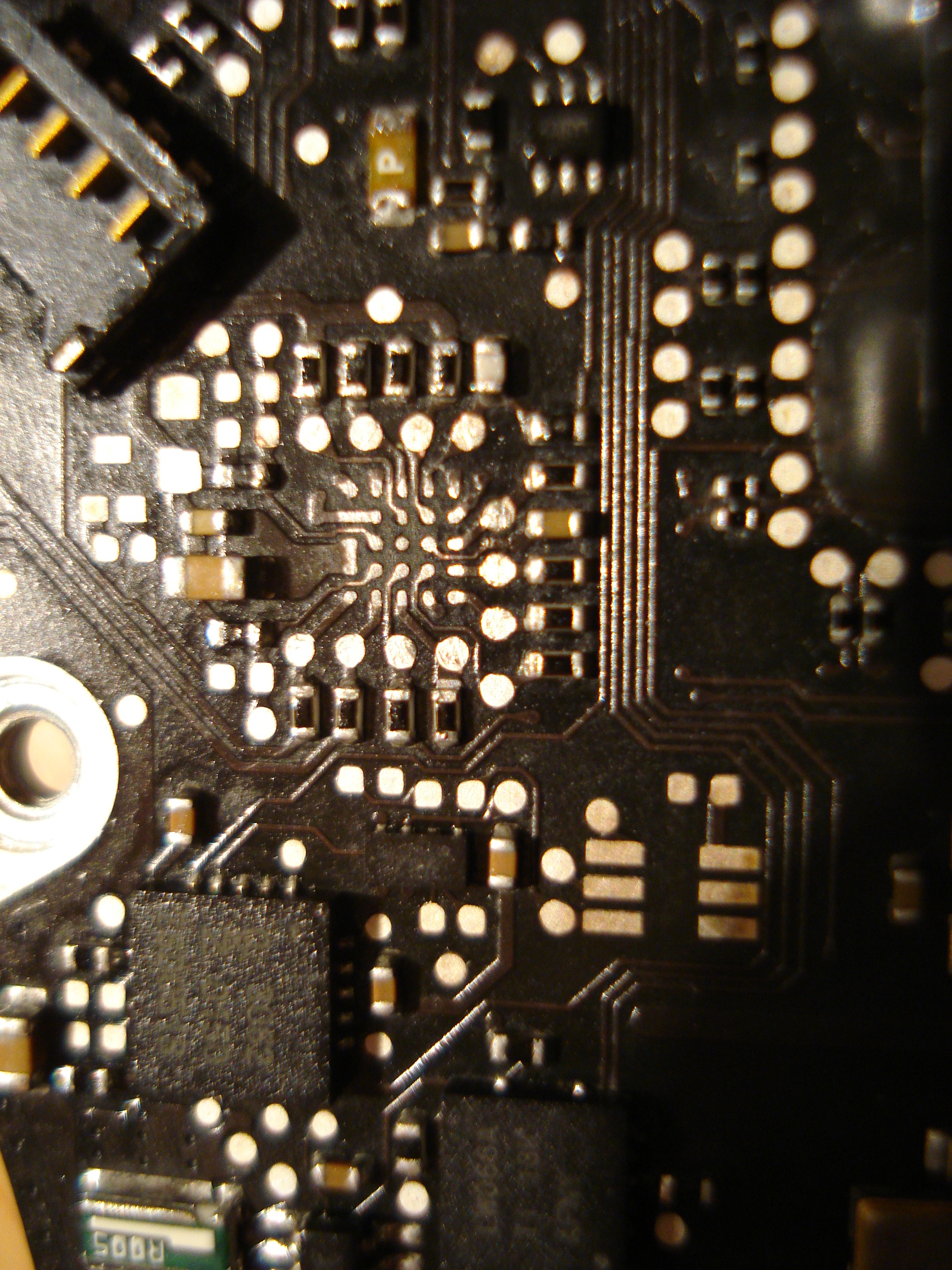

I have removed the WLED driver from my board and have received 5 sample LP8550 from National. I've had two attempts so far at replacing the WLED but no backlight yet. I'm going to remove the driver again and have another go at fitting a new one.
I was hoping someone with more experience with this type of BGA package could take a look at the photos of my board (with the chip removed). Specifically, in two areas the pads bridge together. Is this normal? The traces on the board in both of these areas look as if they would have continuity anyway, so perhaps it won't cause a problem? Also, any tips on re-attaching the WLED? Any advice would be greatly appreciated!
in the first picture, the WLED driver has been removed. The second is after I have attached a new WLED driver.
Cheers!
Cheers!
the left pic show the pads bridging west is fine. but i can not see any other bridging pads ?

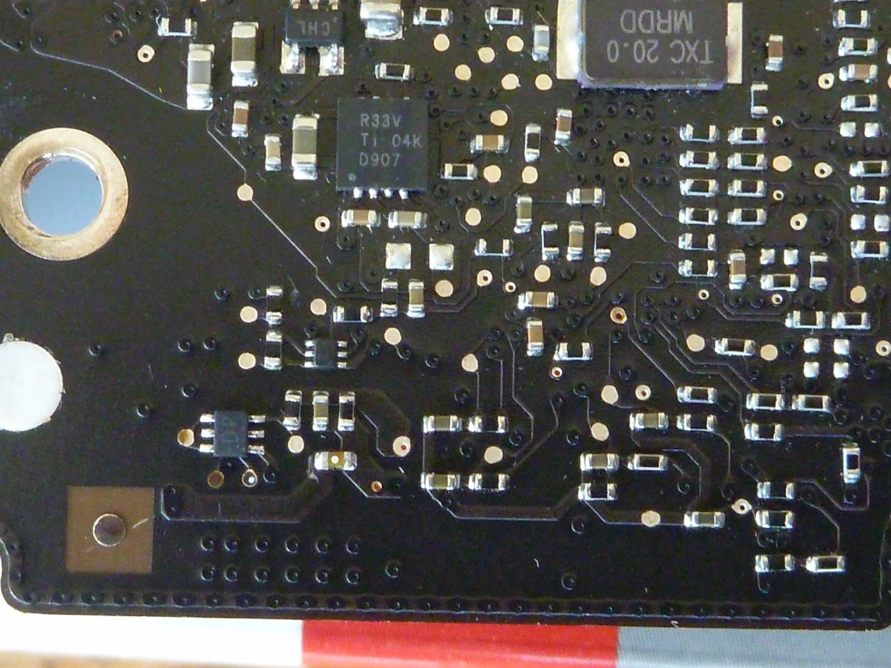

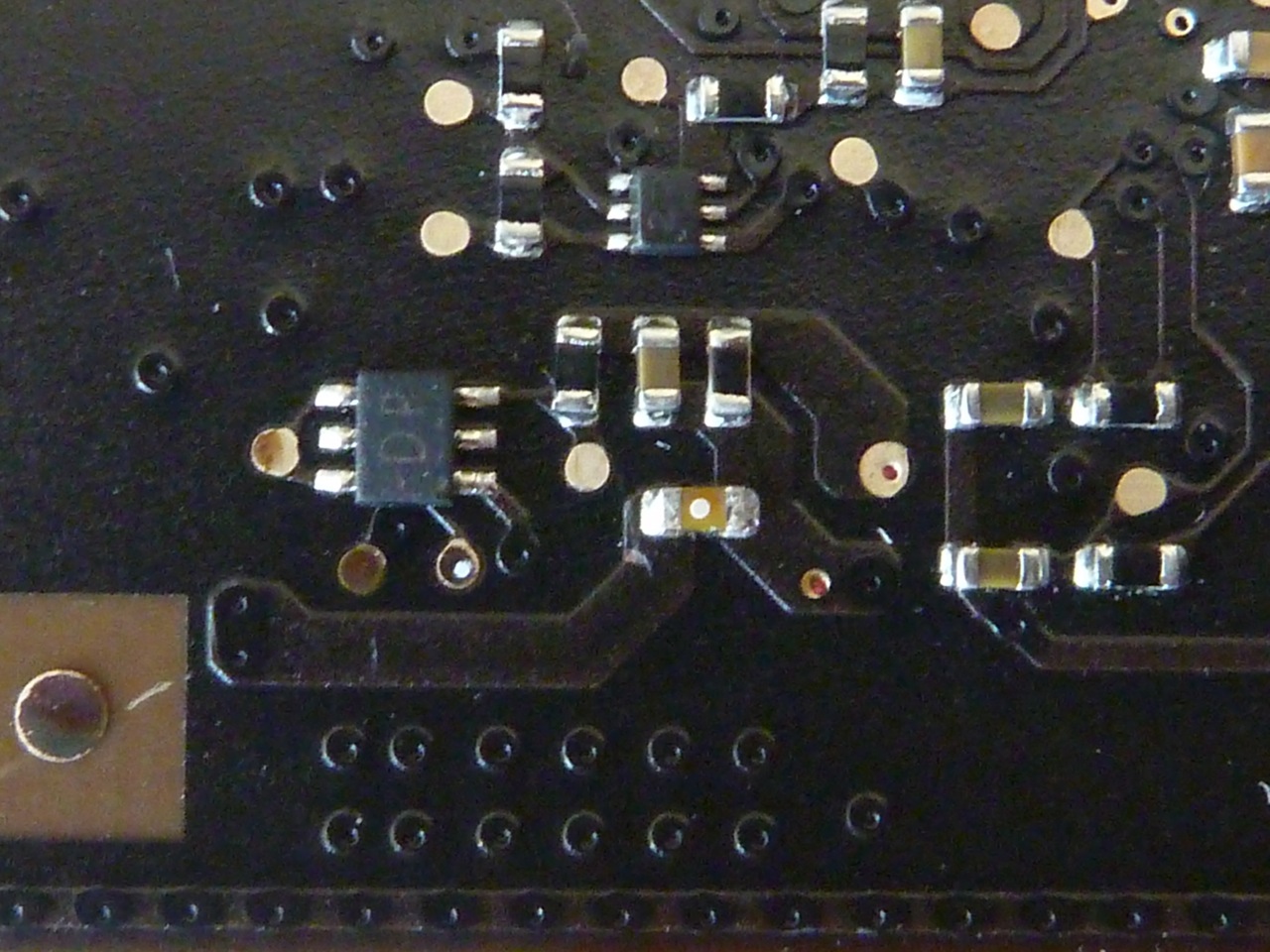

mbp 15" late 2008 A1286
hi there, i'm new to this thread and want to learn something 🙂 through your help.
first i'm glad there are people like you out there who are willing to spend their time and knowledge helping people like me. great of you all. 😀
i have issue here with the backlight on my mbp late 2008 15". not liquid caused the problem but somehow swaping parts from another mbp same model and backlight problems of course. i wanted to figure out which part caused the backlight from working on the allready broken one and therefore i've been changing logic-board and so and now i have two broken backlights sounds genius i know...
well of course i'm trying now first to get my backlight working again. therefore i have 2 questions:
1. am i messureing the correct fuse? (please take a look at my photos - hope they are good for you circle is where i messured)
2. where can i get this "fuse" since i want not to bridge it, whats the correct name for it 🙂) and what ohms should i messure if it is not broken (well i know this are kind of three questions in one)
any help would be great
regards, minorit
regards, minorit
BTW VERY NICE PIC .... i could use that as my avatar..lol
just been working on the exact same model i ordered these fuses and it fixed the issue
FUSE, 0402, V FAST ACTING, 2A

i got mine on ebay ordeded 10 as your bound to mess it up on your first go.

hi musicsoul78,
that was fast, feel free to use the pic 😉
thanks for the infos about the fuse, very detailed.
i found out that digi-key is also shipping to austria (they have a german website here) so i ordered them fuses there (bought 20 of them just in case... haha).
since you had your hands on the same model - did you bring it back to shine bright again? 🙂
regards, minorit
hi musicsoul78,
regards, minorit
Yes indeed dadioh and the rest the guys on here helped me out and it was awesome ive done 3 macs now.😀 with backlight issues.

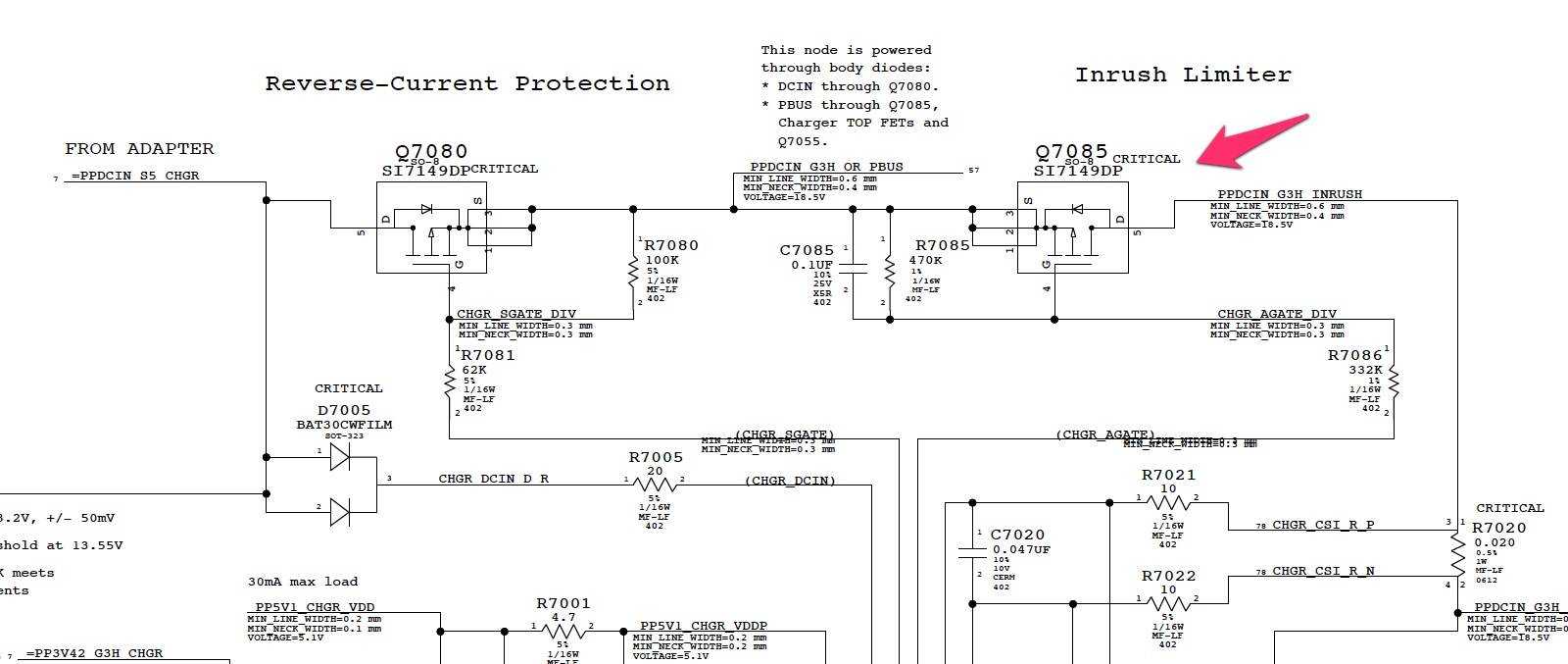

tips for 0402 replacement pls

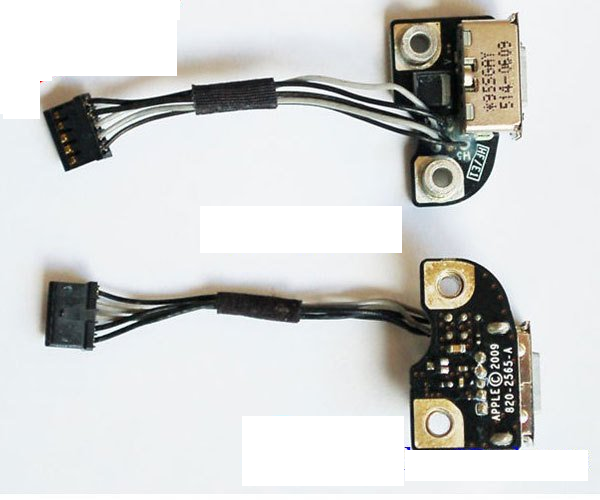

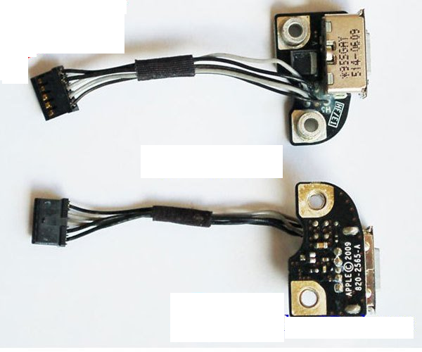

Hi all,
just about to attempt an 0402 fuse replacement for a MBP 15" 2009 820-2533-B board. I have 10 fuses and am quite sure replacemnet will fix the backlight issue as the WLED tests OK...
I was just hoping ppl could share their tips/advice on how best to desolder the blown fuse and then solder the new fuse... Any links or a quick top tips run down most appreciated!
One other question,... The magsafe unit I have,.. I think it has caused the fuse to blow (3 times now) it is part number 820-2565-A. How do I measure if this is working correctly? I have a new magsafe on its way but curious about correct diagnostic so I know how to check in the future
Many thanks!

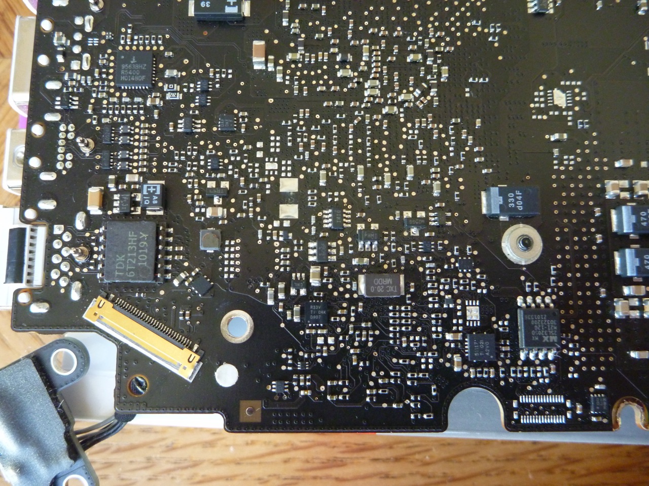

Ne one figure out the 2011 17in mbp baclight issue?? I too picked up a laptop that had liquid damage like i normally do but after cleaning it all up i still dont have a working backlight. I can see the pic like everyone else can but i need a flashlight to do so and i read all the posts pretty much where others havin this issue looked for a fuse with a white dot or a letter on the top and i cant find either...i even looked further away from the video connector than previous models and wasnt able to find anything either 🙁. If u want i can give some crazy high rez pics if my gf gives me my damn camera back haha but if you dont need them and know the location of it so i can at the very least check it to see if that is the reason for not havin a backlight please let me know! It would help me a ton!
I had to chime in here for anyone else who is trying to find the backlight fuse on a A1342 MacBook. I recently fixed a logic board by following the hints in this thread and others. The fuse is located quite a distance from the WLED driver and has a white dot on it. Here are a few pics with increasing zoom level. The backlight is back... thanks!
