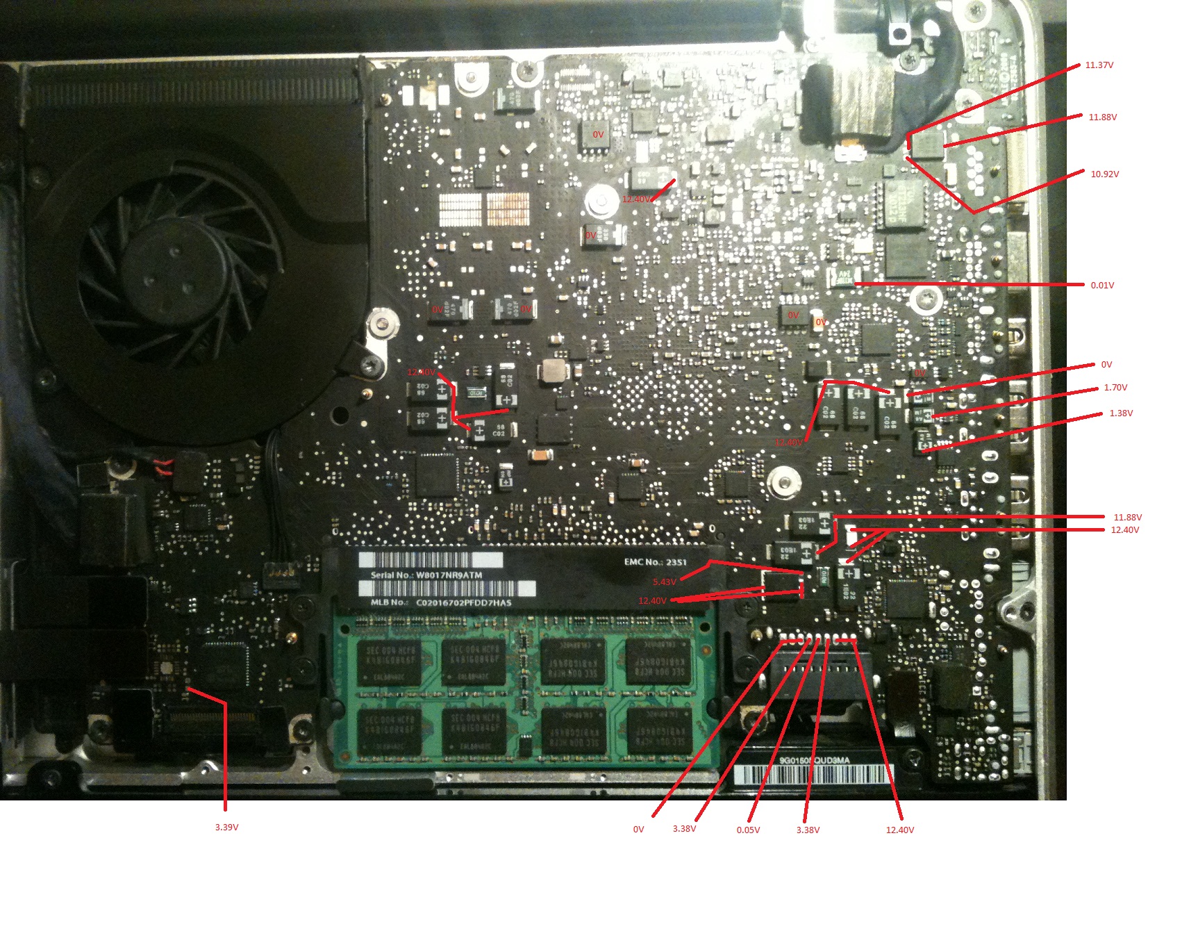

hello peeps!!!
errrr help please
display will not work,
issue is no power going to the lvds connector or wled ic
no image whats so ever. way more than a backlight issue.
no water damage or corrosion.
just failure over time
regardless still boot fine with hdmi out to tv.
its definately a voltage issue.
also on the g3hot one side reads 3.37 and grnd (heatsink side)
other side reads 3.29 and grnd is not grnd as i have to use another grnd pin to measure the left pad value.(keyboard connector side)
any ideas where to start?
im lost 😕

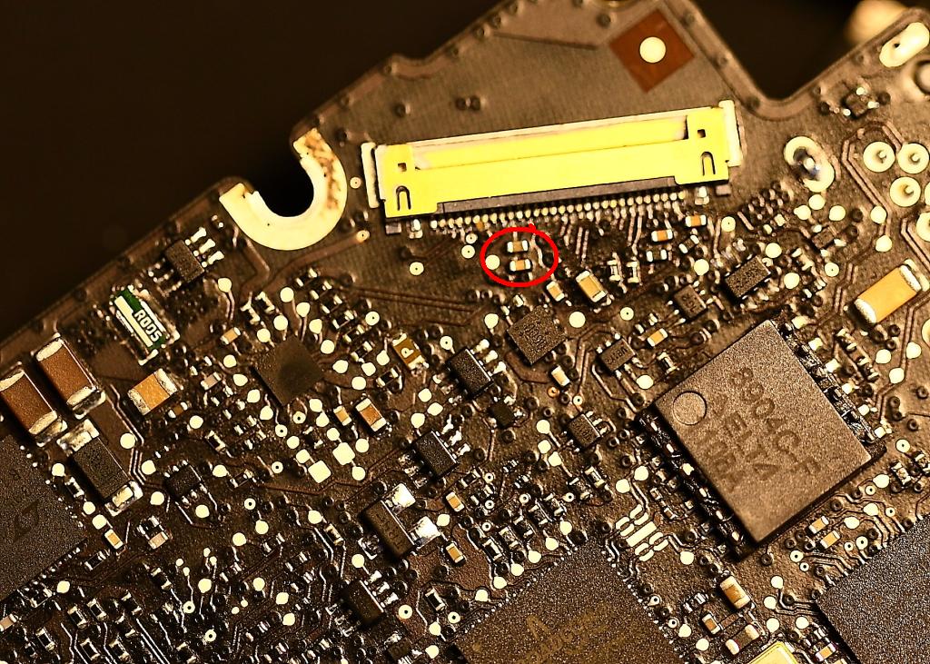

Macbook pro water damage HELP PLEASE?
Hi all,
I have an early macbook pro 2011 13" and it has suffered a bit of damage (spilled soup).
When cleaning I noticed that I had clearly been too rough (sorry i'm a bit of a noob) and dislodged a 2 0402 package components. the larger capacitor had to be removed due to the damage.
I was wondering if anyone could be kind enough to let me know if they could identify the components circled i.e. capacitance and resistance. I have tried to locate schematics but have had no luck :-(
PLEASE HELP
Thanks in advance guys.

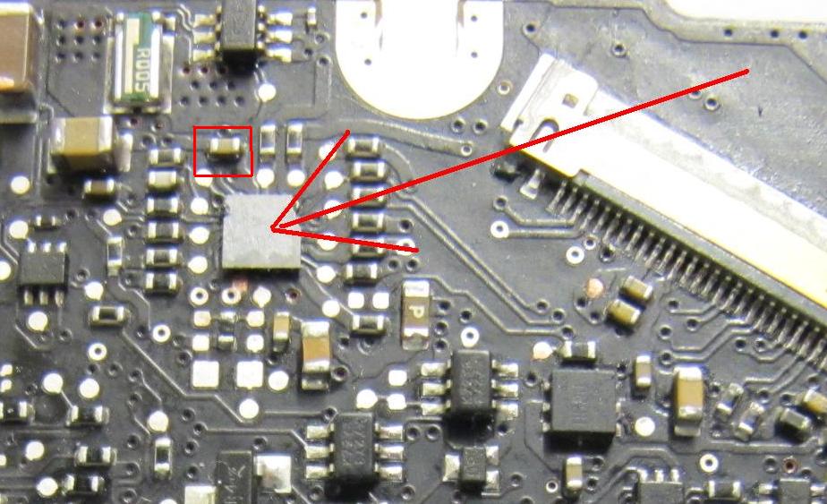

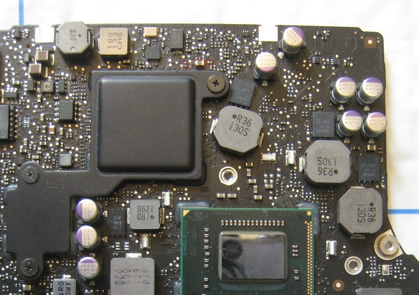

Hello,
I need some help. I need to know what type SMD is missing on my mainboard. ( the top one in the red circle is missing on my mainboard )
Ad this moment my screen is complete dead. The system it self is working fine when I use a external monitor.
It is a MBP early 2011 model ( A1278 )
thanks Thanks in advance

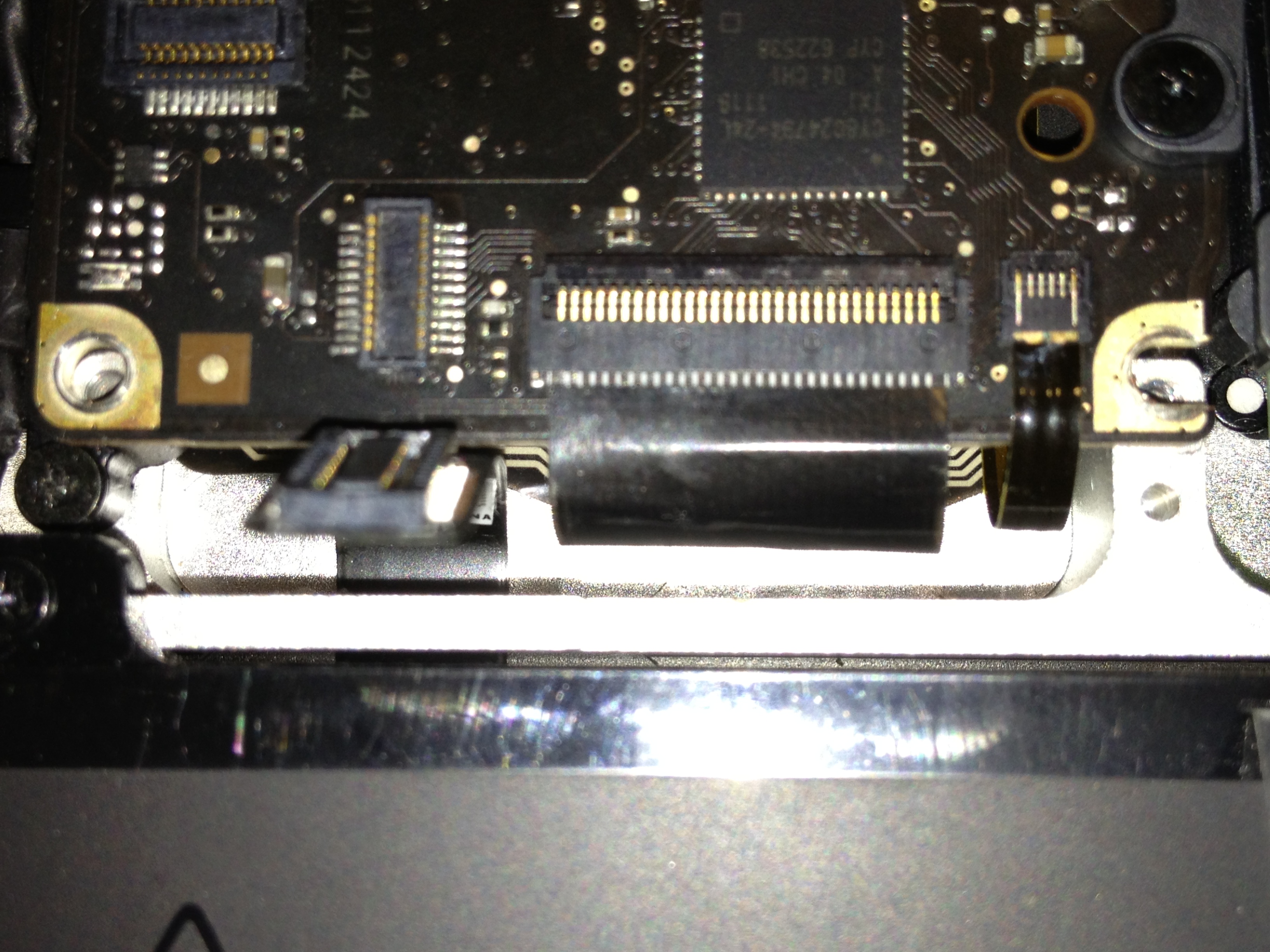

Hello every body
I, m sorry i know here every body speaking about back light, but i did not find any good thread about keyboard problem.
I have got a MBP 13 2011 which is liquid damaged. the MBP works fine but the keyboard not working normally.
I replaced the keyboard twice but still i have the same problem, what could be the problem.
The keyboard socket i clean too.
Please some help
Thanks

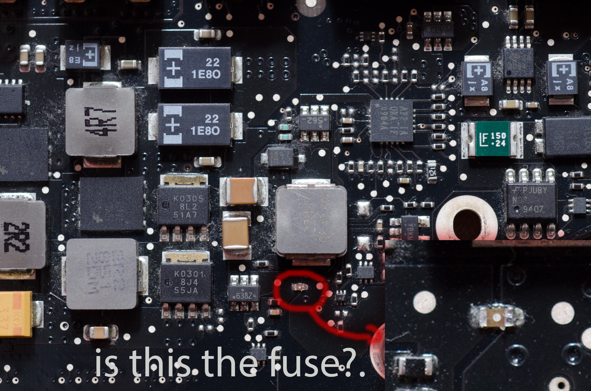

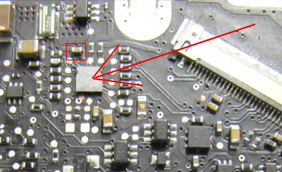

Having backlight issue
hey there daioh, ive been reading most of this thread for days.
i would just like your opinion if this component on the picture is the well known fuse. I tried to see if my multimeter beeps but it does not.
i will be having help from a friend who is expert in soldering but he doesnt have any experience in mac.
i will be having help from a friend who is expert in soldering but he doesnt have any experience in mac. Image
Yup. That would be the backlight fuse. If it is blown you need to replace it. Resist the temptation to bypass it or you may end up causing further damage. If the cause of the initial fuse event is still present you will just blow another fuse. If not... well there is smoke inside all electronics....

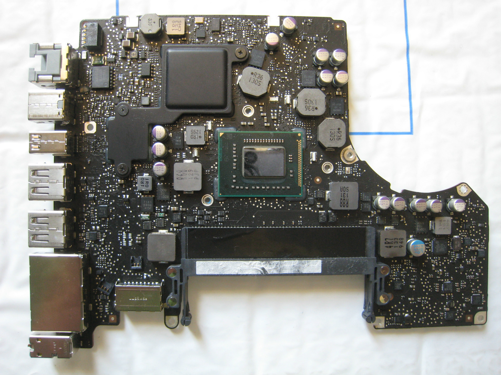

Macbook Pro 13 2010
Hello
I am working on a liquide damage macbook pro, I have got the G3Hot to work but there is something not working. The macbook charge the battery good.
Hope some of you can help me out to continue to resolve this problem why it wont start. 🙂
PS when I try to do SMC bypass then I get dim green light.
If I reset the SMC then its back to normal bright green.

Hello
Hi kennethf. I had a similar issue with a previous mbp that had liquid damage. After cleaning it with alcohol it wasn't turning on via the power button...Have you tried shorting the two pins in the logic board to bypass the power button? They are located just to the left of the keyboard ribbon cable. You have marked one already with 3.39v in you picture. The one above that should read 0v. I shorted them and the mbp turned on. If you do decide to go this route make sure you do not short anything else... This sounds like a dumb question but is the ribbon cable properly pushed all the way in? I later found out that some debris had been lodged inside and was preventing the ribbon cable from being fully inserted. Cleaned out the gunk out with compressed air and the mbp fired right up. Hope this helps.

Hello,

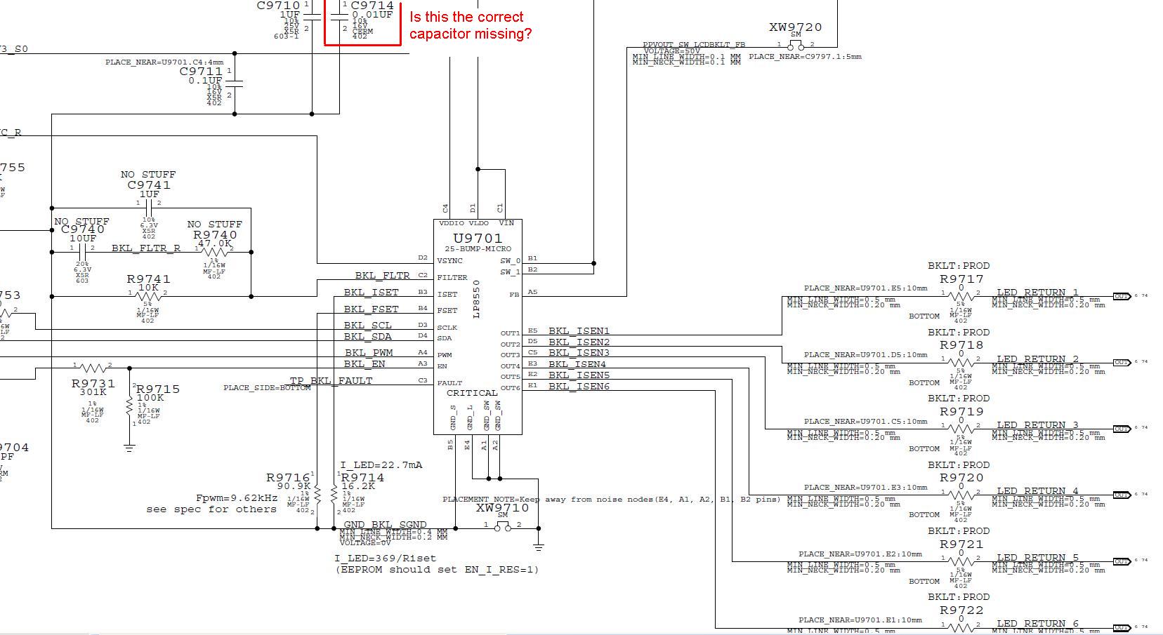

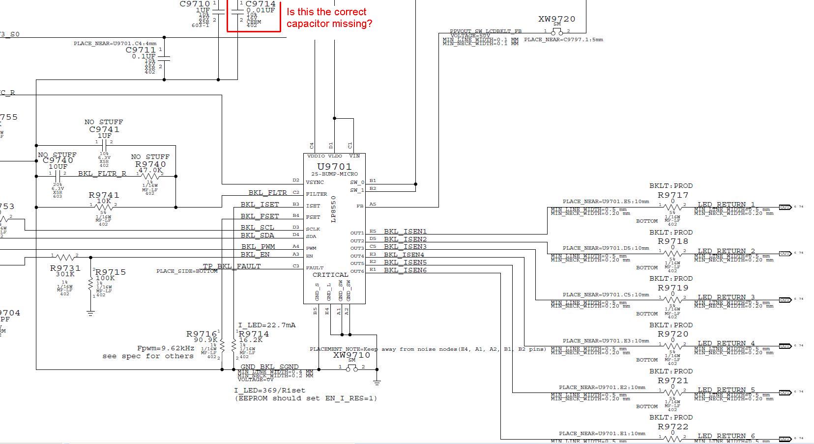

Good morning Igek, I think we might be able to help each other out. I just purchased a June 2012 MBP also with liquid damage that has a missing capacitor around the same area... The layout of the motherboard looks exactly the same. (guys correct me if I'm wrong) I think the piece you are missing is a 0402 size capacitor. I do not know the value yet. I will try, if time permits to try and measure its value this weekend. I have attached a pic of the missing capacitor that I'm missing to see if your able to help me and finding the value.

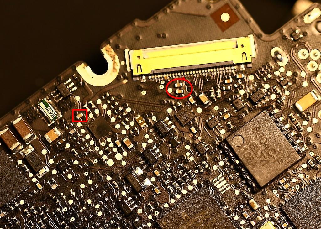

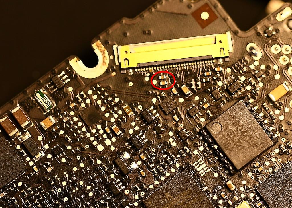

hey there again,
my gf's macbook pro is a a1286 15"
im having progress. bypassing the fuse didnt solve the problem. the backlight is still down. The lvds was burned and was replaced. the lcd is working fine with no backlight. tested also another lcd to doublecheck.
i measured the pins on the wled driver which is shown in the image on my last message as APP_1A. i get no resistance on some pins so that means its blown. do you know where i can get a replacement of this component?

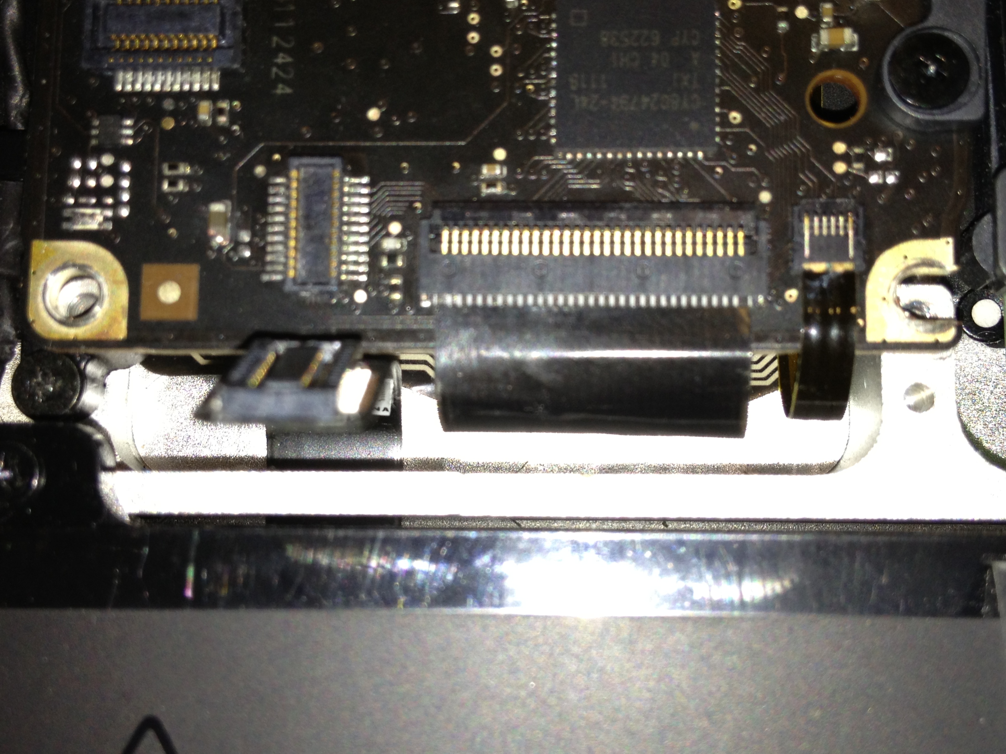

Hey guys. Need input. As mentioned earlier I have a June 2012 mbp 13". I managed to salvage the computer after extensive liquid damage using the knowledge from this forum. The mbp now turns on but the backlight is not working. I was wondering if anybody can confirm my suspicion in helping me ID this capacitor that is missing from my board. I have marked the one I'am missing in the picture and the one I believe to be in the schematic with a red square. Please disregard the red arrow. Any help will be greatly appreciated.
