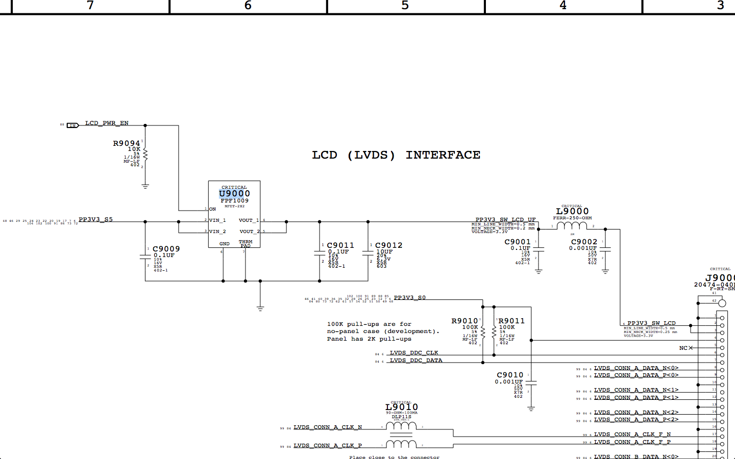

This is the only in depth thread I can find that talks of schematics and small component replacement. I'm now trying to help a buddy with some liquid damage on a mid 2012 13" cleaned it up, but a really odd problem. It runs really slow, and turns on but only after holding power for 5 sec. If you tap power, the fan will spin a few secs and die. Did they do a lockup of new schematics? Can't find any of the newer ones.
Here is a PDF file of the U9000 chip so you can see the inner workings of it and decide if U9000 is the problem?
Do you have the voltage at the VIN pins 2 & 3?
If you do have the voltages there but still no voltage out I would trace back on pin 1 this is the pin that turns U9000 on or off, if that line checks out then U9000 is bad.
Don't quote me on it but I think you can activate the U9000 by yourself by jumping pins 1 &2 by the looks of the PDF pin 1 goes directly to the control module inside the chip pins 2 and 3 need to be turned on by pin one because they run into a gate with a diode inside, the current wont pass unless pin 1 says so.
Check it out and let me know what you come up with.

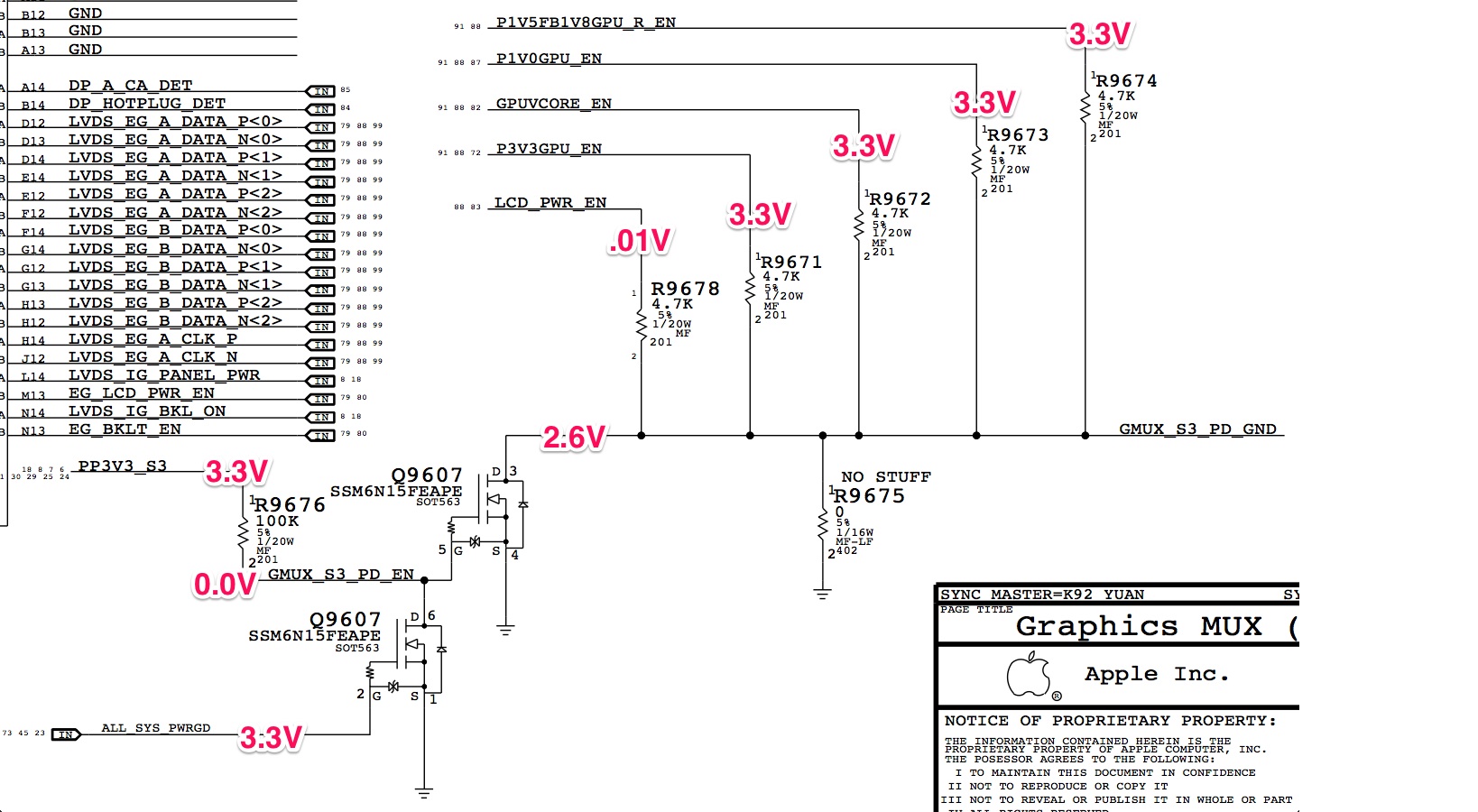

Thanks for your reply. I originally thought U9000 might be bad because of that .12V i was seeing on pin 1. I have the 3.3V on pins 2 and 3. When I removed U9000 pin 1 was still at .12V.
It looks like that U9000 pin one enable voltage originally comes from U9600 GMUX as an output from U9600 PB19B.
Where I am right now is trying to figure out what U9600 wants to see to turn on the LCD power enable voltage that ends up at U9000 pin 1.
As an overview, after replacing the LVDS connector, LVDS cable and backlight fuse there is no PP3V3_SW_LCD to the lcd.

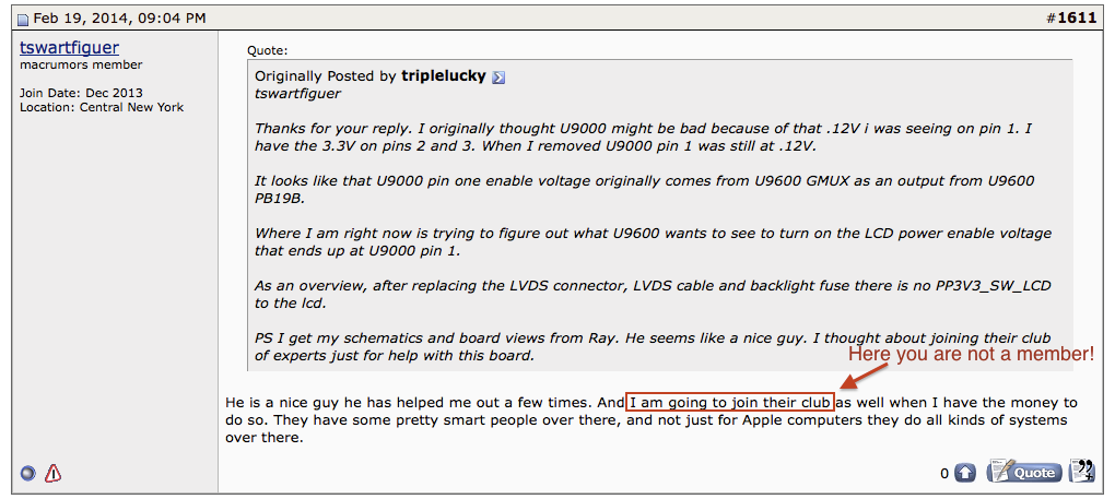

Im really confused. You are or not part of the group? 😕
LOL no I am not a member of that forum yet I will be but I have a group that is based in the UK I get these file from but the group I havent joined yet is way better and has more to offer. The guy that runs the forum will hook me up if I donate though so if you need something you can get ahold of him as well let me know. I didn't just want to go giving his info out to just anyone.
Why would you post that in the general forum why wouldn't you send me a private message?
The group I am trying to join only charges $3.99 instead of $10 so if you want that info PM me and I will give you his email address. In the future if you have a question like the PM me don't trey to make me out to be a liar or like I was trying to scam you or something I was trying to help man and still will thats what this forum is about rigfht?
Enough said!

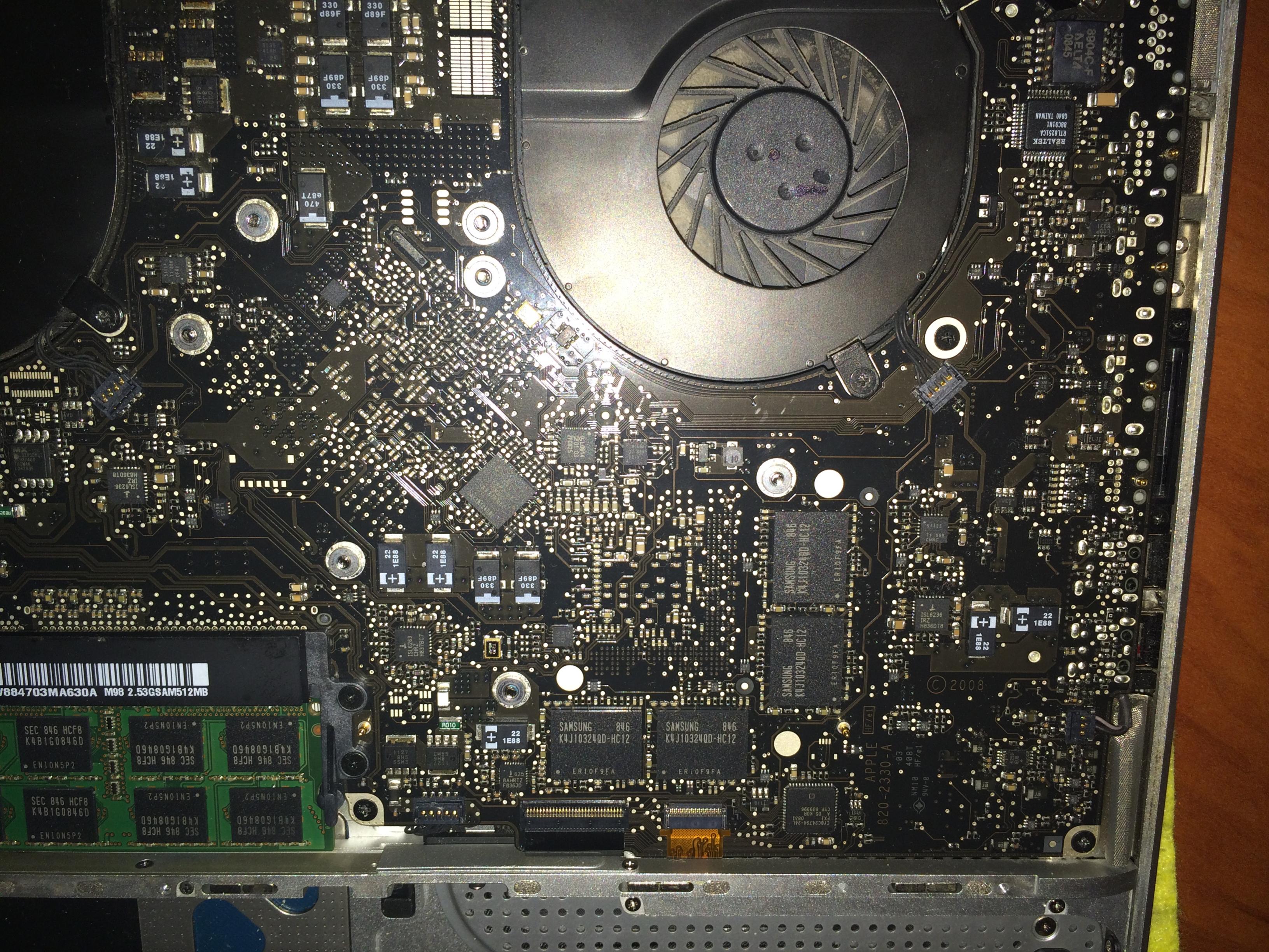

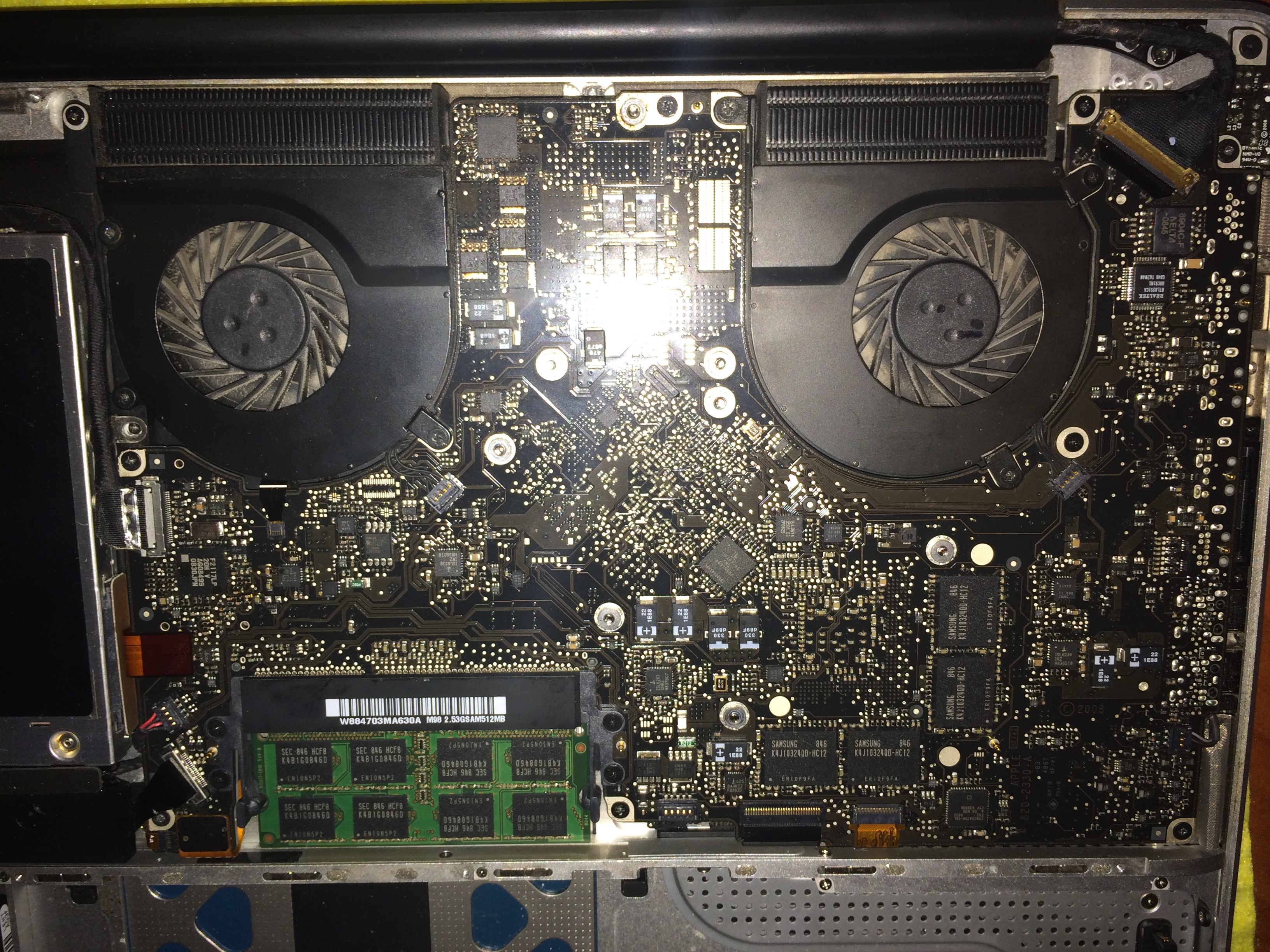

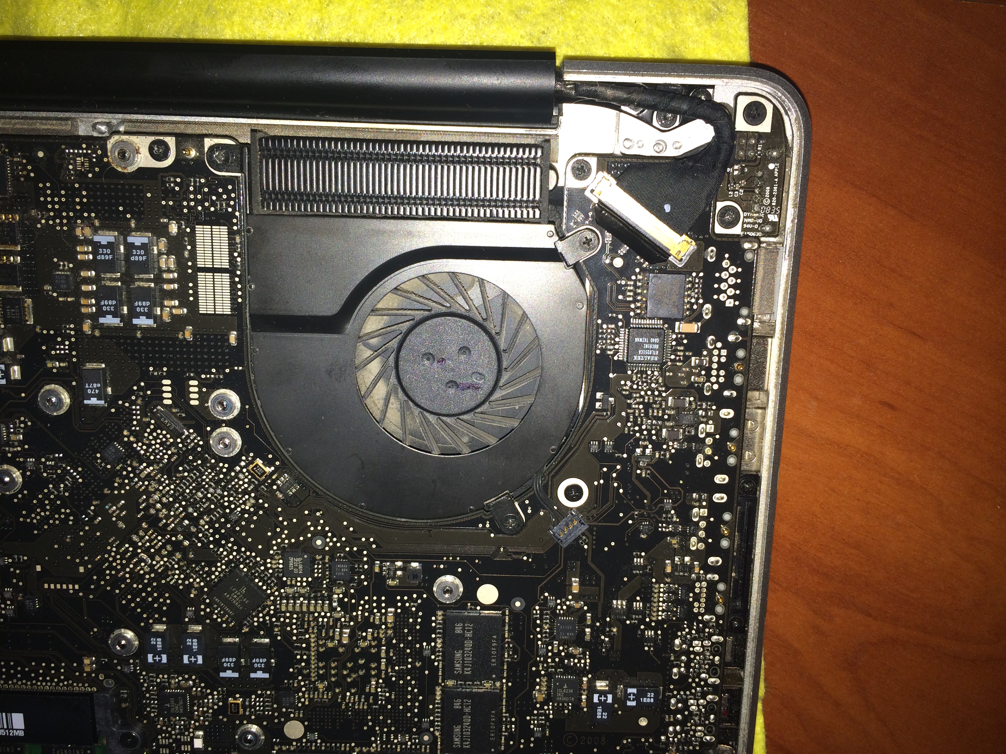

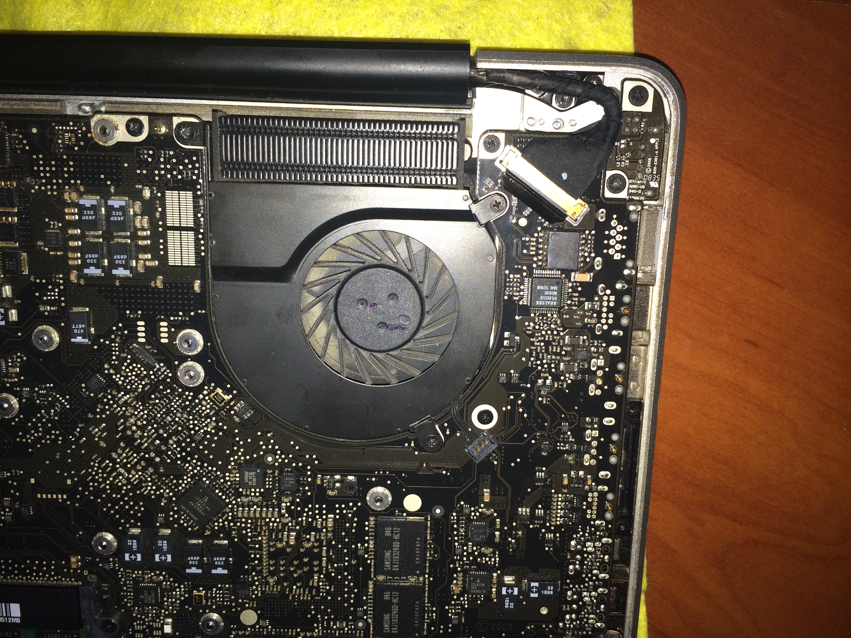

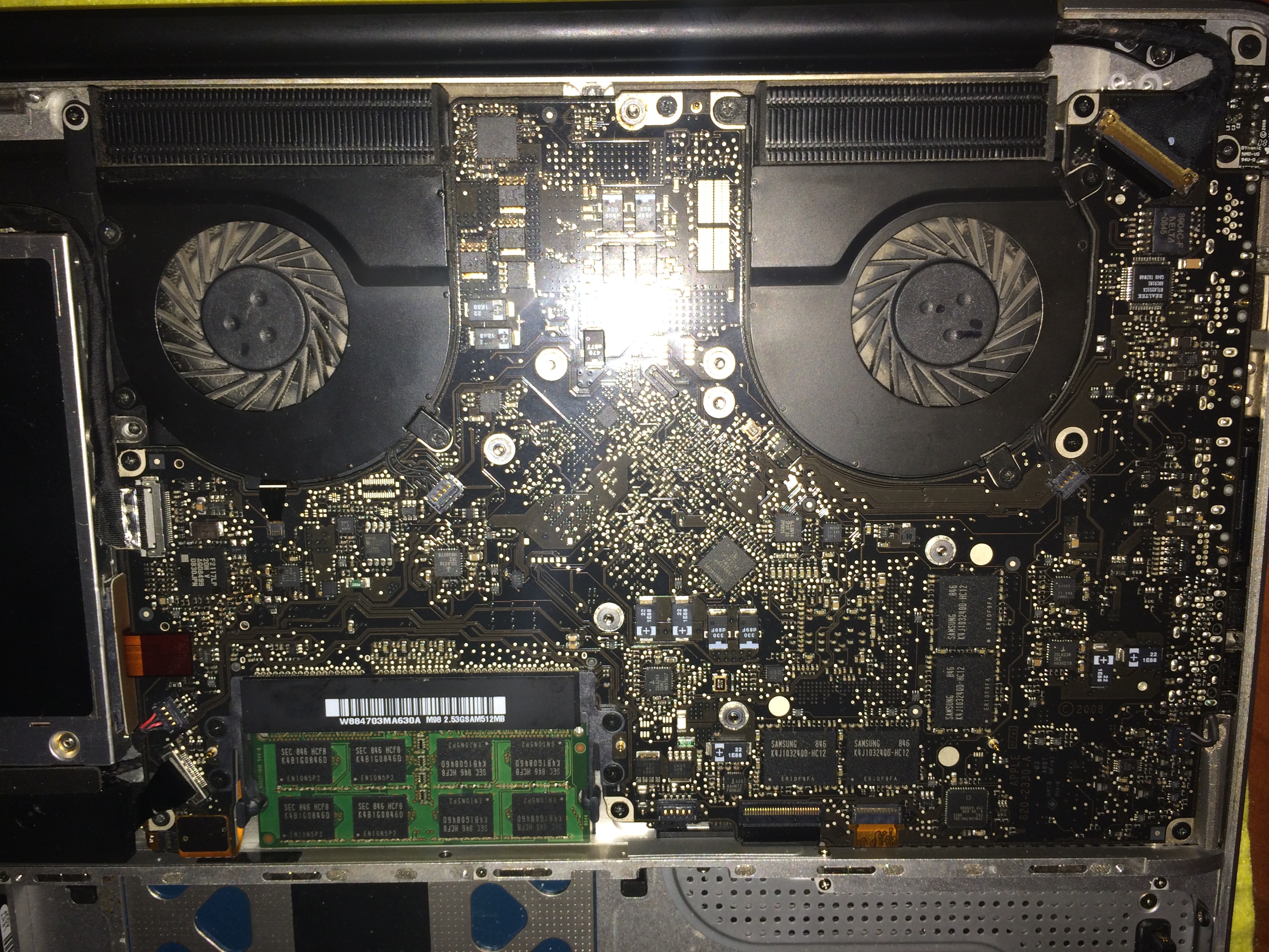

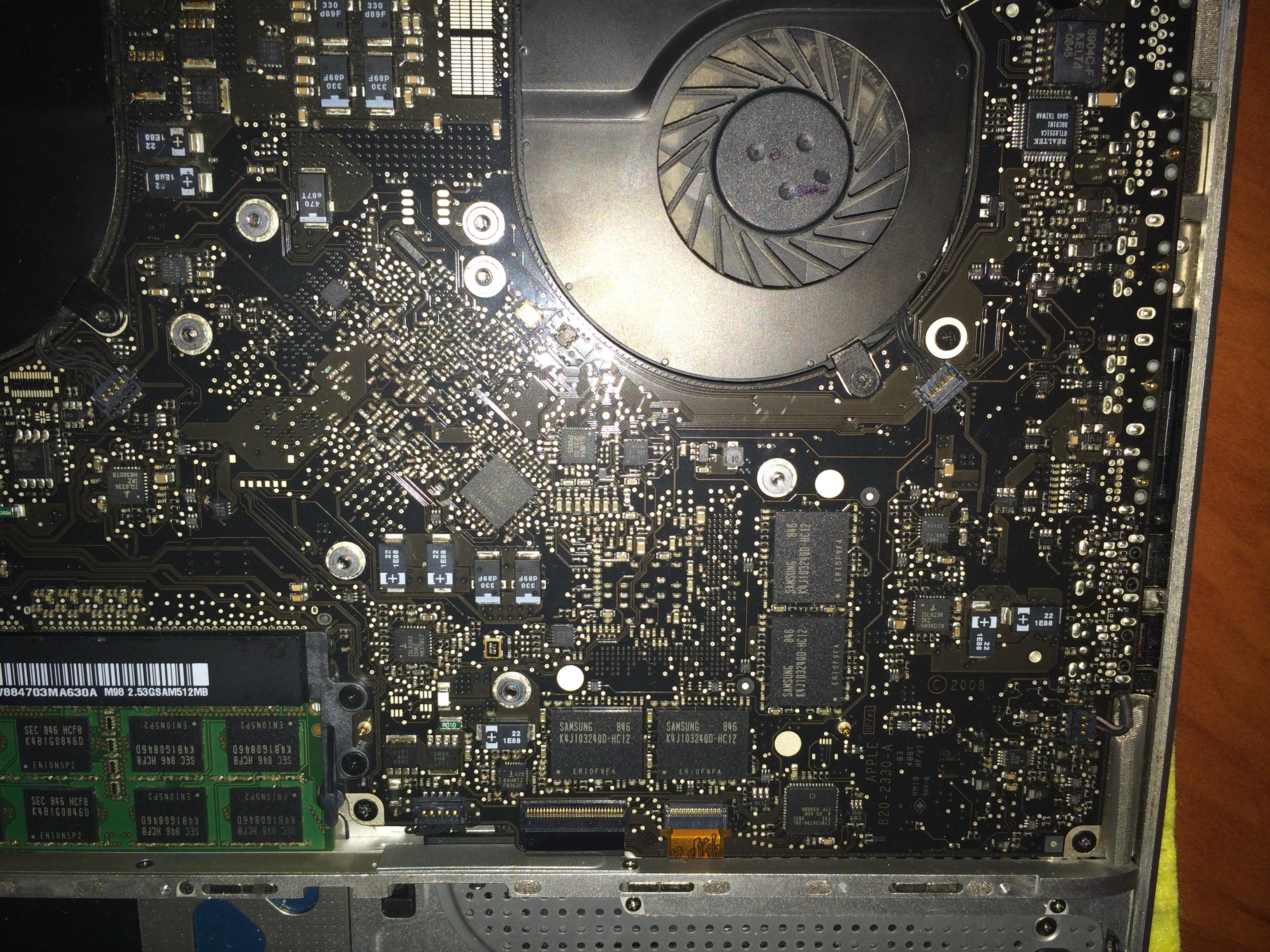

No LCD backlight on MacBook Pro 15 late 2008
Hello everybody!
I so much hope that you all can help me because I don't know what shall I do🙁
Here is my problem: I have bought used MacBook Pro 15 late 2008. It seems like that everything were OK. It worked fine
So when I come to home with macbook I decided to change thermal paste on the CPU and GPU
But I failed! I can not even unscrew the screws cause they was damaged (screws). Also I was not so gentle when I was unplugging some connectors. So when I assembled it back the backlight was not working
I decided that I have damaged LCD cable which connects LCD and MB. yesterday I have replaced it but the baclkight still don't work.
The display shows image just there is no backlight
I can work with external monitor via display-port and mac os works just fine
So what have I damaged? I read this thread and figured that it could be the LED driver LP8550, isn't it? Or what?
Need advice from you guys 😱
THANKS

I don’t have the schematic for that but the first thing I would do is to carefully check the integrity of the cable and also the connector for damage. Then I would locate and test the backlight fuse. Then go from there.
You won’t get the opportunity to make many mistakes in there and one bad move will reduce your macbook to hopeless rubble.
Has anyone tried to track the LCD enable signals for the IG circuits on the 2011 MBP?
It looks like U1800 might send LVDS_IG_PANEL_PWR over to U9600 GMUX and GMUX sends out LCD_PWR_EN that ends up at U9000 and on to PP3V3_SW_LCD.
Without PP3V3_SW_LCD I am wondering if SMC? can even “See” that the LCD display is connected.
Obviously still trying to understand this chain of events that end up enabling and sending video over to the LCD.
Any insights appreciated.
Well as I replaced LCD cable it seems like it is ok.... but I remember that I realy was not gentle when was pulling it out... may be I damaged the CONNECTOR which is placed on MB? How can I check it?

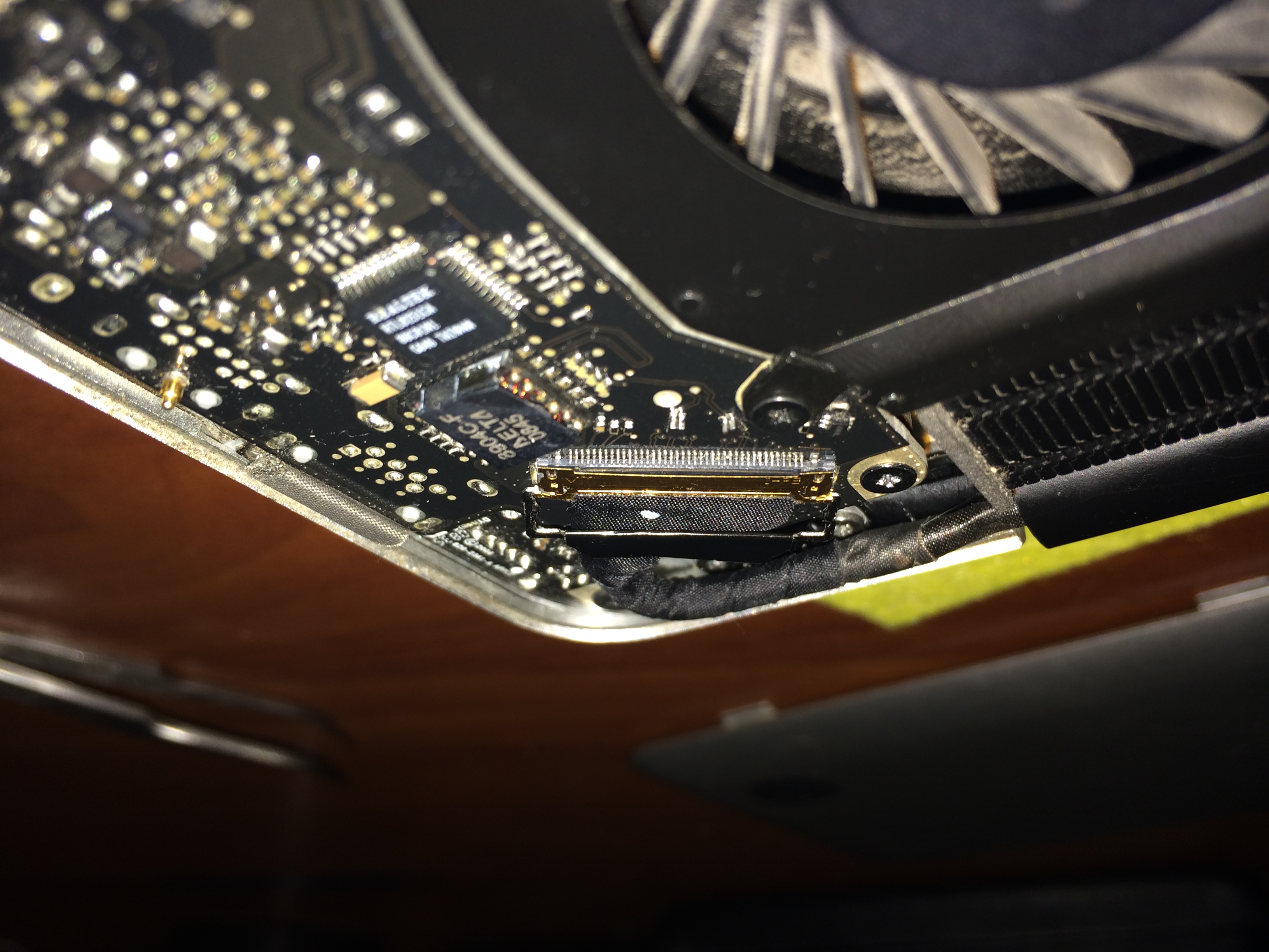

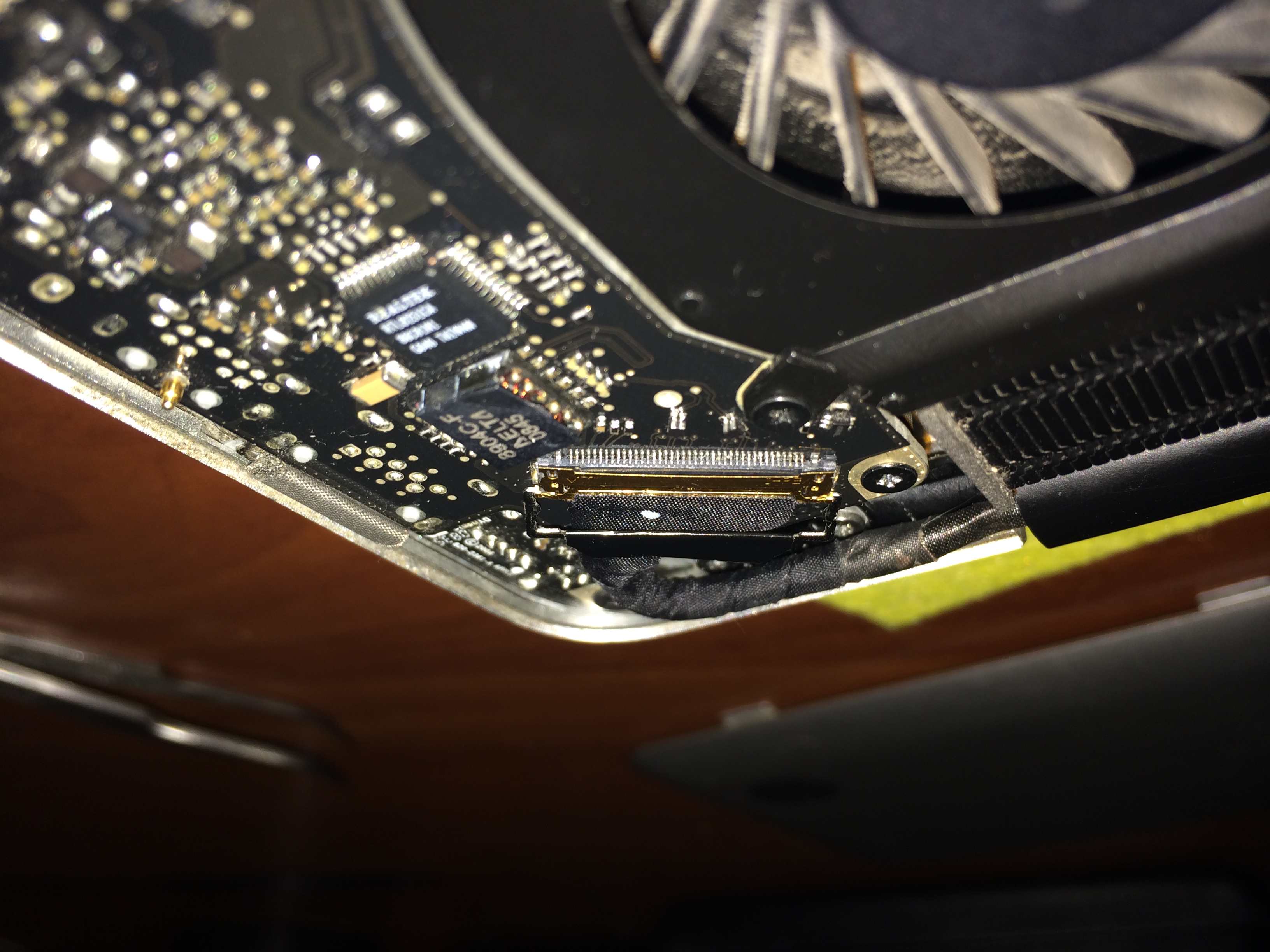

Ok I have searched for the “check backlight fuse” in this thread but haven't found any instruction for my model of MB
Also I have just checked the lcd connector with magnifying lens and it seems like it's fine. can check the photo
So I think the next step is to replace fuse?

Your connector doesn’t “look” too bad so maybe ok.
I don’t have a pix or location of the late 08 backlight fuse.
Possibly someone else does.
It will have a small dot or “p” on it.
If it is bad you will need pretty decent soldering skills to replace it.
