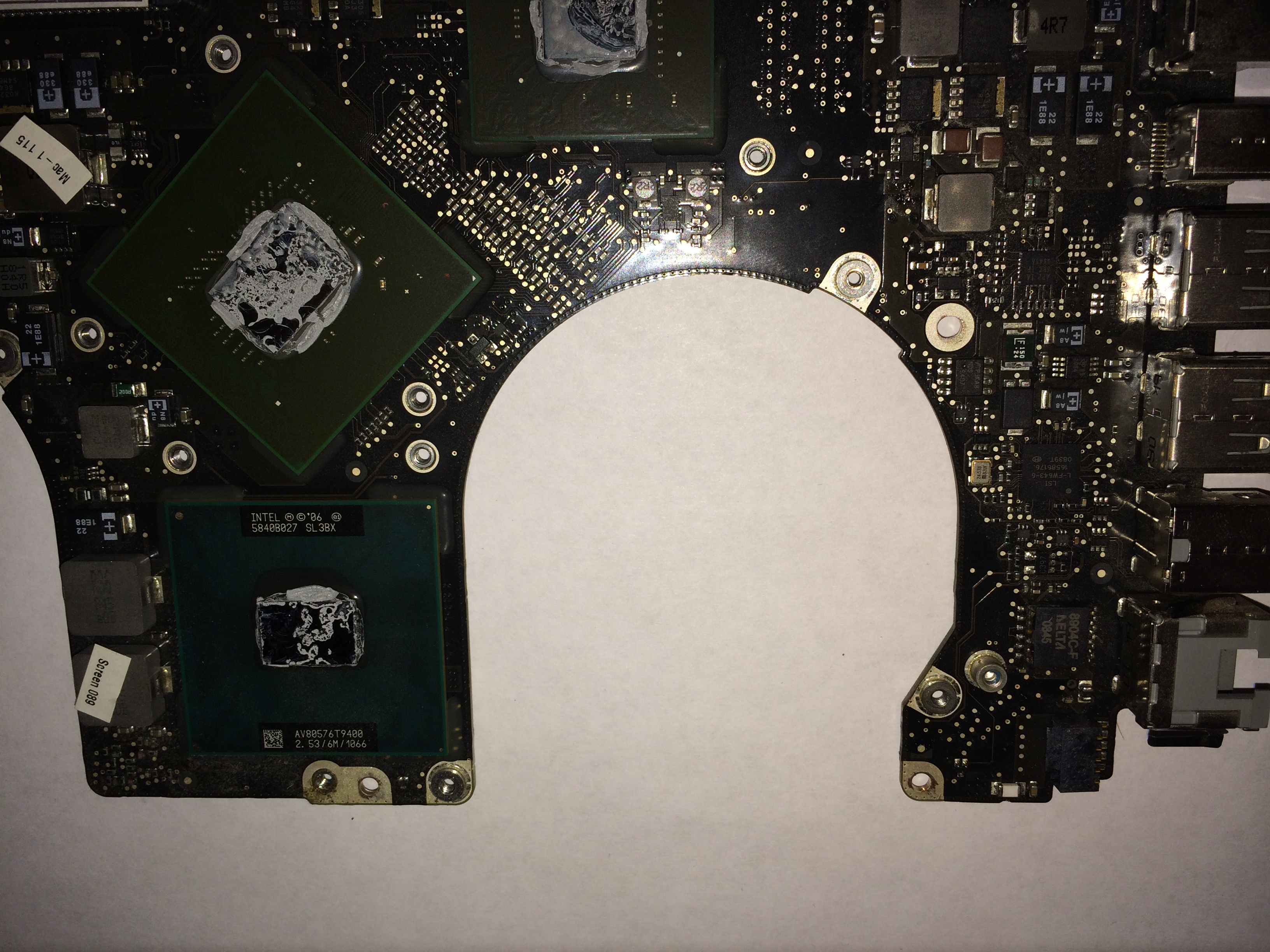

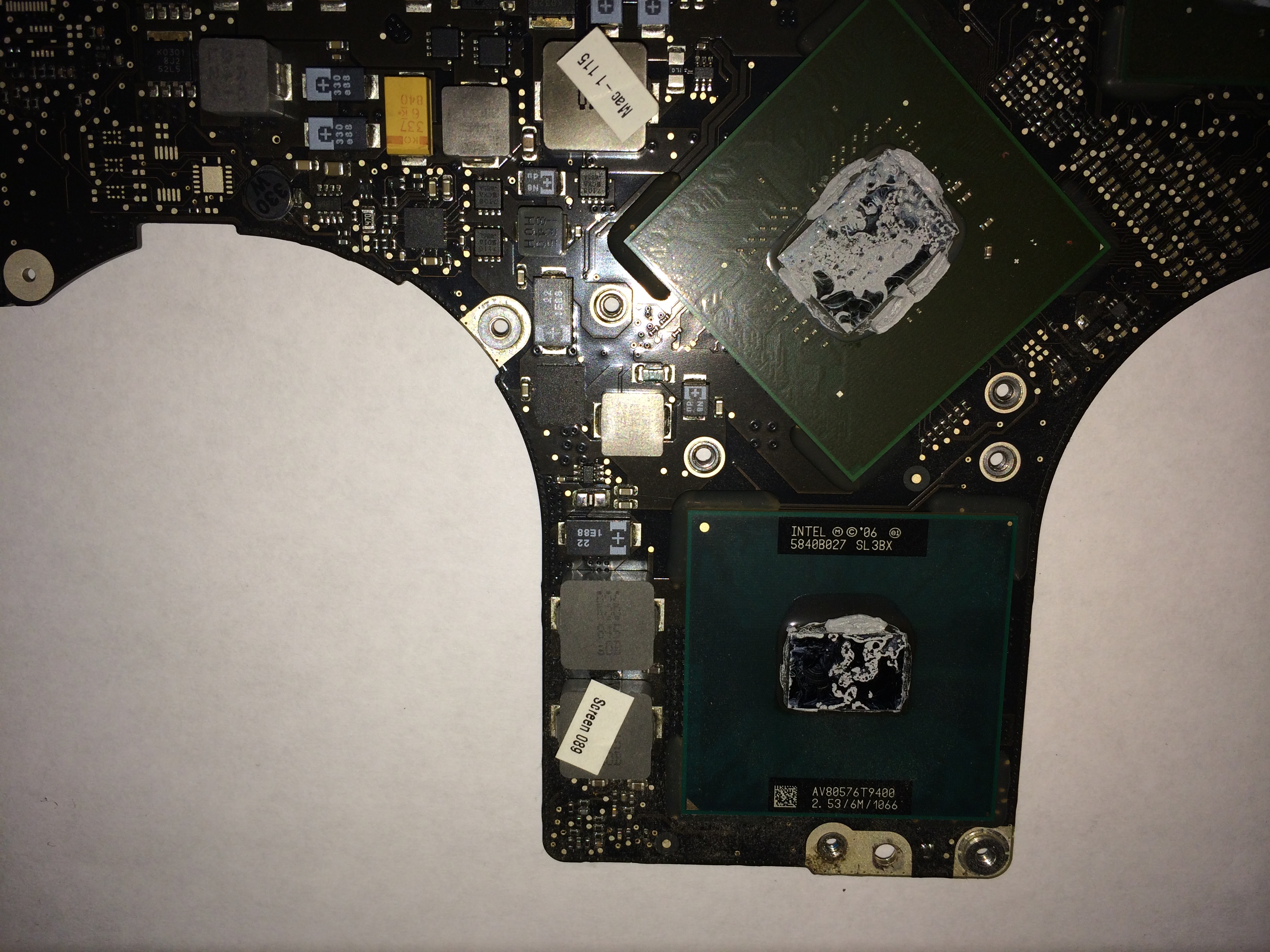

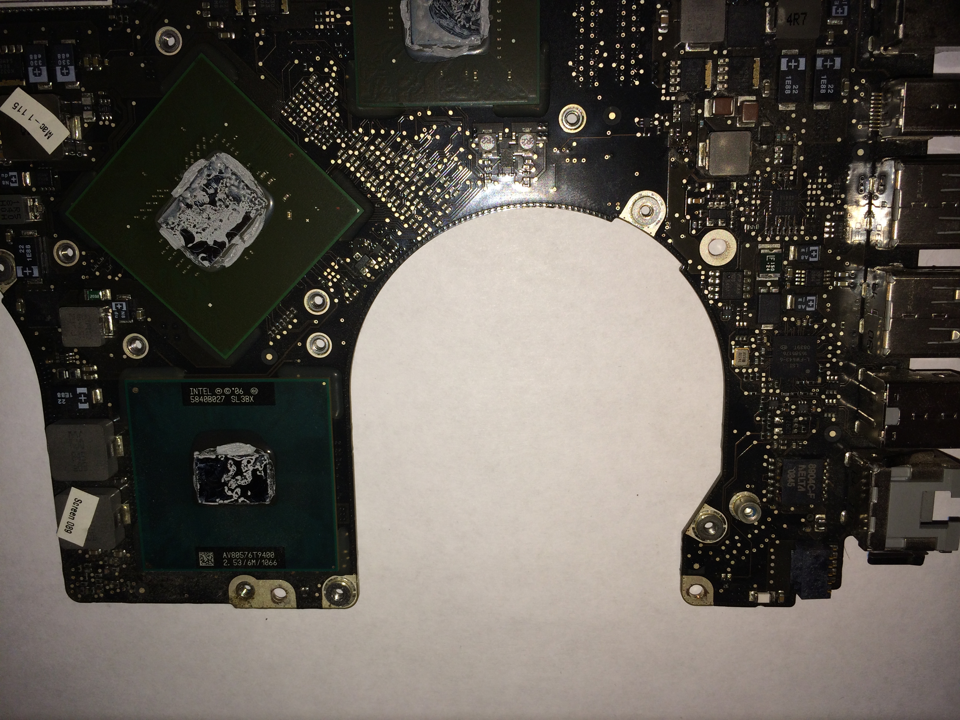

Here is my problem: I have bought used MacBook Pro 15 late 2008. It seems like that everything were OK. It worked fine
So when I come to home with macbook I decided to change thermal paste on the CPU and GPU
But I failed! I can not even unscrew the screws cause they was damaged (screws). Also I was not so gentle when I was unplugging some connectors. So when I assembled it back the backlight was not working
I decided that I have damaged LCD cable which connects LCD and MB. yesterday I have replaced it but the baclkight still don't work.
The display shows image just there is no backlight
I can work with external monitor via display-port and mac os works just fine
So what have I damaged? I read this thread and figured that it could be the LED driver LP8550, isn't it? Or what?
Need advice from you guys 😱
THANKS
and here are some pictures of MB
I believe the fuse is on the other side of the logic board. Remove the board and post high res pics of the backside near where the LVDS connector is. Then we can find the fuse for you.
oh no! the backside 🙁 the problem is that the screws are completely damaged by the previous owner. and I don't know how to remove them... will try today

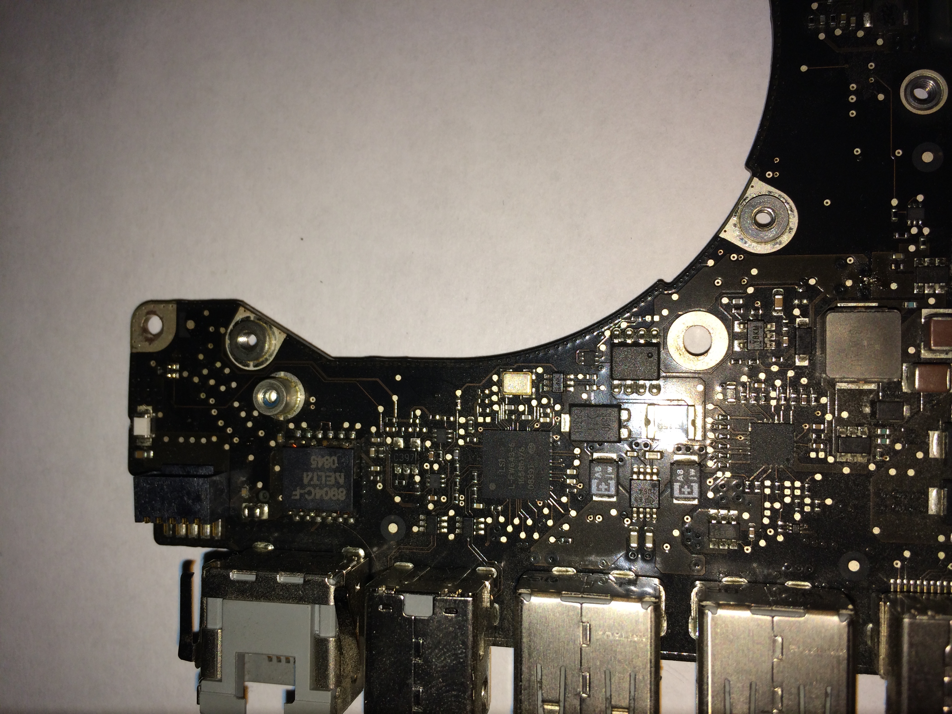

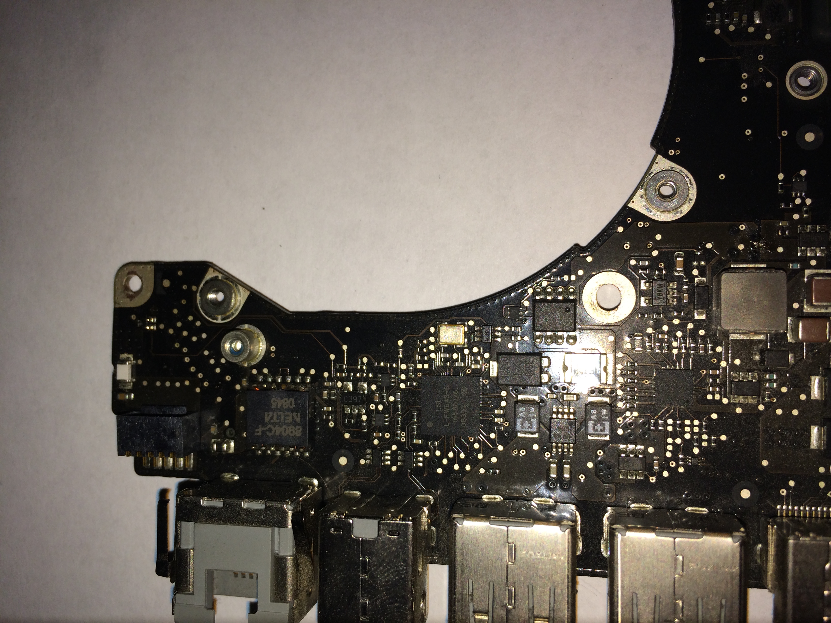

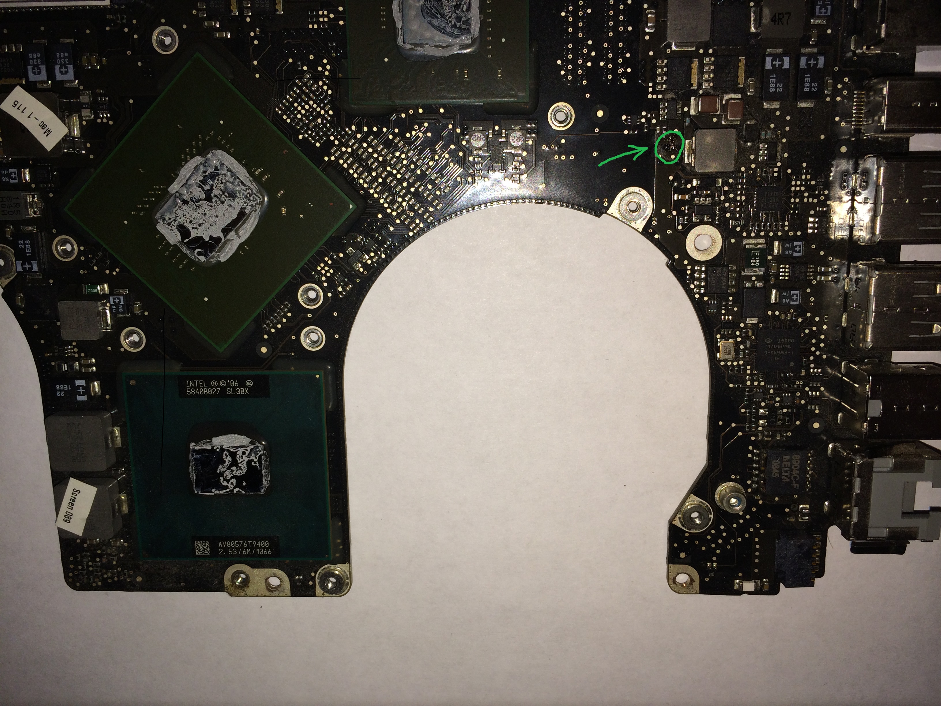

dear friends
please help me to find out the fuse for the LCD backlight on macbook pro 2008 15 late 2008 unibody
here is the backside of MB
If you short the contacts you risk further damage to the board.
A fuse is there to limit the current from getting too high and frying something.
Barney
Ok. Can you show me a picture how should I install the fuse?🙂
or the photo of correct fuse?

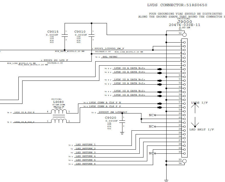

I have just repaired a backlight fault on MacBook Pro A1278 2010 model. Problem is only the backlight is now working but no display. Works fine on external monitor via thunderbolt. LVDS connector looks good and have tested with another screen. Any idea what could be wrong? Anyone have a circuit diagram for the signal display for this model?

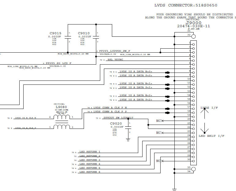

Does anyone have pinout for LVDS on A1278 2010 please? Any ideas what fault could be preventing display signals?
Here you go.
If you are getting backlight but no image then I suspect something in the LVDS signaling or clocks. If the 3.3V supply (pins 2 and 3) is bad then normally the backlight will not come on at all. I believe there is some sort of feedback that is required for the SMC to enable the backlight. Anyway you could check for presence of 3.3V on pins 2 and 3. Be very careful probing with power on. One little slip and short circuits can happen.
